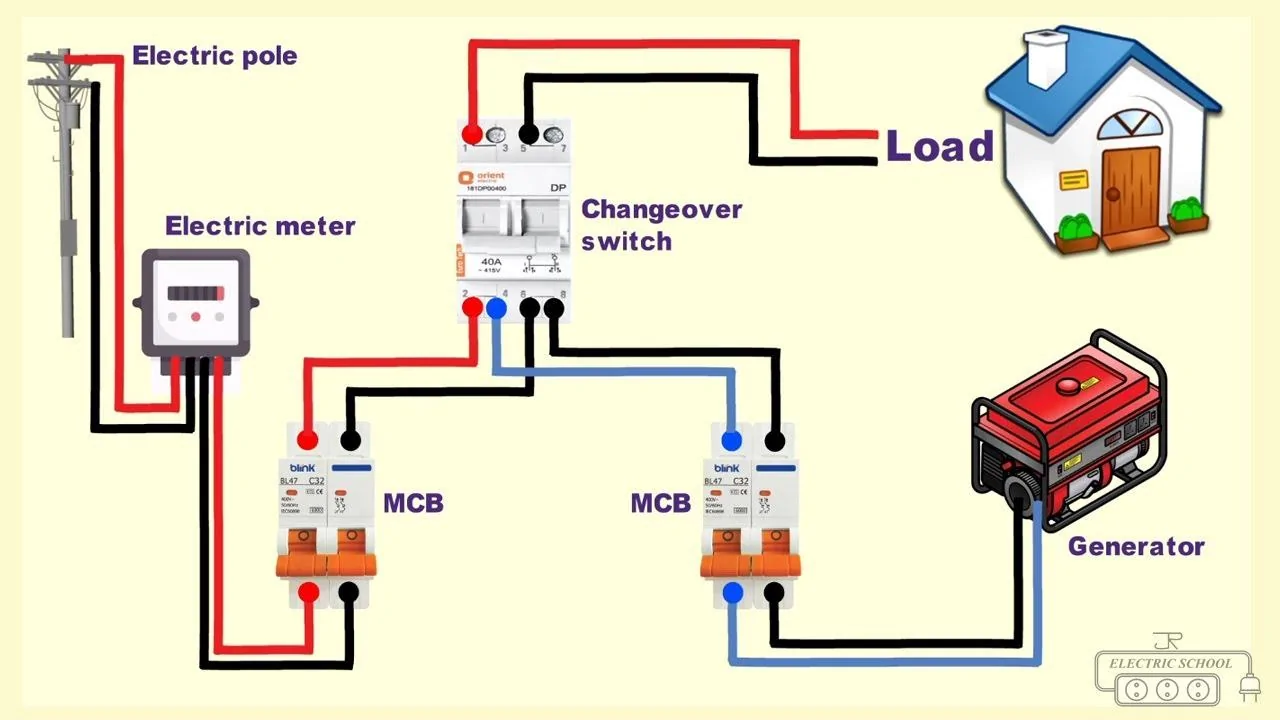

V2H house is fairly simple if you want it to be. The simplest version would be to install a manual generator changeover switch on your main switch board. Switch can be had for under $100. Automatic switches are also available. You just use the Lightning 120/240V outlets instead of a generator.

The reason why Ford etc charge more is that they offer a whole series of integration options that aren't included in the switch like power line detection and automatic switchover, load and charge status etc. But you don't need all of them to operate the Lightning as a house backup generator.
It’s pretty simple, but unfortunately not *quite* so simple - or cheap.
Namely, since Ford designed the 30A/220 plug with power tools in mind, it has a bonded neutral which if directly feeding a house creates a ground loop. The work-around involves special transfer switches with a floating neutral (for those of us uncomfortable with a dead man’s cable or other such non-code work-arounds).
A few other gymnastics are raised depending on the home’s existing wiring, etc., but for the most part, yes, a genny plug is what I plan to use instead as a poor-man’s “HIS”

Ground loop is an issue if there is a circuit that can detect and trip because of it, but otherwise a changeover switch that switches all the circuits should still work. The main thing is not to have any circuit connected to the Lightning and the grid at the same time. That's both dangerous and costly, because the lightning would be producing current out of phase with the grid as it is unsynchronized.
I don't have that problem because I am intentionally off grid and have been for years (decades?).
the truck is what “trips.” Nothin’ doin’ apparently
Admittedly I’m not an electrician, and not super agile with the details - but another forum has pages of threads on this, and consensus (of electricians) who have done it to both failure and success seems to be it’s not so straightforward
in any event, those kinks ironed out, a genny outlet is what most are doing to power their homes with the Lightning
