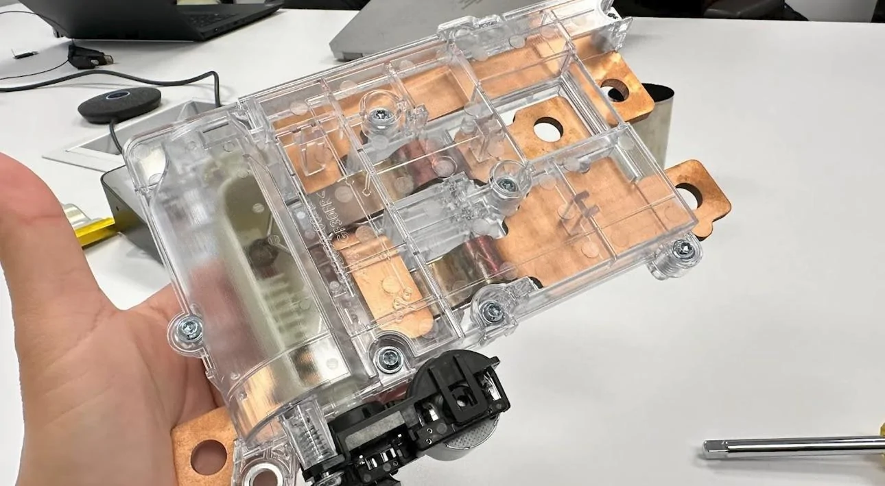

The Cybertruck battery is 4 x 200V units in series. A switch inside allows switching between parallel and series to optimally charge at 400V and 800V
Tesla Cybertruck Cybertruck battery is 4 x 200V units in series. Switch inside allows switching between parallel and series to optimally charge at 400V and 800V 9pkaf9tzyp3c1
Source: 31 minutes into this video

That is freaking awesome and exactly the right way to design the pack. The Lucid uses a converter when the charger cannot provide 900V, which results in a very slow (like 60 kWh or less) charge speed on 400V chargers.

Isn’t the parallel, series switch how GM is doing it with hummer and Silverado? What is different/new here?
126
15,902
26,567
Yeah, I thought Rivian had that patent.
Anyhow, it's kind of the way to go. Just like taking AA batteries out and swapping them into the charger. Charger charges at one voltage, your toy operates at its voltage.
Yes, but if I remember correctly, they use a bunch of stand alone contactors to make it happen, more expensive and bulkier, Tesla designed a single tiny switch that integrates all that
