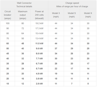

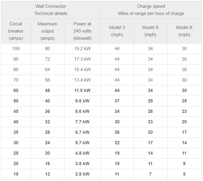

I found a revised chart that rates the Model 3 charge rate at 19 miles for 4800Watts. So the Cybertruck at 15 miles per 4800 Watts would be closer to the Model S at 14 miles per 4800 Watts. This also jives with 4800/15 = 320 Wh which is about the rate per mile for the Model S. I’m fairly confident now that the Cybertruck will be similar in Wh per mile/weight/range/battery size to the model S.
So for the Cybertruck that would be 75kWh for 250 miles, 90kWh for 300 miles, and 150-160kWh for 500 miles.
