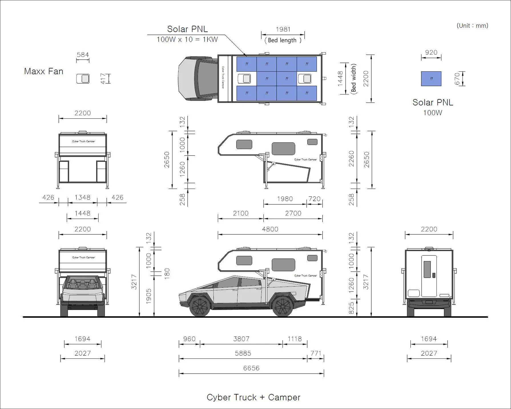

I like this camper plan, but I'm concerned about the portion of the camper over the tailgate. You may not be able to use a supercharger with this configuration -which would be really important on roadtrips. If you have ever used a typical supercharger station, the pedestal is at the middle of and the back of the parking stall. I think the tailgate needs to be up and locked, and the camper extending out over the closed tailgate. Even then, you need to measure the hight of the supercharger pedestal to make sure the overhang is over top of it. Yes there are side access superchargers, usually 1 or 2 at a station, but my experience is they are usually the first to get occupied & you'd likely need to access the centre back of stall pedestal ones more frequently. I've backed my Model S with a hitch mounted rear bike rack into one of these several times, and it's tough to get the cable to reach the plug port. I've had to remove the whole thing just to charge on an occassion or two, which is a pain in the butt.
I'm also wondering how one would tie down such a camper. Would the L-Track or T-Slot be strong enough to hold it down, or would you need a traditional tie-down?

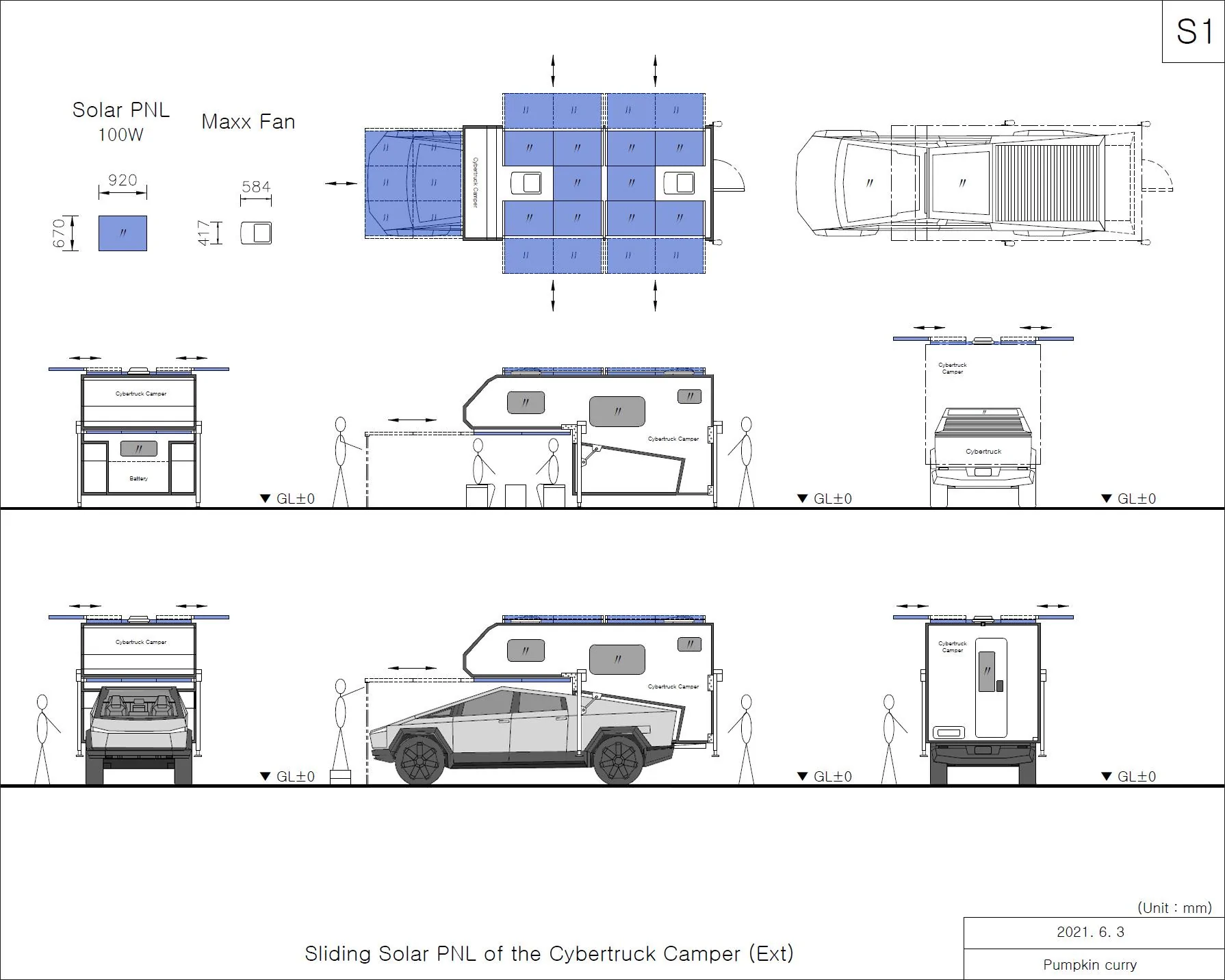

It is a cybertruck camper with an expandable sliding solar panel.
When moving, the capacity of the solar panel is 1,000W, When parking, is 2,400W.

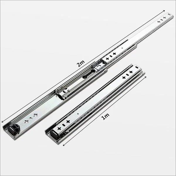

The way to expand is a sliding rail.
▲ Moving condition
▲ Parking condition
▲ Sliding rail

This design will more than halve your CT range which sort of defeats the purpose of expanding solar. Better off towing a popup I'm afraid. Even more so for anything offroad.
The trick to good efficient packaging is to remove all of the useless air volume when traveling, and only add it back when parked.
