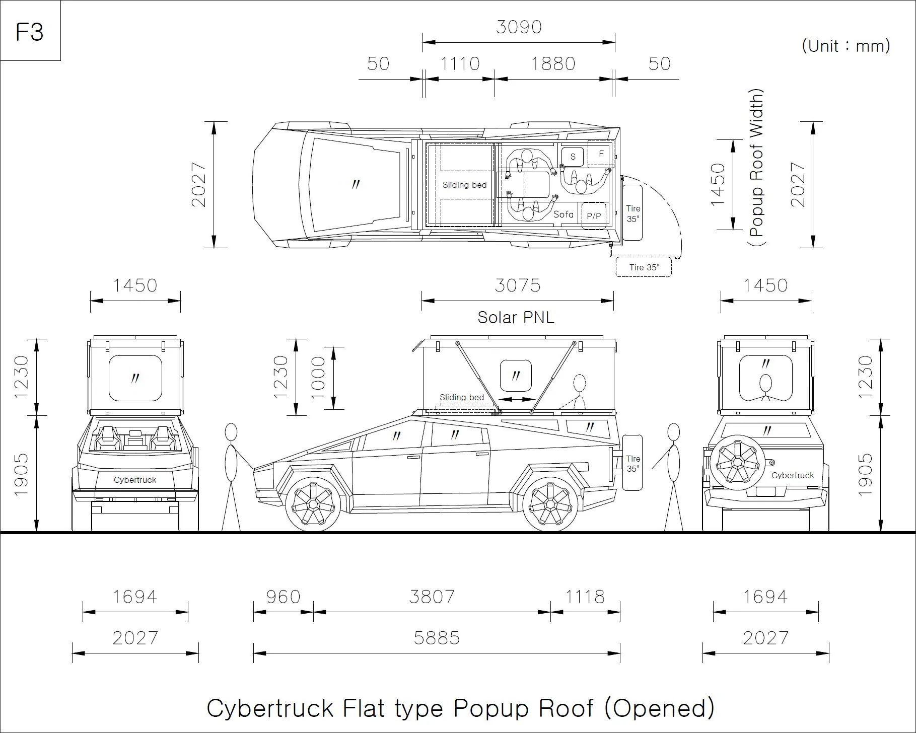

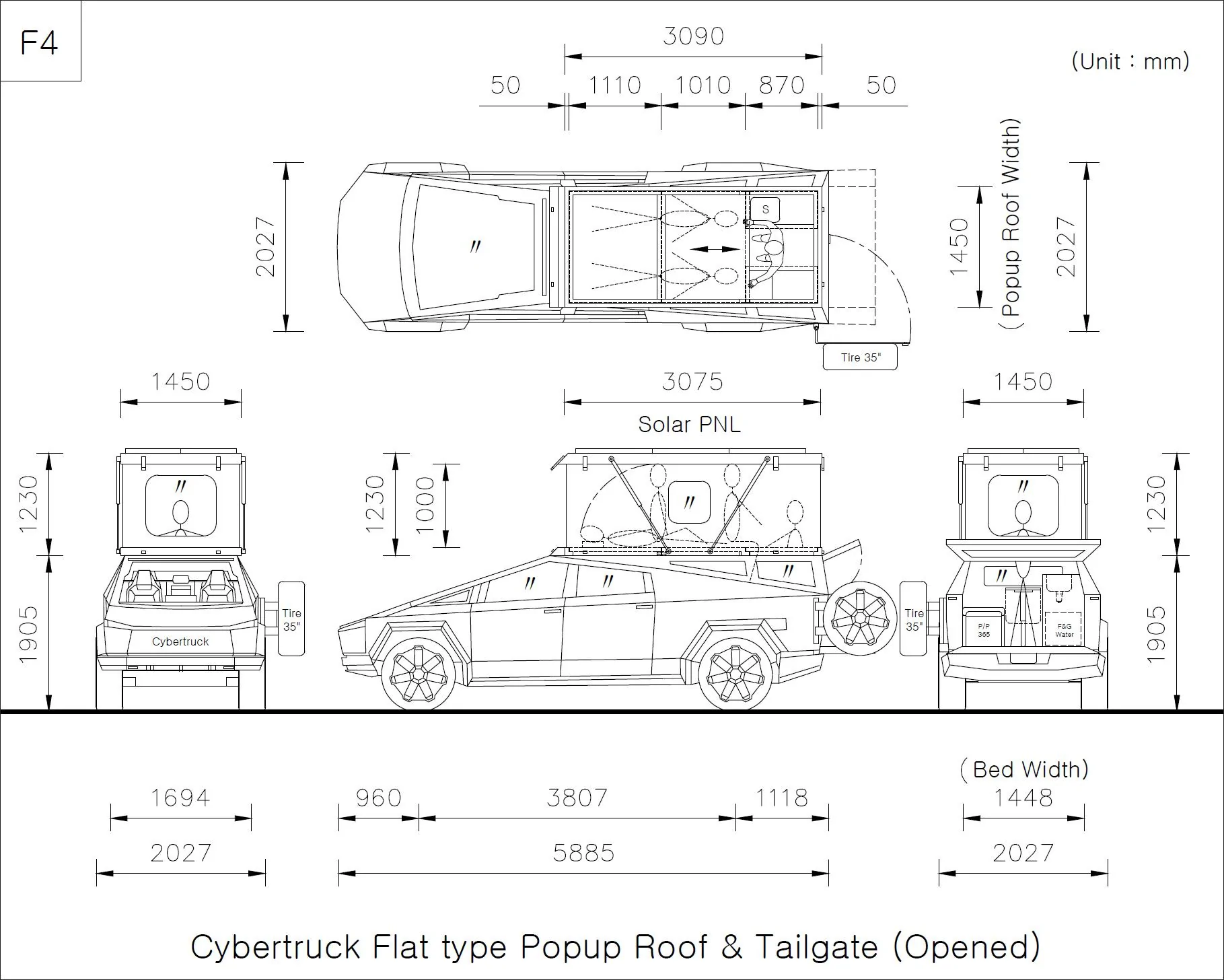

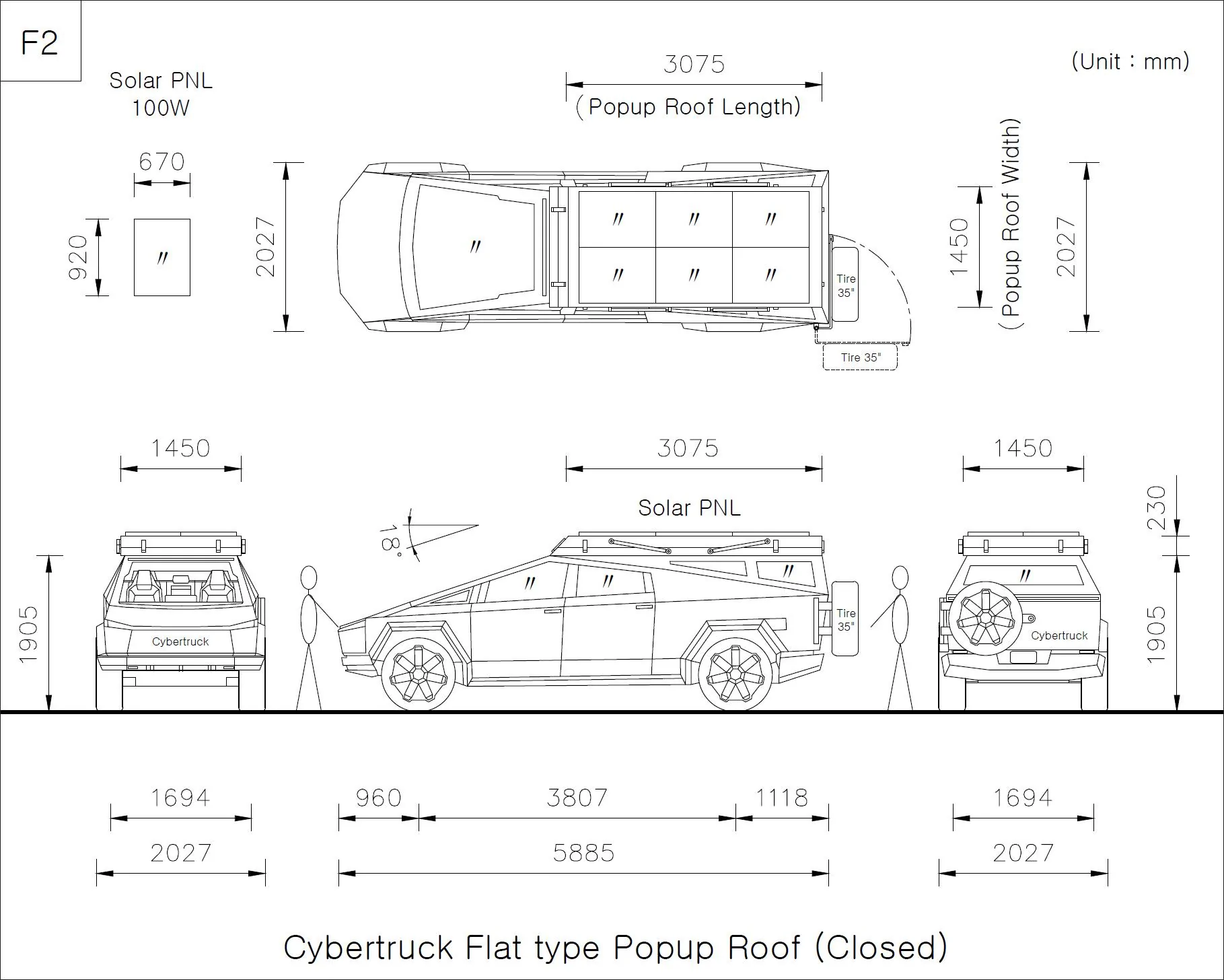

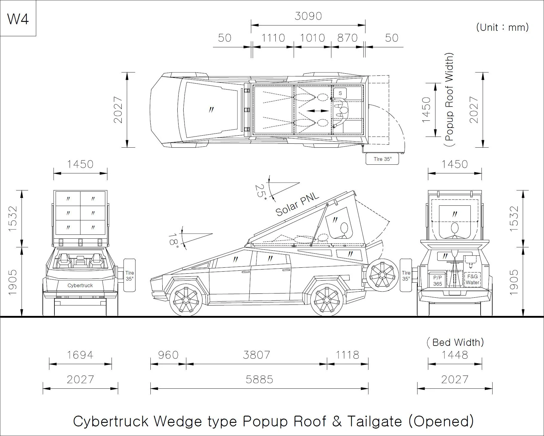

@PumpkinCurry - Outstanding designs. These are the most practical CT Campers I've seen yet.Install a spare tire on the tailgate of the pop-up roof cyber truck camper.
Tire dimensions are dia 35 x wide 12.5"(889 x 317.5mm).
The tailgate can be opened after turning the spare tire holder 90 degrees.

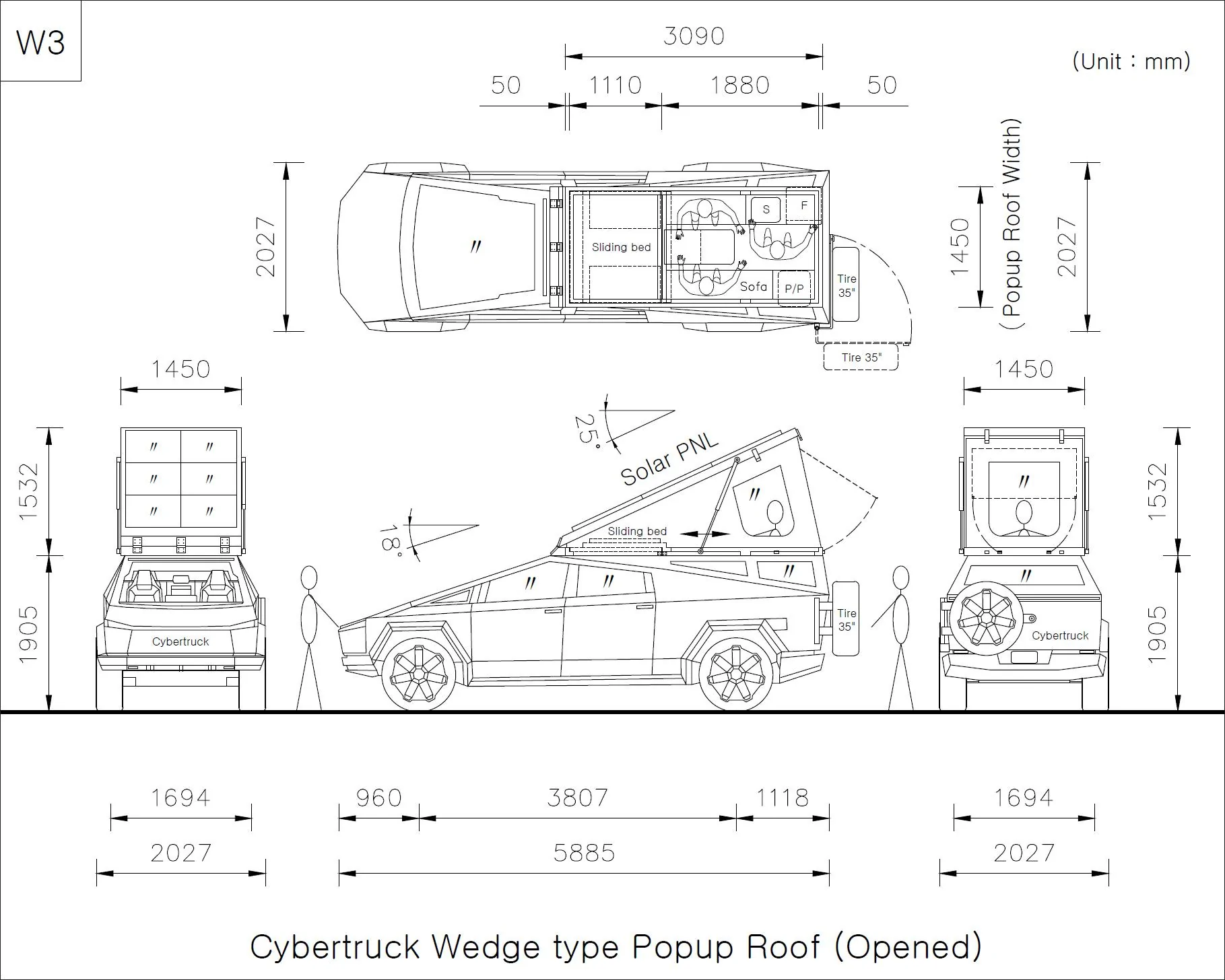

There are two types of pop-up roof (horizontal and inclined type).
