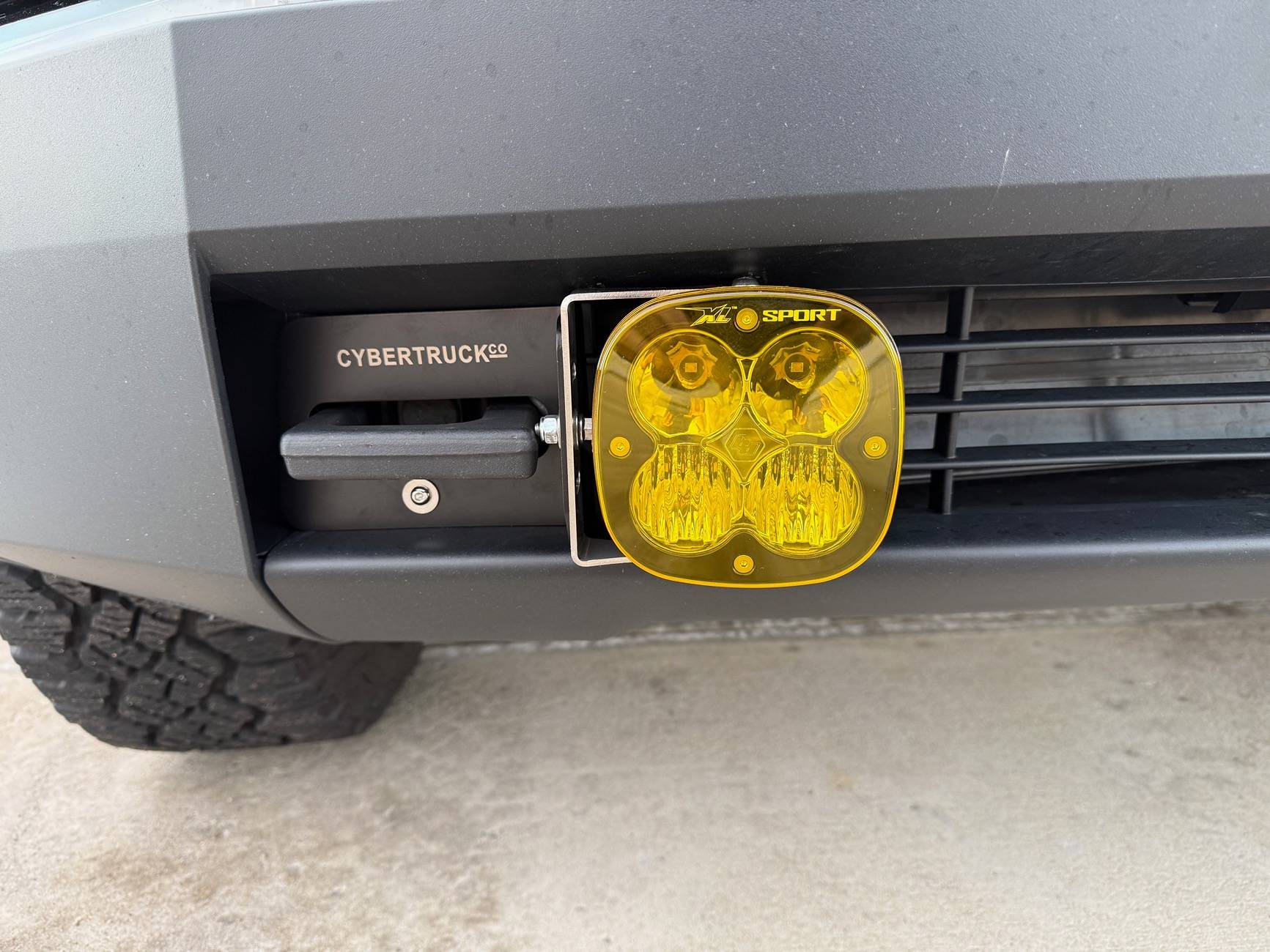

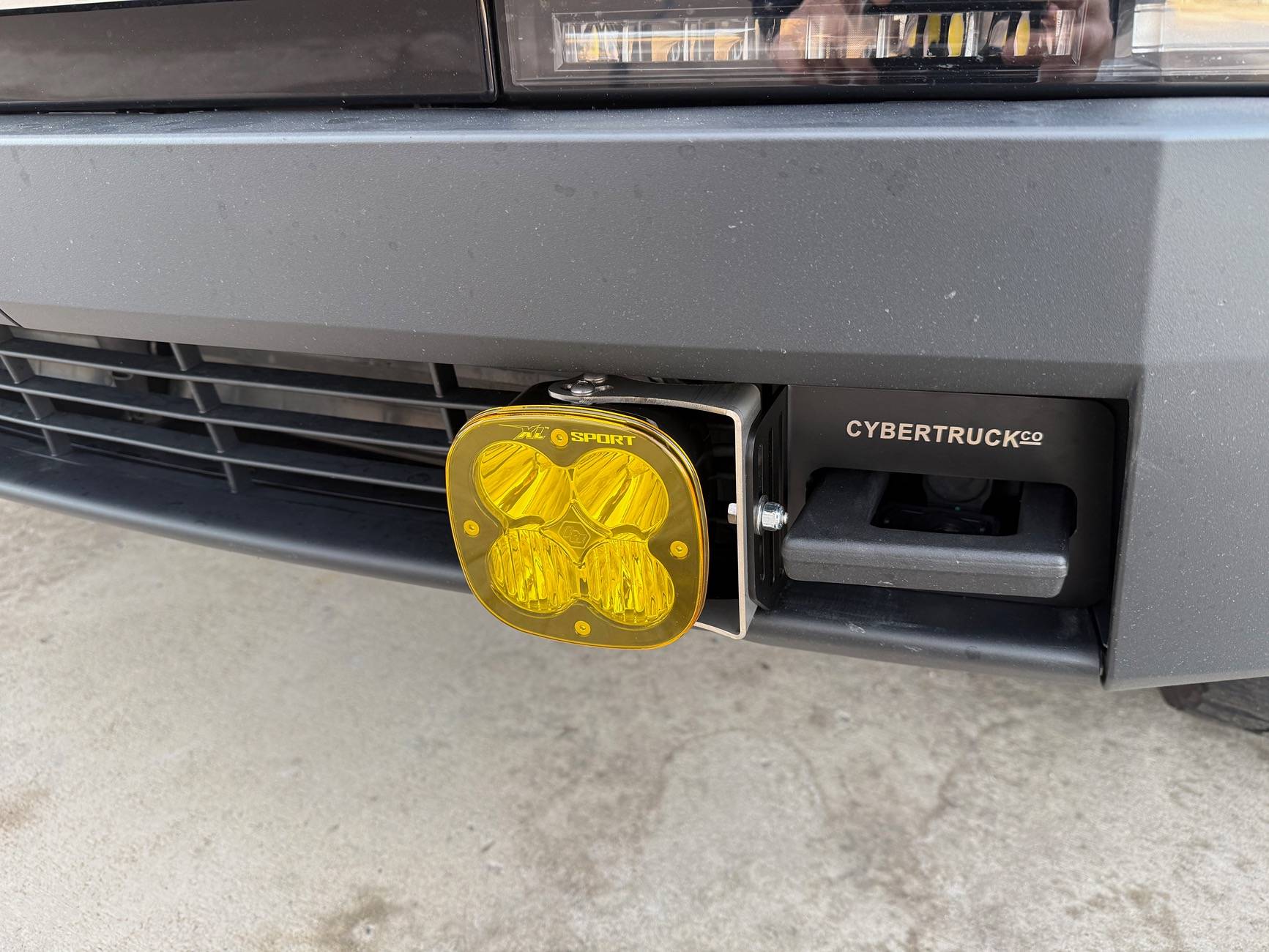

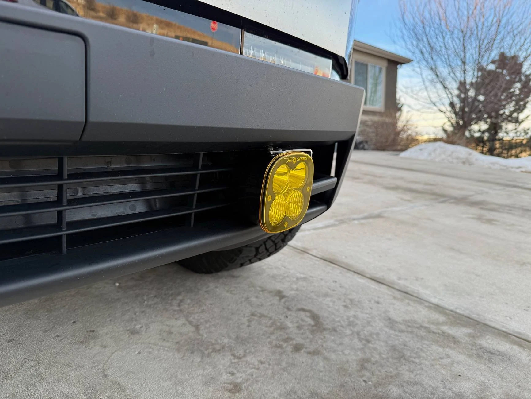

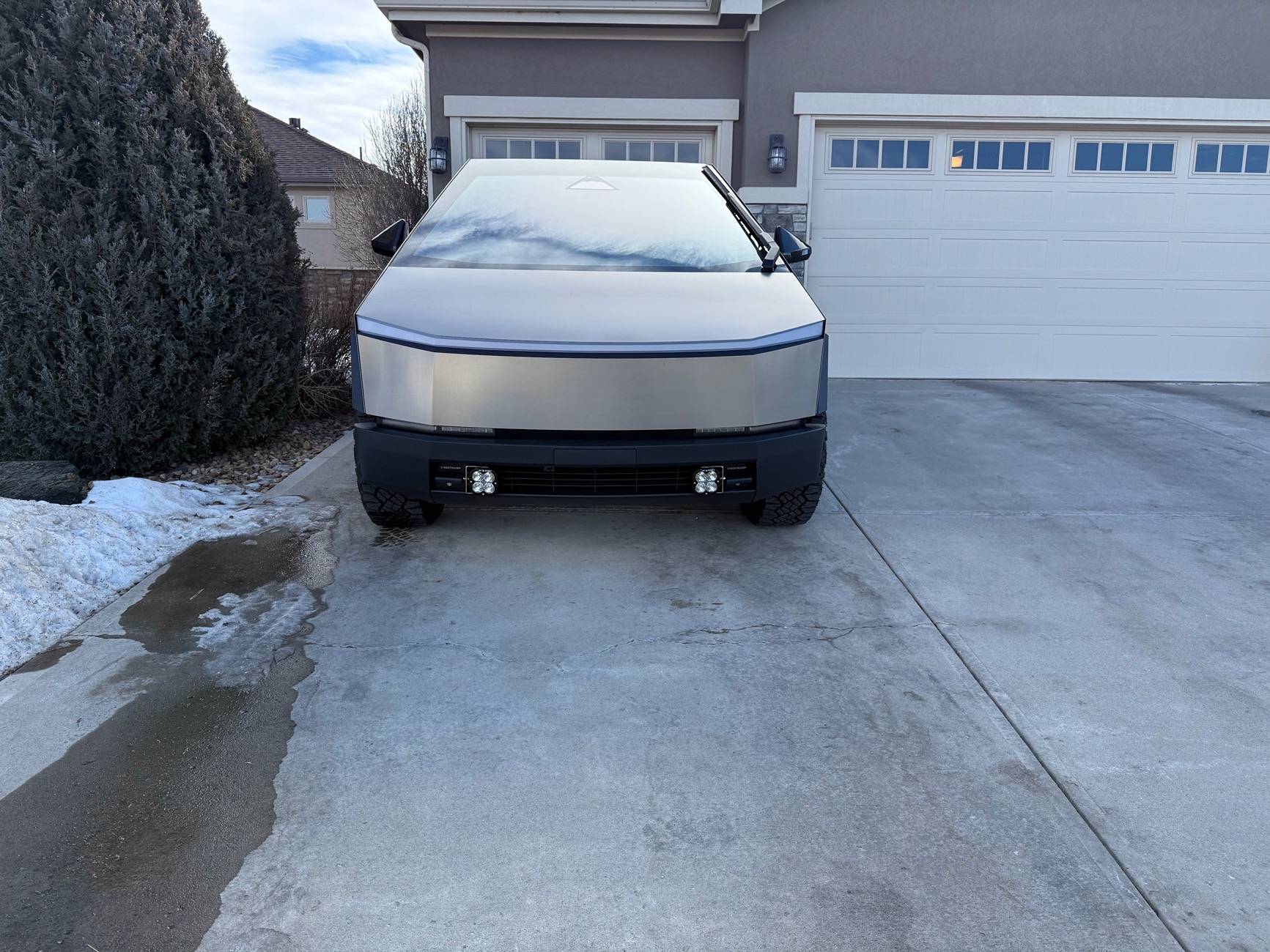

Finally warm enough to spend 2 hours outside doing the install. Kit's solid, wires a bit longer than I would have liked them but no big deal! One side of the Tesla was different alignment than the other around tow hook area so pain in ass to get the bracket installed (it's always something).
I think they look good, also come with yellow covers (why I bought them, snow visibility), and black rock covers, work with Frunk Power Feed Switch, wont hurt offroad visibility, makes the truck look diff than all the others,, etc....

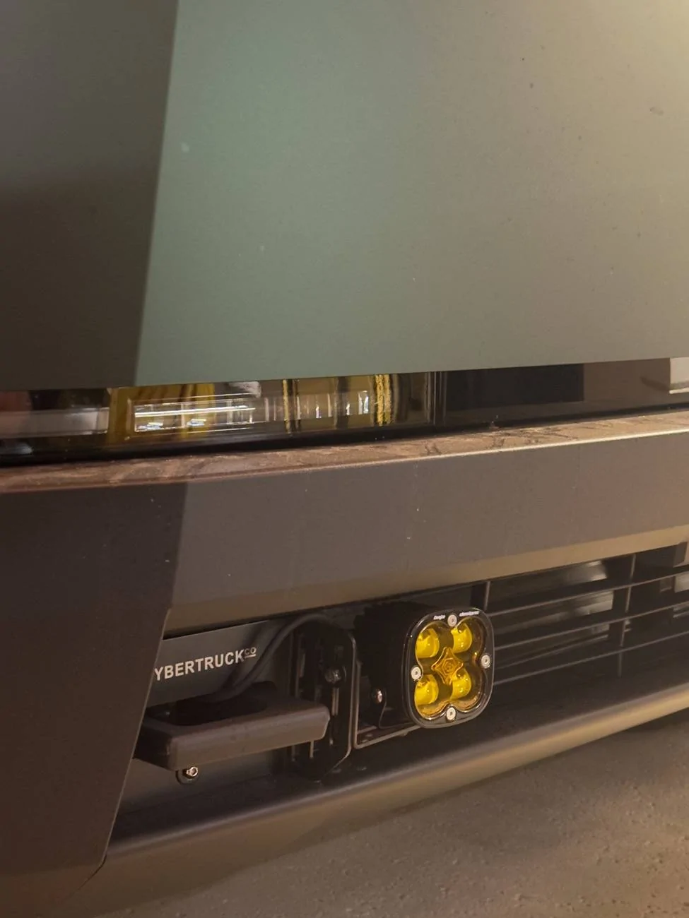

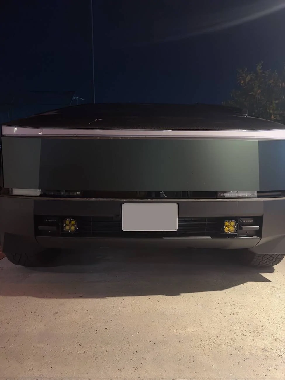

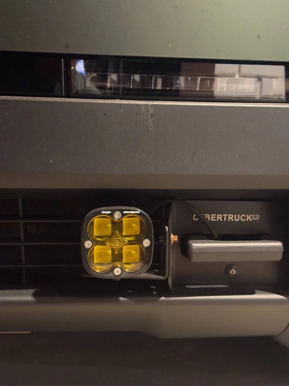

Awesome! I also used their system, but used some custom brackets to mount my fog lights horizontally since the beam pattern only works at that position.
And yes, getting the drivers side bracket installed was a massive pain due to alignment issues! Nice kit though and good customer service.

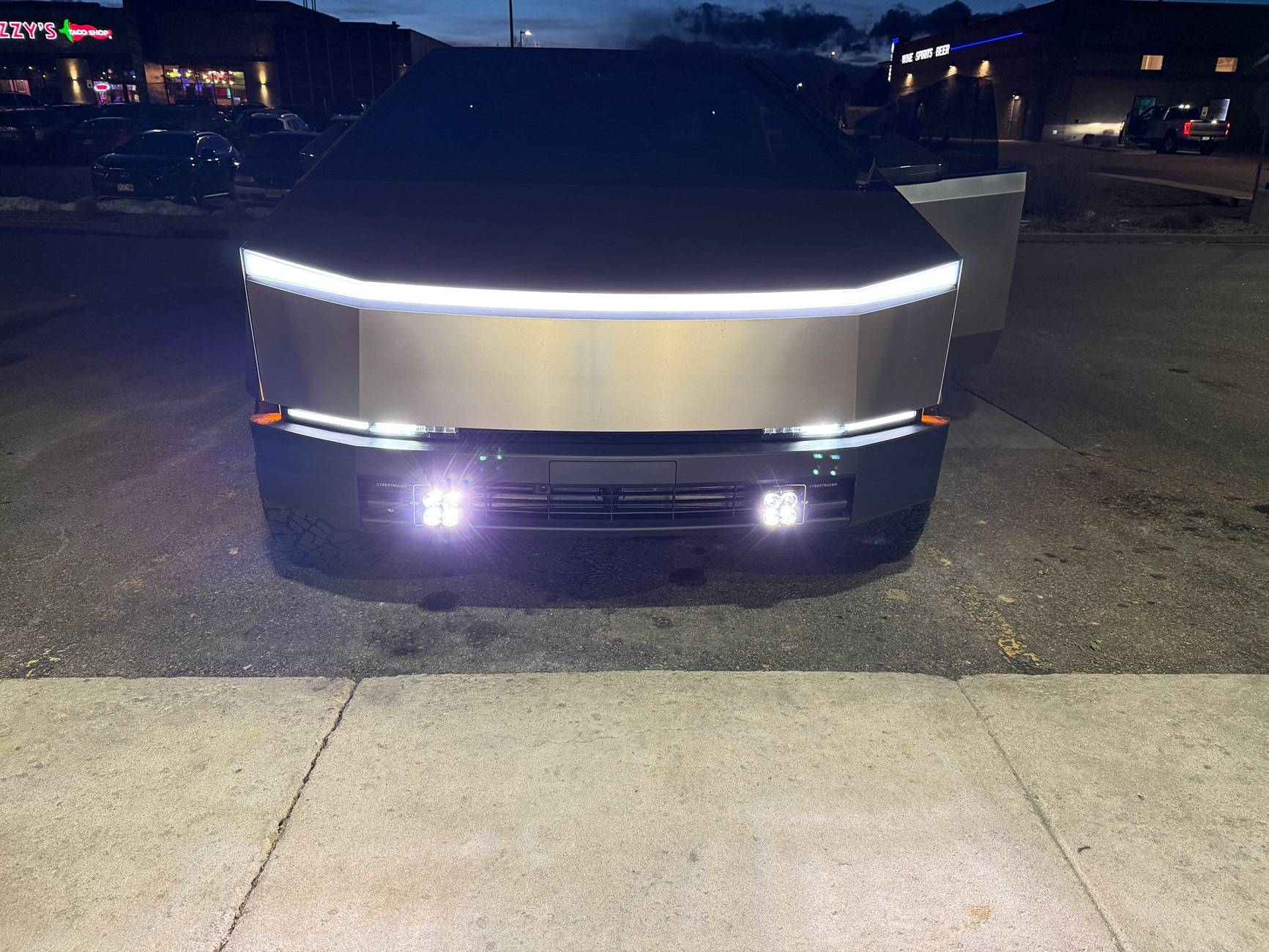

"mount my fog lights horizontally since the beam pattern only works at that position." ?? I have the XL Sports, 2 Spot's on top and 2 Wides on bottom - that's the way it's supposed to be isnt it? Beam pattern on Garage Door at close range was center (spot) and to each side (Wide)...so think it's right. Will test tonight when it gets dark. Also bough the "wide" lenses direct from BD - eg all 4 are wide, will see what works best.

I did the Sport XL's eg 4"....looks like MRMeta (2nd Post) has the 3" ones....I went back and forth on which ones to get (think I drove CyberTruckCo a bit nuts with emails, lol)....the XL's are a bit tight to rotate up/down space wise and more $'s but bigger lights put out overall more light - so depends on what you want. I think either is a good add and can add safety in winter / dust / fog and bit more light for offroad, etc

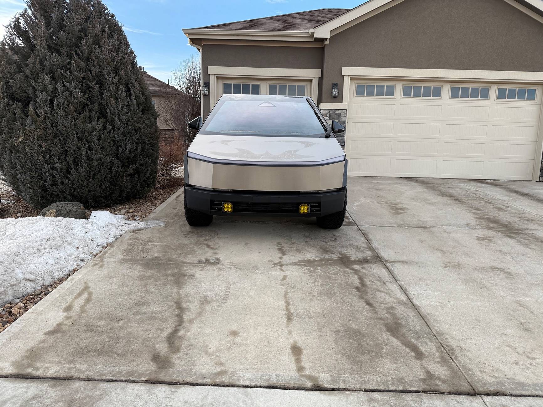

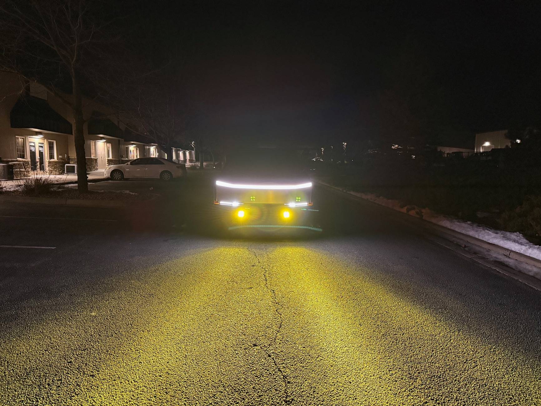

Yes XL Sport with Combo Driving Lense (white) - so 2 wide and 2 spot. My thinking, and havent fully tested to confirm. No High/Low switch installed.
1) For Snowstorms / Fog: Yellow Lense Cover, point downward vs. distance, maybe pitch a bit toward the sides...from playing around last night (no actual snow experience as of yet), pattern seemed very good (see pic with yellow lenses and look at pattern on ground), angled down I think they'll be ok for other drivers...standing at a distance they seemed reasonable...going to have wife drive opposite direction in her car to confirm.
2) For summer: remove yellow lense covers, angle a bit higher but still below headlights, only use for offroad or middle of BFE (Wyoming, Co Mountains)...
Wild Card: Bought Wide Angle Lenses (all 4 are wide angle vs. 2 and 2 spots) - and will use these if needed to protect against pissing off other drivers. Preference is driving combo as if I can get that to work, offers the most flexibility with just changing covers and or position of lights.
FYI - Baja Has Fog Lights specifically for just Inclement weather, these plus CyberTruckCo brackets could be what you are looking for (or could ask if they'd do a setup for you) - not as flexible but SAE Rated so no concern with legalities. If I didnt spend so much time in mountains / low volume of other cars I'd consider these....and may still do so depending upon how the Tesla Light Bar performs.
