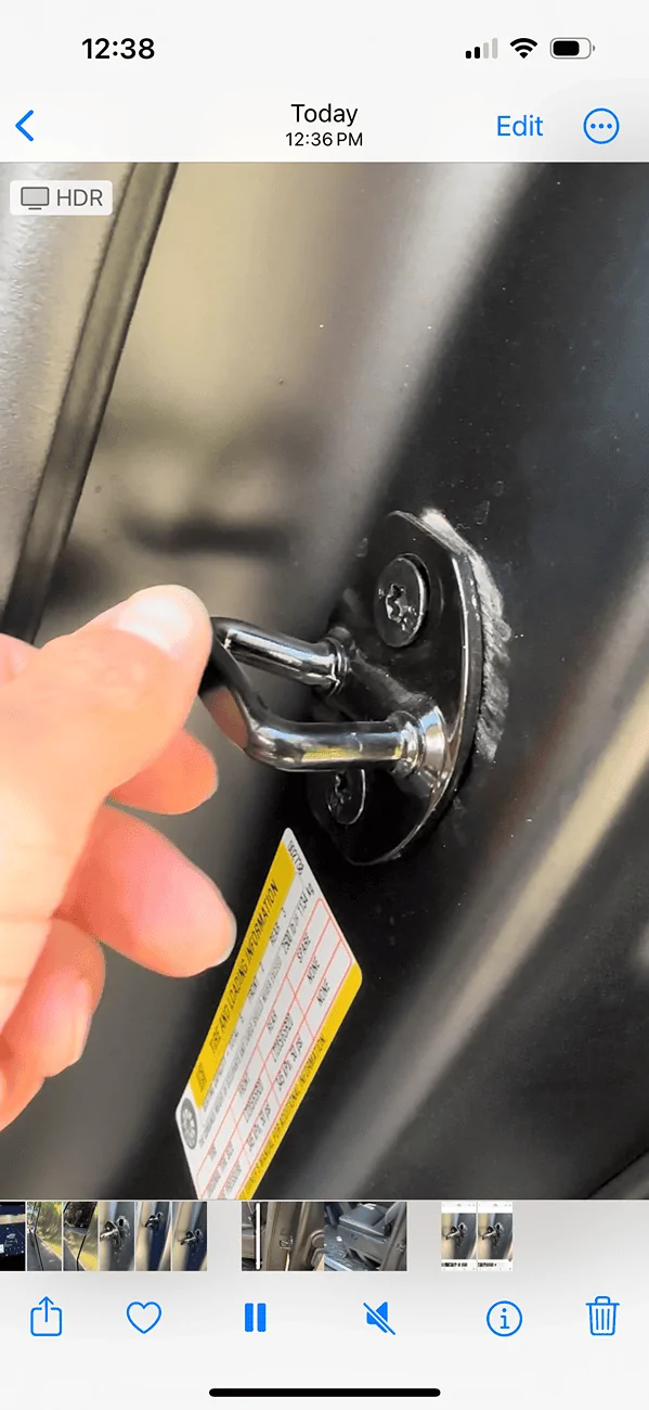

I have a feeling this is fake, for one why is the photo of a screenshot of a photo.
Secondly the person claims the door swung open but you can clearly see the latch has a bolt still attached so it couldn’t completely swing open.
Clearly the person is lying to some degree. I’m not saying the person didn’t have an issue as you can clearly see the latch missing a screw and the other screw is loose, but something isn’t lining up.

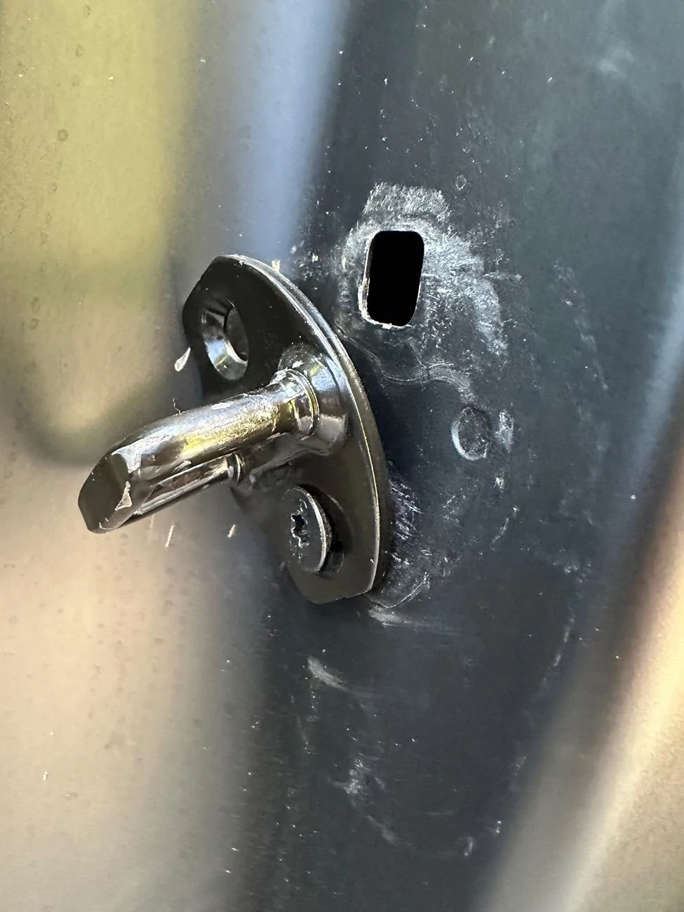

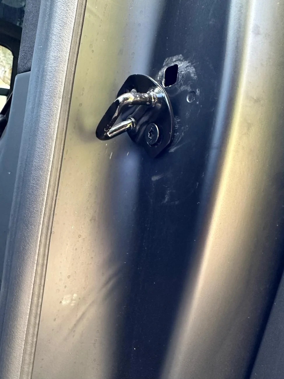

Oh boy - so many skeptics here. Let me try to clarify a few concerns:
1. First off, I attached screenshots because my photos were “live”, I’ve attached actual photos here. And shared small snippets of video (There’s a limit to file size).
2. I stated that a Tesla engineer told me not to complain. This was via social media and the person I was referencing was not actually a current Tesla employee.
3. My car was picked up last night and they have taken it to the SC to review the failed latches (both drivers side and rear passenger side) and to fix body damage and damage to our window resulting from the door not closing.
4. The latch is still hanging by a screw. What likely happened is that the door when closed was latched but because these screws became loose, the door replaced when taking a turn (and applying pressure on the door latch) which causes the latch to fail in full and to send the door flying wide open.

Regardless of the circumstances here, I'm a little amazed at how light the door latch hardware is, and especially that it uses some kind of nuts behind unreinforced sheet metal instead of a welded boss that reinforces the back side of that panel and would allow replacement of that part without access to the inside.
Someone forgot the thread lock....
And this is the way all 4 latches are designed. We used only two doors and while the rear passenger door latch failed, my drivers side door is also loose and failing (though it still latches but it causes the door to be gapped and shakes when driving. When driving you can hear the noise of air - as if the window were cracked.). It’s insane!

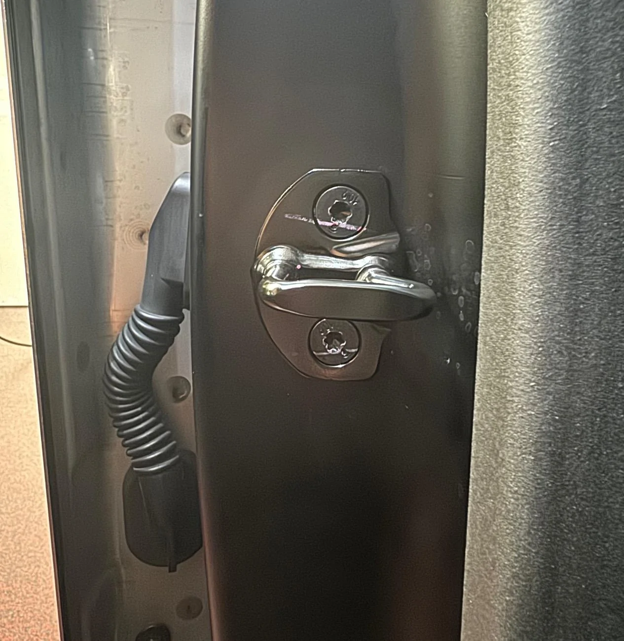

Checked all my doors to be sure. I noticed in the OP pictures there are no torque marks on the bolts. That seems odd.

And the fact that the latch on my drivers side door is also loose tells me this is an issue with the entire way the latches are designed.
The latch design is fine, your bolts were evidently improperly torqued. My latches are rock solid.
If you believe you've found a defect, open a service ticket instead of relying on internet randos (including me, hahahaha)
Agreed. It sorta happened to mkbhd on his first review (the bolt was loose so the door didn't shut all the way). A lot of the bolts were loose, or became loose over time until they updated the process.
