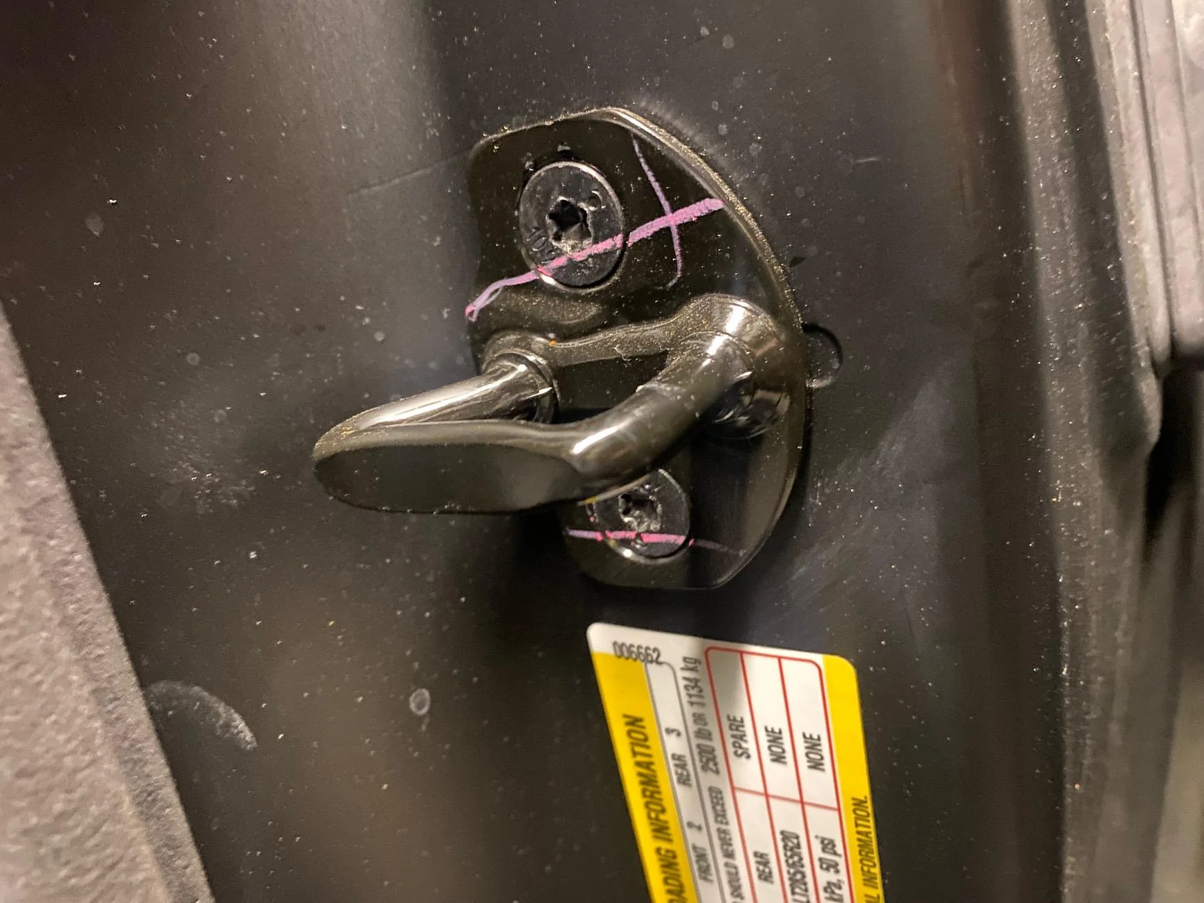

The latch design is fine, your bolts were evidently improperly torqued. My latches are rock solid.
If you believe you've found a defect, open a service ticket instead of relying on internet randos (including me, hahahaha)
I just checked my latches, they seem very soild but i only have 5000 miles registered anyway. I compared with my GLS, they don't seem much difference in rigidness . Of couse, CT door is much heavier than GLS door.
I never paid attention to the latches till this post. I just found 2 pink mark line which actually can be easily removed on 2 of 4 latches. What is that for?
OP door latch was the only incident i found everywhere for such severe failure. The only reason i usually don't recommend CT to my best friend is even the my CT itself is amazing but you never know who will be the next for a crappy just-start-ramping Friday afternoon build.
I'm guessing it's a QC mark to indicate the proper torque was applied.

Oh boy - so many skeptics here. Let me try to clarify a few concerns:
1. First off, I attached screenshots because my photos were “live”, I’ve attached actual photos here. And shared small snippets of video (There’s a limit to file size).
2. I stated that a Tesla engineer told me not to complain. This was via social media and the person I was referencing was not actually a current Tesla employee.
3. My car was picked up last night and they have taken it to the SC to review the failed latches (both drivers side and rear passenger side) and to fix body damage and damage to our window resulting from the door not closing.
4. The latch is still hanging by a screw. What likely happened is that the door when closed was latched but because these screws became loose, the door replaced when taking a turn (and applying pressure on the door latch) which causes the latch to fail in full and to send the door flying wide open.
5. I have a loaner and will report back the findings. I have also filed a formal complaint with the NHTSA and will report back any response from them - including any recall notices.
6. I waited 4 years for this car, and I booked my reservation the moment I saw it. I am obsessed with the design of this car. And this is my third Tesla - I have a model 3, and bought my parents a model 3. I am also a shareholder of TSLA stock and believe in the company. I even purchased the tent - and was so excited to have this car be my dad van.
7. Howver, from the other nights incident - I’m just so shaken. This could have ended so tragically with my child in the rear seat (car seat) right where the door failed. And the fact that the latch on my drivers side door is also loose tells me this is an issue with the entire way the latches are designed. Putting this in context to the accelerator pedal that can dislodge, the wiper blade motor that fails, and the rear panel that flies off tells me that this car- despite being so delayed, was rushed to market. As much as I want this car, and as much as I want this car to succeed, it’s just not responsibly designed or built - and it’s just a matter of time before it costs someone their life. This is why I am sharing my story.

Regardless of the circumstances here, I'm a little amazed at how light the door latch hardware is, and especially that it uses some kind of nuts behind unreinforced sheet metal instead of a welded boss that reinforces the back side of that panel and would allow replacement of that part without access to the inside.
Someone forgot the thread lock....
Isn't a nut welded/fixed in-place so you can remove the screw and replace it?
Seems OP could just hand tighten all the strike screws and go get it checked after

Well, it shouldn't happen, but the point that it didn't have the marks on it kinda makes suspect that it wasn't finished.
It just seems surprising you wouldn't have noticed the door was loose first - but things happen.
