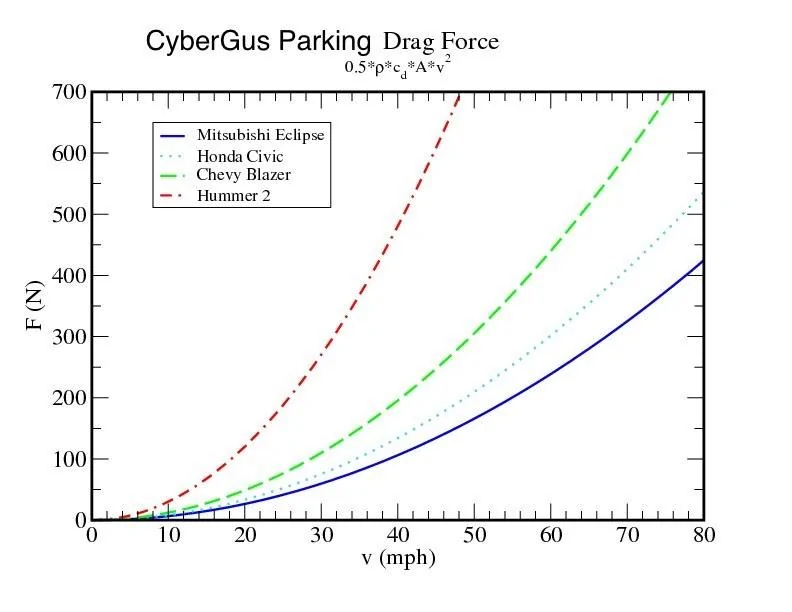

Perhaps it’s a good time to re-up this graph. I’ve seen people say something like “my model X experiences very little range reduction, so I’m sure Tesla has this figured out, too.” But they’re confusing how physics works, as between drag profiles of increases frontal planes.
The bigger the object, the more air temp, humidity, wind, and speed accelerate the exponential curve of drag (all of which I know you in particular know very well, but to state it for the observer):
