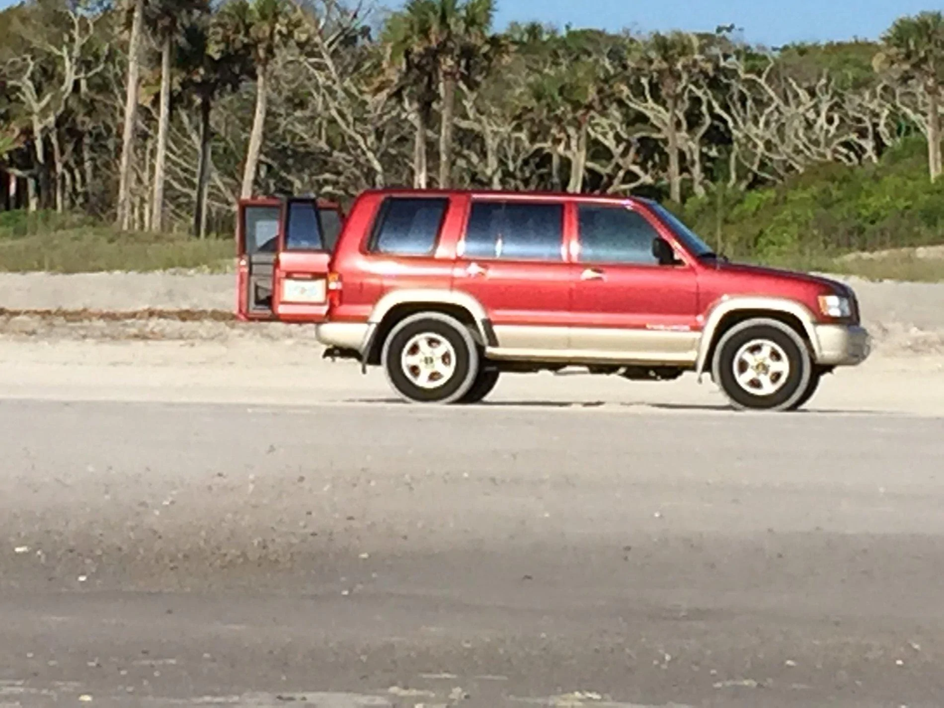

My CyberTruck will be a replacement for my surf fishing tackle box, a ’99 Isuzu Trooper. Its purpose will be to carry my coffee, music, and surf fishing gear on the beach. Hopefully,
it will do well on the beach and not get stuck in the sand.

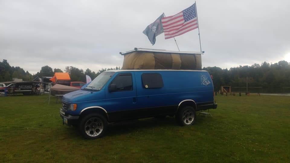

After looking at the traction controls on the sport models that allow slip start and stability and traction control...it probably won't even need lockers, however there is a company making this limited slip differential for the current Tesla's that's a bolt in much like the track lock.
the Cyber trucks not really that going to be great in tight situations because it's as long as my extended base cargo van. However I have had that down many trails.
