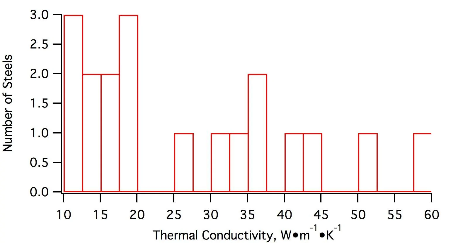

It's a bit disingenuous to pick a high thermal conductivity steel and compare that to stainless when in fact steel conductivities can vary quite a bit:
Within this histogram there are 2 stainless samples, both in the second bar.

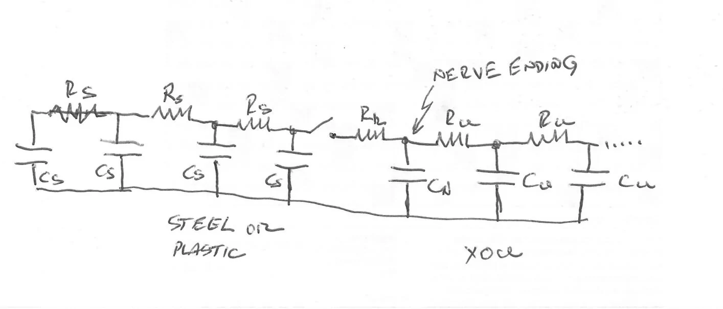

I've been wishywashing about here trying get across that conductivity of the material is not the main driver here while at the same time recognizing that it is a factor. Electrical engineers use an electrical circuit to model problems like this because the math is the same. So I'm going to show that model (but not do any math) in the hopes that it might make my reasoning clear.
The skin of the truck, on the left, is made up of separate bits all interconnected each represented by a capacitor whose capacitance is proportional to the bits' thermal mass. Conductivity between the pieces is represented by the thermal impedances Rs. The skin is assumed to be initially at uniform temperature so all the capacitors are equally charged to some temperature higher than human body temperture. You are similarly composed of thermal masses interconnected by thermal impedances. You are essentially a bag of water at 37 °C. Water has thermal conductivity of a bit less than 1 W/m•K (i.e. about the same as human skin and plastic). Steel has conductivity of 10 - 60 W/m•K (with stainless at the low end).
Water has specific heat of about 4000 J/kg•K and density of about 1 g/cm^3. Steel has specific heat of about 500 J/kg•K and density of about 7.9 g/cm^3. Thus the relative sizes thermal masses of the same volume in the steel and you are about the same and so the capacitors in the model are all about the same size with steel. But the interconnecting impedances are 10 to 60 times higher in you. When the switch is closed Cs discharges through Rk (your skin resistance) to charge Cn (the thermal mass that contains your nerve ending) so its temperature rises as the temperature of the steel to the left of the switch falls. But as soon as that happens the next capacitor to the left discharges to charge the capacitor next to the switch. This happens much faster, whether the conductivity be 10 or 60, than Cn, in you, discharges to charge the first Cu in you because the conductivity is at least 10 times higher in the steel. Cn charges much faster than Cs adjacent to the switch discharges.
Now with plastic the Rs are bigger so the caps distal from the contact point take longer to charge the cap right next to the switch and that cap discharges faster meaning the plastic cools faster at the contact point. Thus, I suppose, we conclude that that if the conductivity of the material is small it does effect how hot or cold it feels but if the conductivity in the material is 10 or more times that of the body, it doesn't make much difference.
