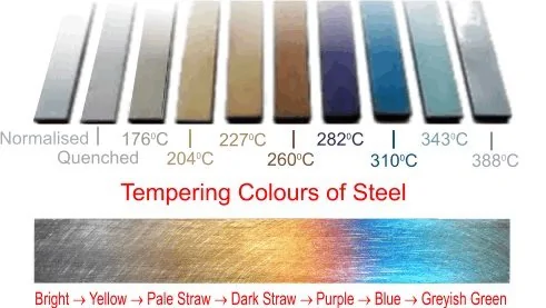

Probably super cost prohibitive since you’d have to disassemble the truck. No plastic bits are going to survive that heat. I also don’t believe we’ve received word if there will be any type of protective coating over the steal or if it’ll be raw. Just the trial and error to get it right would be a financial nightmare. I sure wouldn’t volunteer my truck to experiment on.
It’s cool, and I’m sure someone will do it for YouTube clicks, but I don’t see it becoming common. So much easier to just wrap it.

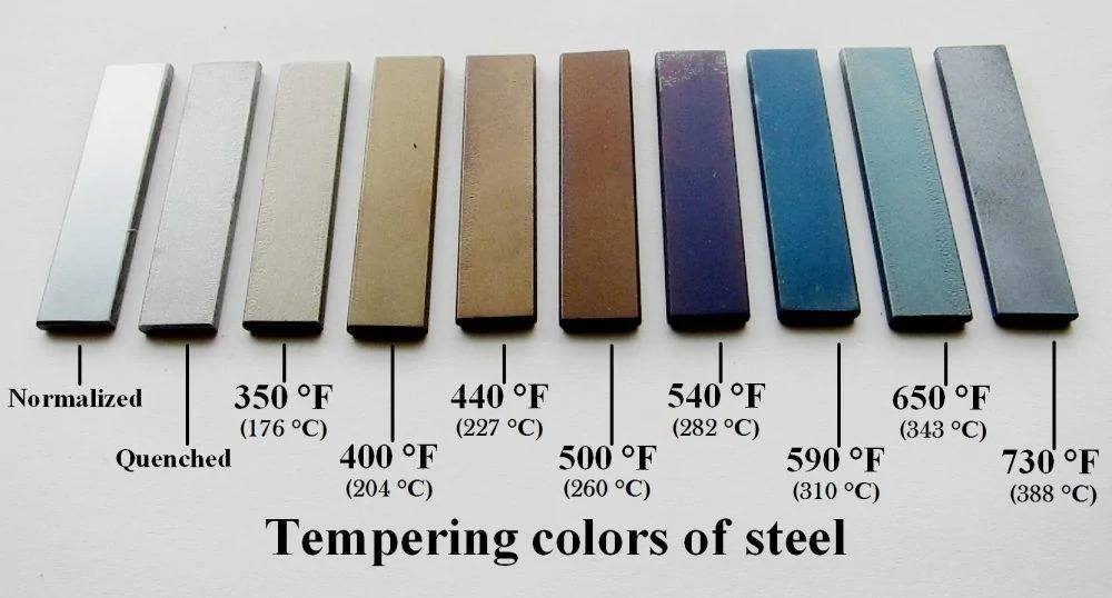

I’m digging 650 degress😁

the thing is, this color isnt all that strong and would scratch very easily.
although I have a very cool image called "entry burn" in my mind of the bottom half with these colors going halfway up the truck, like it was dropped through the atmosphere like the dragon capsule, or older apollo capsules
its basically the same as bluing firearms...
from wikipedia blueing(steel)
"being a chemical conversion coating, is not as robust against wear and corrosion resistance as plated coatings, and is typically no thicker than 2.5 micrometres (0.0001 inches).
maybe ill add this to a test for the 3mm plates i have.
https://en.wikipedia.org/wiki/Bluing_(steel)

I just don't think this is going to be a viable option. I'm not a metallurgist, but I would think heating up this proprietary cold rolled 30X stainless steel would decrease the integrity of the intended purpose of this metal, hence, not making it do what it's supposed to do. When you heat metal up, it changes the physical properties of it.

I don’t think it’ll be easy or maybe even possible with all of the components in the door, fenders, etc. The steel however is going to be the same steel on the starship, so I think it’ll be okay.

Yeah, this is just crazy talk. I can just see some dufus taking a blowtorch to his cybertruck and all the plastic bits and wiring and insulation and adjacent upholstery melting...

From Wikipedia:
"Does tempering increase strength?
The reduction in hardness is usually accompanied by an increase in ductility, thereby decreasing the brittleness of the metal. ... Higher tempering temperatures tend to produce a greater reduction in the hardness, sacrificing some yield strength and tensile strength for an increase in elasticity and plasticity."
