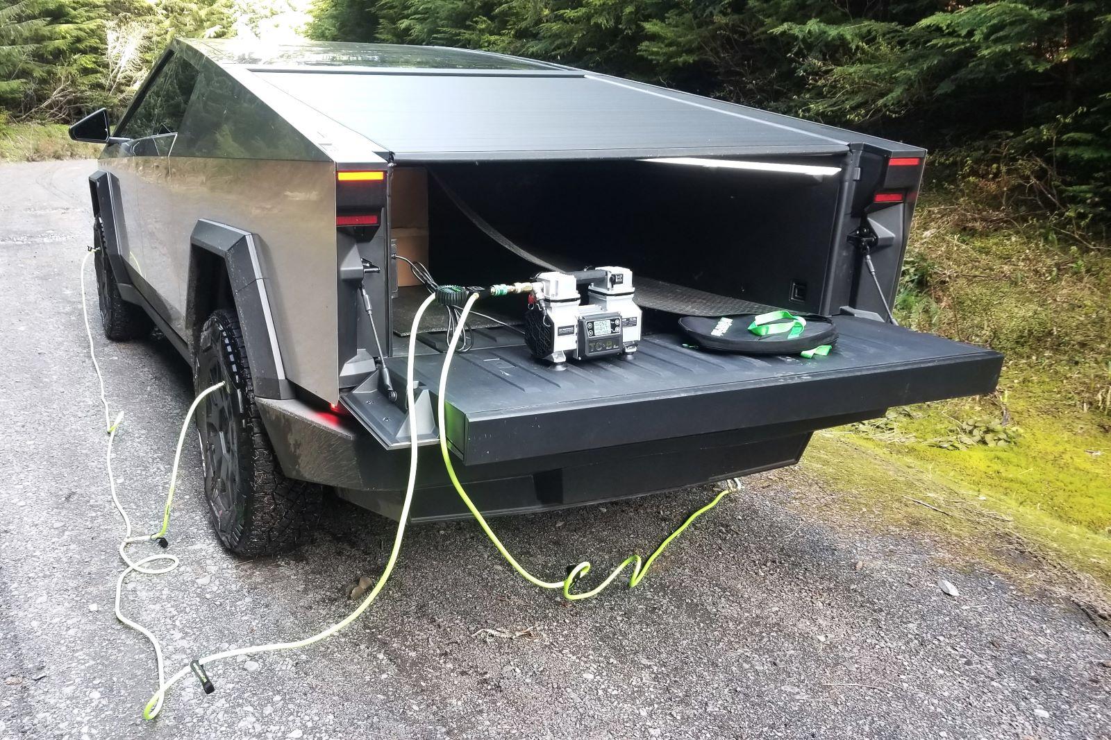

This setup with a 120V compressor can fill all four tires at once, from 35 psi up to 50 psi in 4 minutes, only one minute per tire:
Tesla Cybertruck CYBERTRUCK TIRE EATS A BOLT IN A REMOTE LOCATION ON SUNDAY MORNING 20240606_175245adsm
Even though I haven't had a flat tire for two decades (on a four-wheeled vehicle), I can't imagine going very far from home without a way to fix a flat! And I've never had a flat that I couldn't plug by the side of the road. Spare tires are an out-dated concept.
what compressor is that? Where did you buy it?
