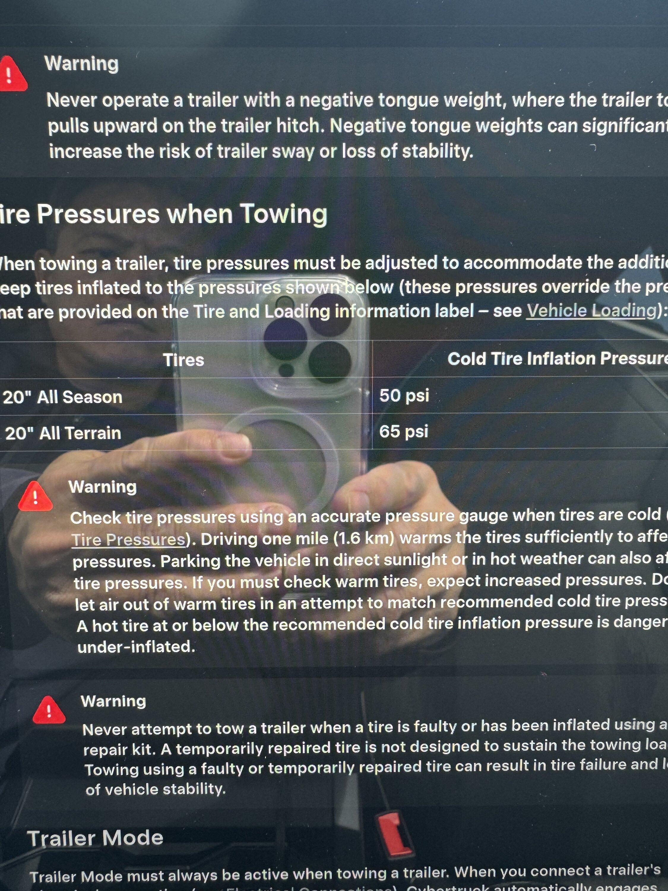

Cybertruck foundation series comes with all terrain tires.
According owner menu. The tire pressure should pump to 65 psi when towing.
It a lot compares with normal drive or all season tire.
Does anyone pump to 65 psi when towing?

Good question. I read that also and had never heard anyone suggesting to inflate tires when towing. Interested in hearing what others experiences and practices are.

Likely prevents premature tire wear. I run 75-80psi towing with a 2500
