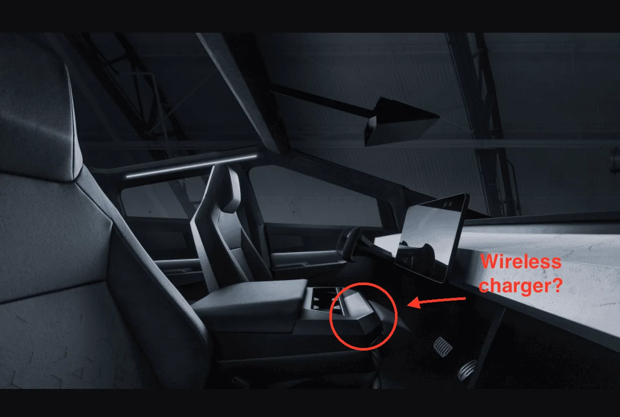

Ok this might sound lame but i really am curious. Does anyone know if the Cybertruck will have wireless charging pads for your phone? I've been staring at photos of the interior and can't see where one could exist. I see cupholders when the 6th seat is folded down but where can i place/charge my phone? o_O:unsure:

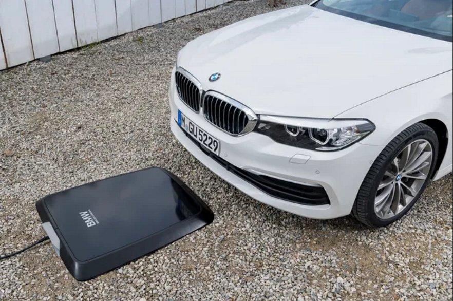

it's just a wire coil. There's less in it than a cable. It looks like a work mat. You can hide it under a surface. It's not fancy.
You're telling me you would leave this in your driveway? Not in my hood! This must not be the model you're talking about because it looks pretty fancy to me.
Yes, that's a fancy plastic box. There is no reason for it to be a fancy plastic box. It's a dumb wire coil. Maybe a sensor about the size of your pinky to detect the car, but you could do that with the coil.
In fact, that model looks downright dumb.
