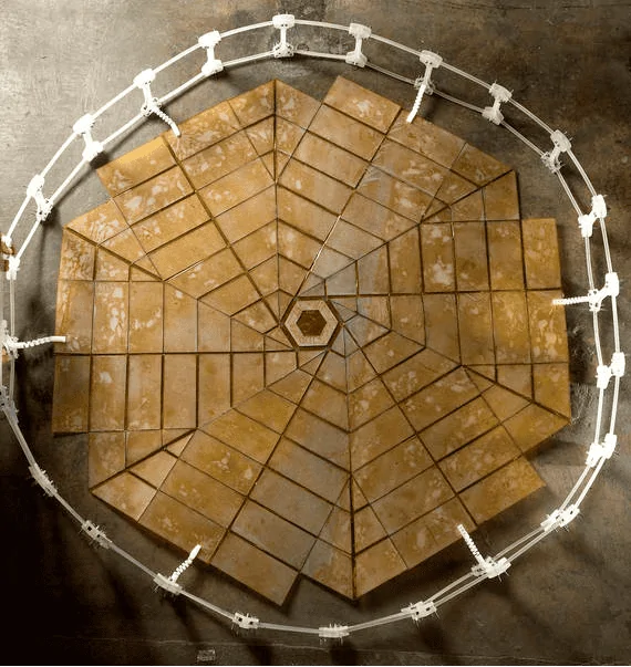

Last year, Zirbel and Trease collaborated with origami expert Robert Lang and BYU professor Larry Howell to develop a solar array that folds up to be 8.9 feet (2.7 meters) in diameter. Unfold it, and you’ve got a structure 82 feet (25 meters) across. Their 1/20th-scale tabletop prototype expands to a deployed diameter of 4.1 feet (1.25 meters).
