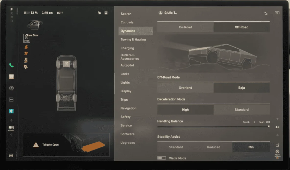

84
8,172
26,823
i was driving 10mph and it would return back to low. i have the latedt software release. prior to last update I recall having the option I believe in my profile to select the driving mode, but appear not to have an option anymore.
Tesla Cybertruck cybertruck wont stay on high height 1701587535219-
Is this not what your "Dynamics" screen looks like?

thanks I was in comfort Drive mode not off-road mode but now I found that option and will use it next time as it appears in comfort mode you can't drive in hugh but low no matter what speed I'm going
