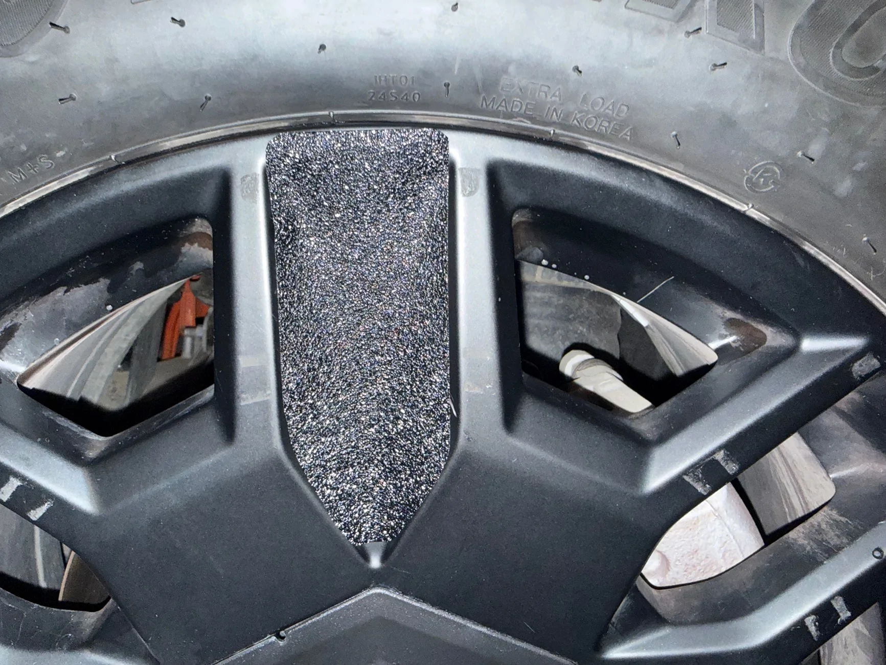

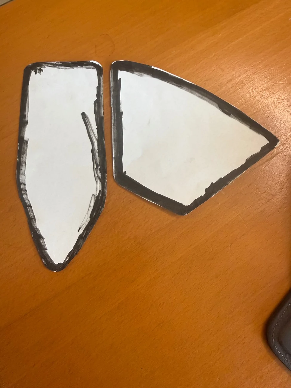

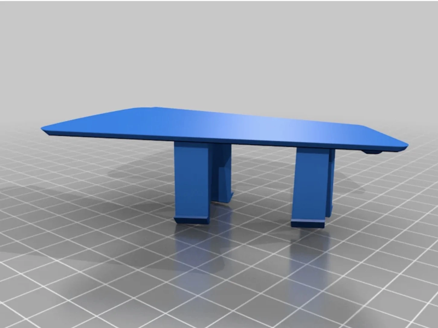

Been hoping some would do this eventually. Sign me up. Aero benefit without obstructing the valves and can be made in whatever color you want to introduce into the wheel.
Big time potential here in my opinion.

Note of caution you do not want to block off the wheel entirely so that no air flows through. Even the factory full covers have a designed gap to bring air into and through the wheel and brakes. The longer of these 2 pieces should have a slit down the middle with an angled opening that allows most air to pass over but some will be diverted through the slit and through the wheel and brakes. This would be preferred to simply blocking off the entire wheel and impacting airflow across the brakes. BTW you also want airflow across the brakes to help dry them in the wet.
