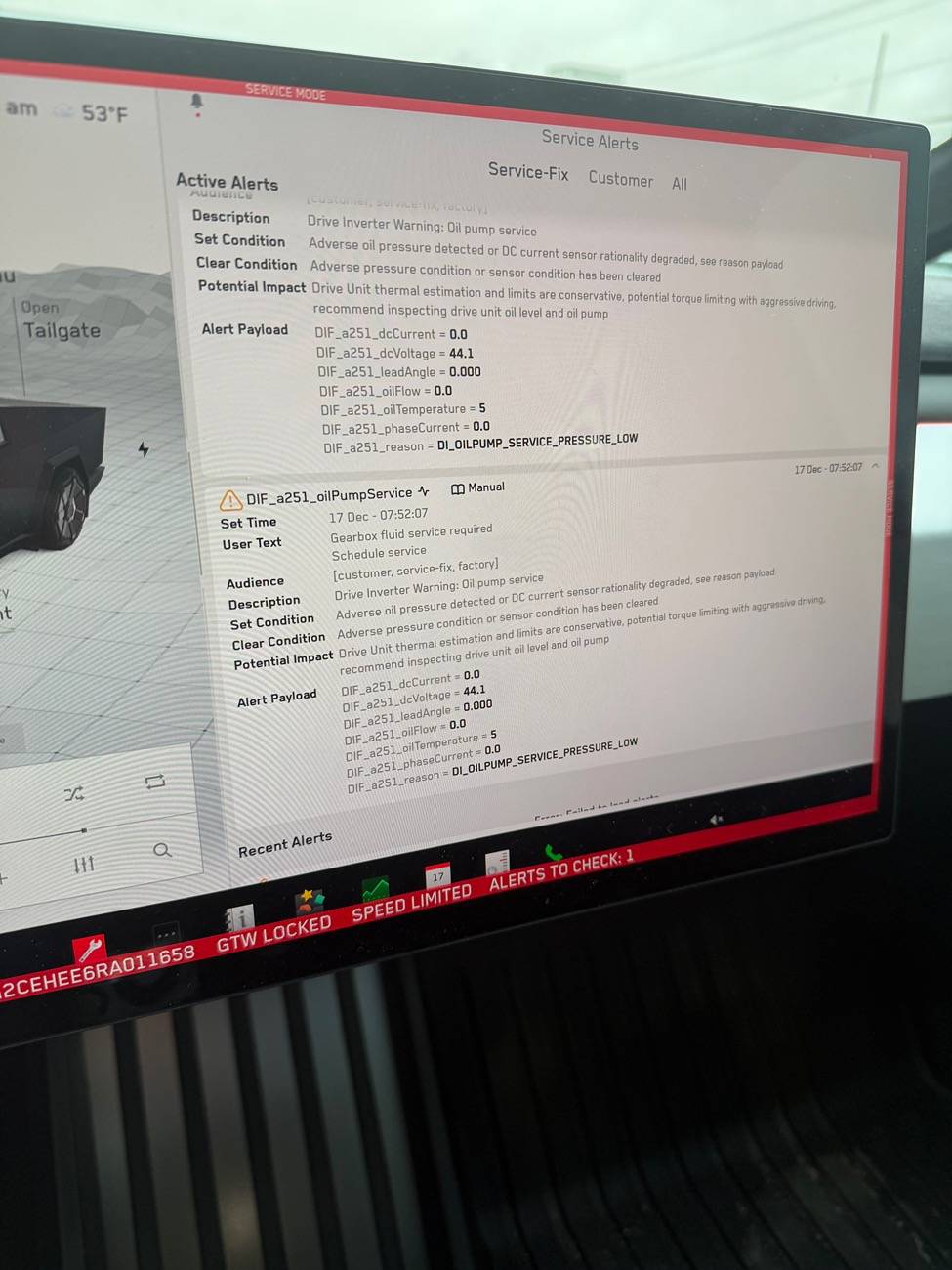

This is what it’s telling me in service mode - pressure low…don’t know if your reason is any different, what is it giving you for payload values?

I just got this message this morning driving through New Mexico on my way back to NJ. So found the next Service Center on my way which was Albuquerque and they are checking it out. They included an engineering group (3 letters?). It was 19 last night so could be cold issue. The warning was gone from the log after a supercharger stop; which was odd.
July pickup 15K+ miles.
first update: found drive unit oil low so drained and re-added, test drove and no warning. Awaiting engineering.
Last update: the technician comment in the repair progress screen said he added oil and closed me out. Seems good; I’m in Ohio. LOL

Got a message from tesla, they said it was a firmware issue detecting oil below 0 celcius, and they are working on a patch.

I just got the same error DIF_a251. I saw someone else say they had taken their CT to a car wash just before. I have been using a car wash now that there is salt in Ohio, but it had been days and that error happened just as I was heading home from picking up my truck from wind noise in the windows when below 20 degrees (separate issue and not resolved). Tesla now says my pump on the front motor is reporting low pressure and want to replace it. I will be without my truck for another 10 days. I am torn. I don't want to risk anything especially with a planned drive to Kentucky from Ohio, but it only popped up once and I miss my truck! Nothing drives like the CyberTruck. This is one of many trips I have made to the service center, but most were for cosmetic defects when I picked it up. I did have a nasty vibration at 55-75 and that has was solved with a new rear motor. I still would not drive anything else, but this is getting to be tough.
