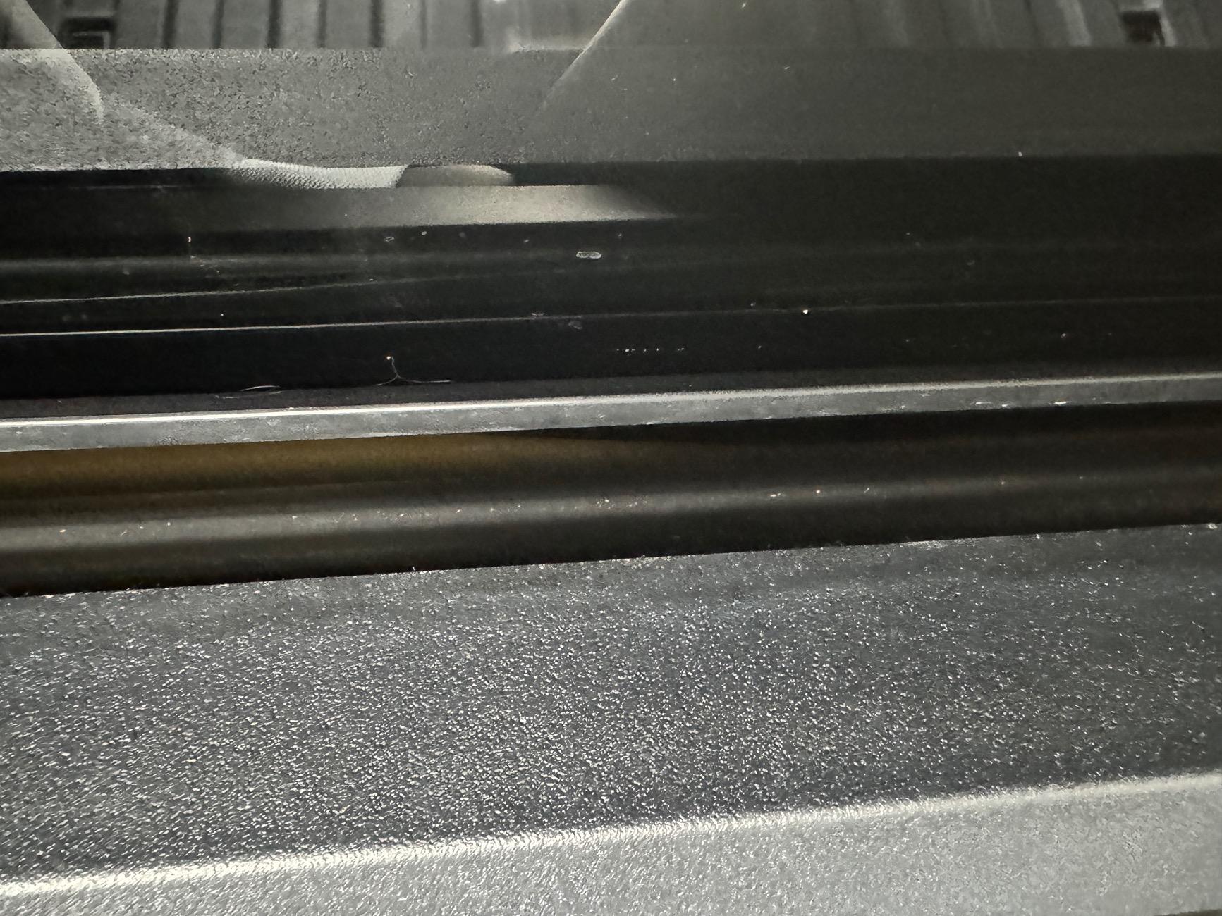

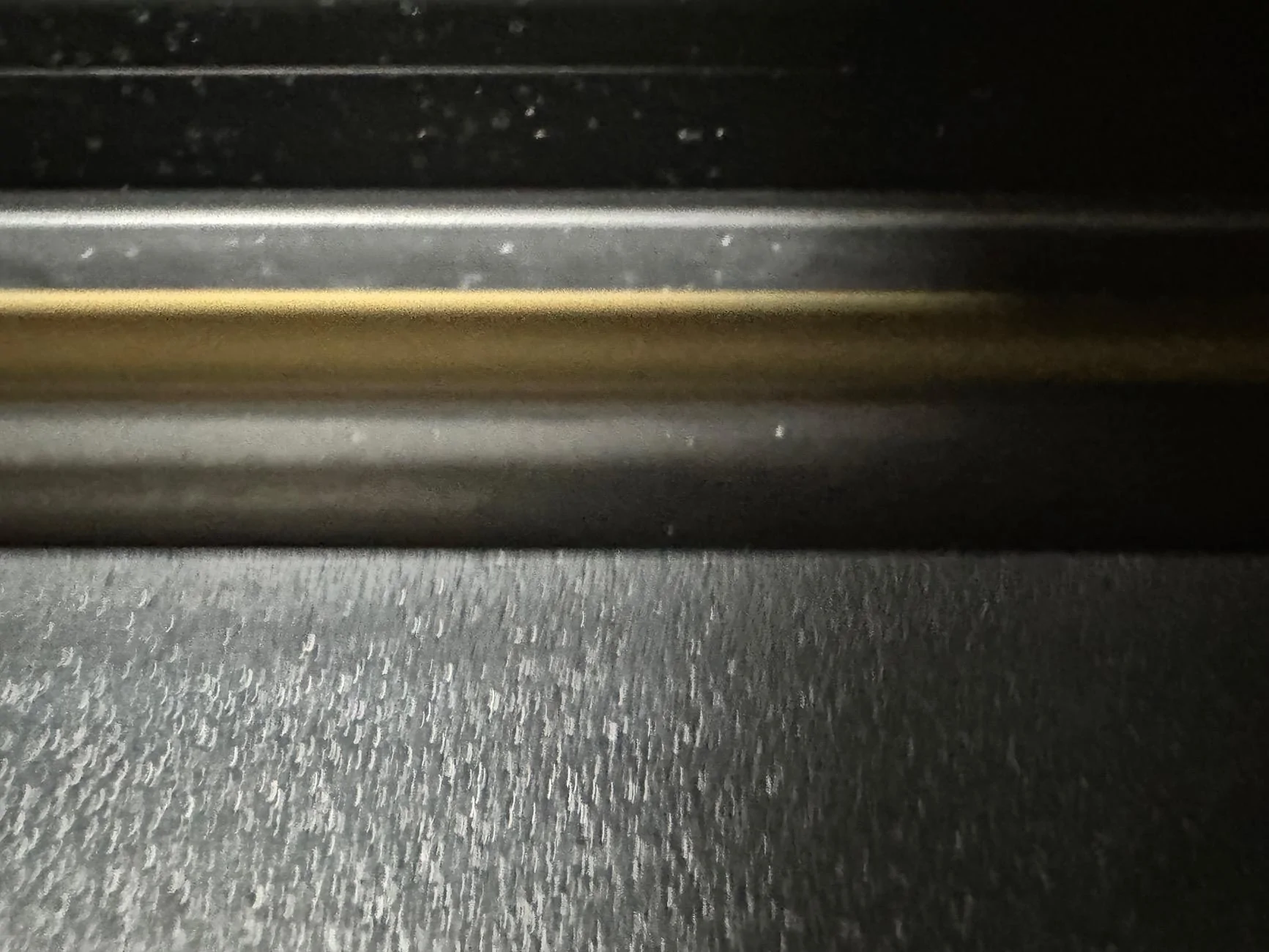

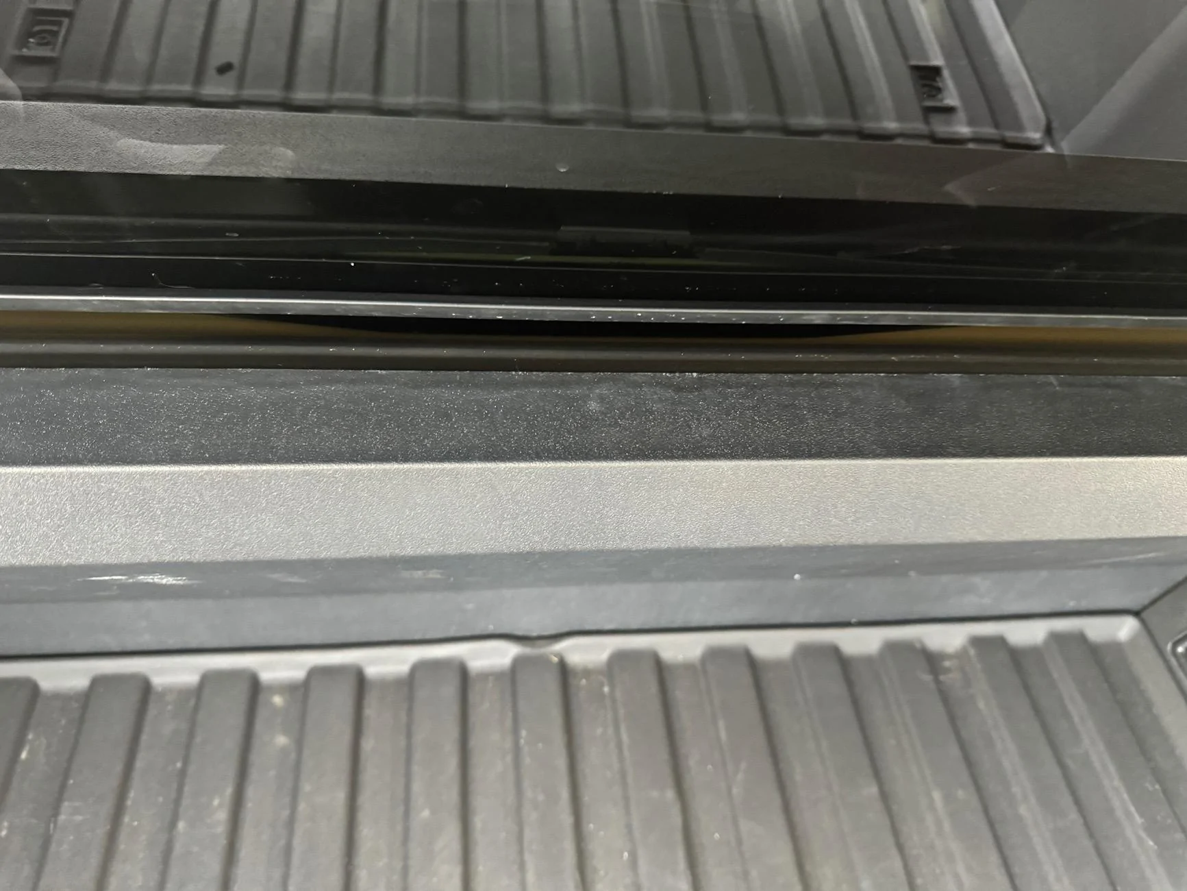

when y'all guys look in the bed between the glass in the insulation. Do you have a rubberize or painted surface? They replace my glass/seal and now I see unpainted metal

i have the awd verson. Since they can't repair the old version with seal tape only as it gets caught in the tonnage they replaced the glass with the new seal. . . I looked at a new cyber truck and it appears when they switched to the new seal they also added a rubber protector to the back.
The "unpainted metal" is metal that is ecoated in a greenish color after baking. The new process uses black ecoat so it appears painted but it's just a different color. The Cybertruck now has a dedicated PTED system. Previously before vin 23000 ish they were using the same process as the model Y being built at GFTX.
