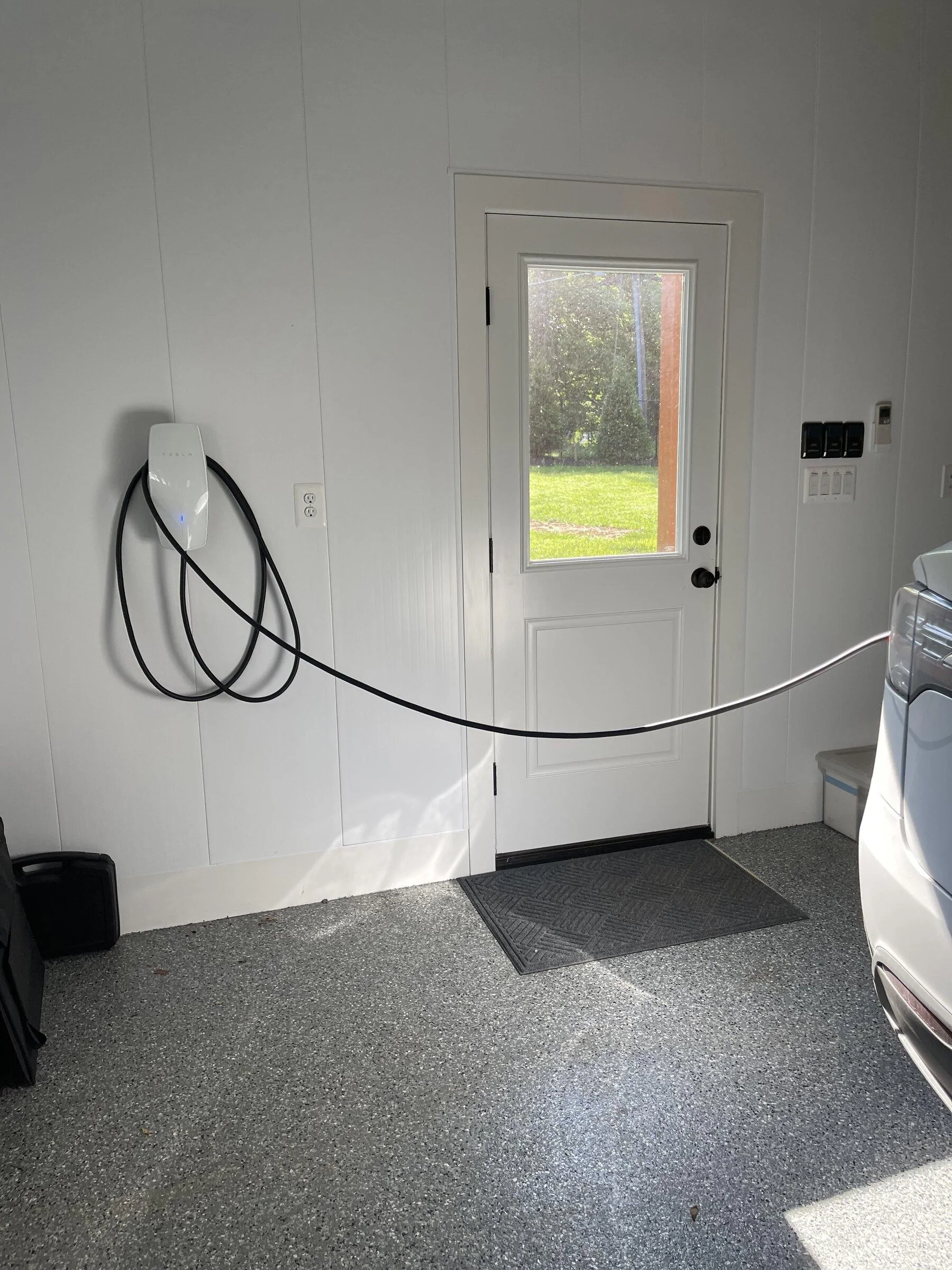

HPWC in use. Located so as to keep cable off floor:

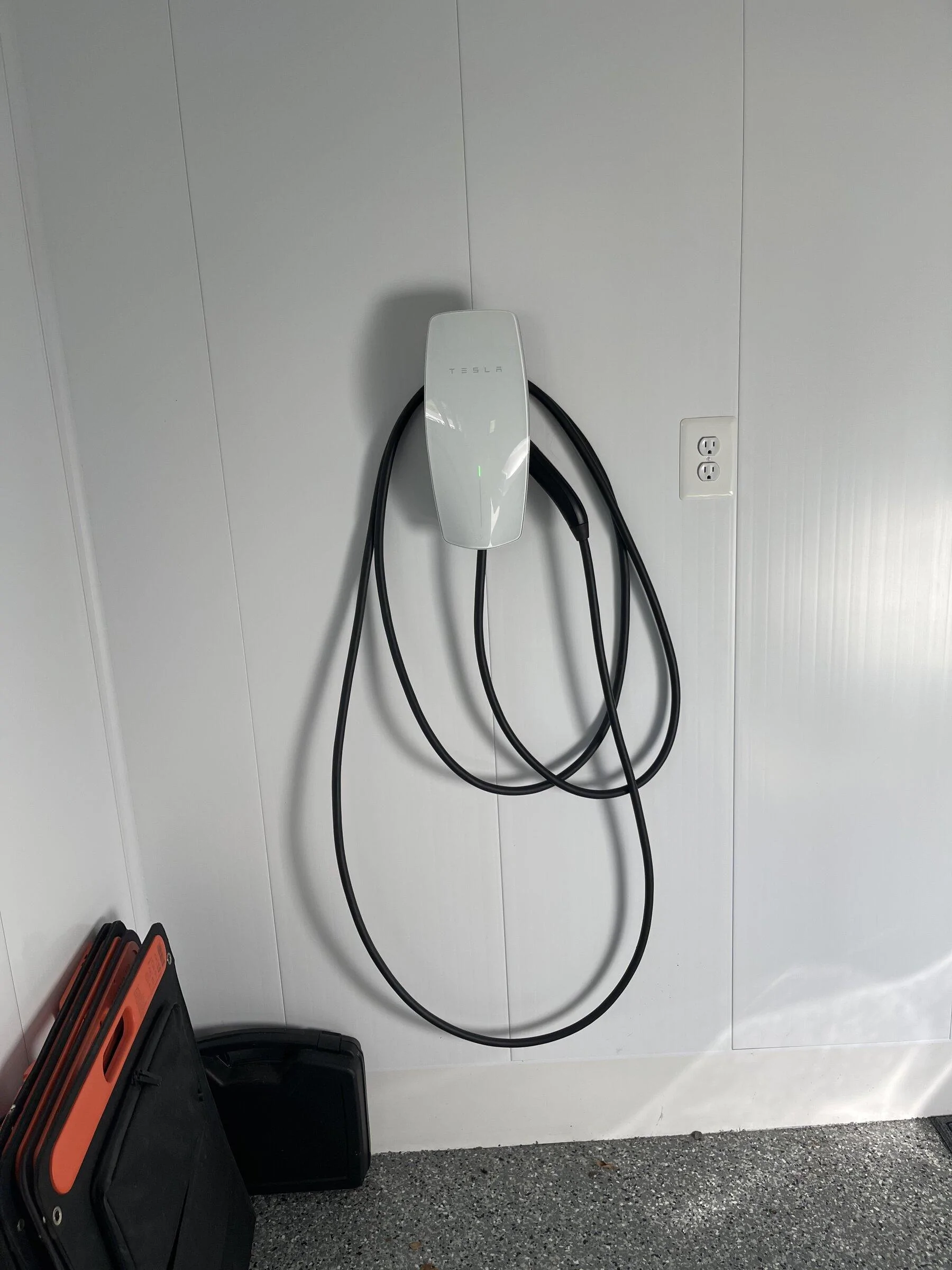

Same HPWC with wand stowed in internal "socket". No electrical connection:

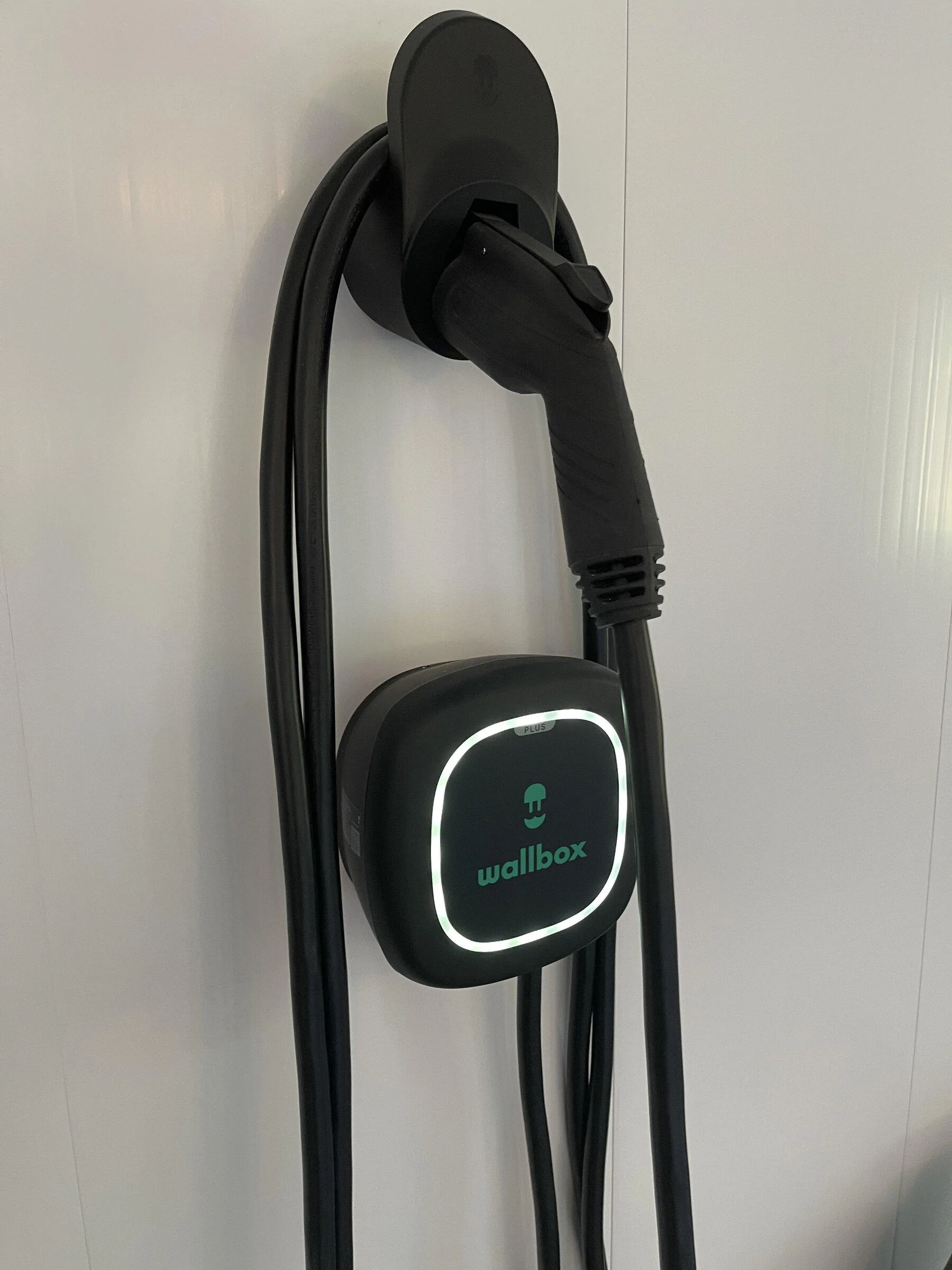

WallBox Pulsar stowed. No internal socket:
