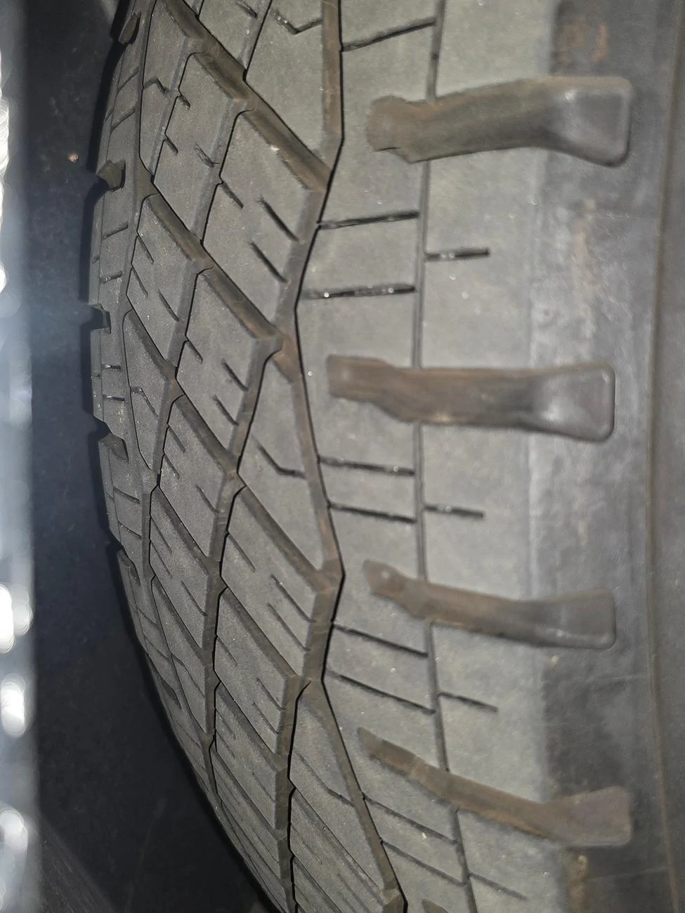

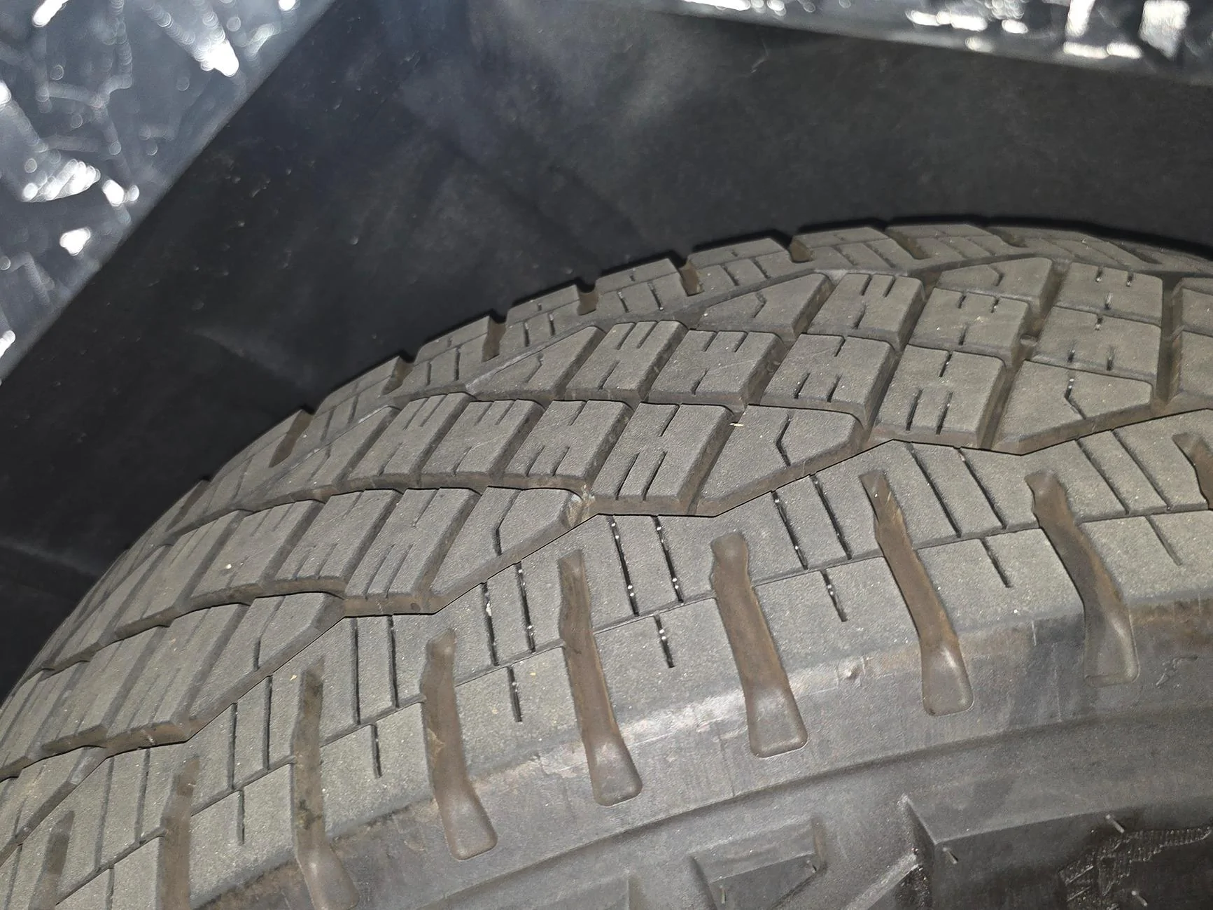

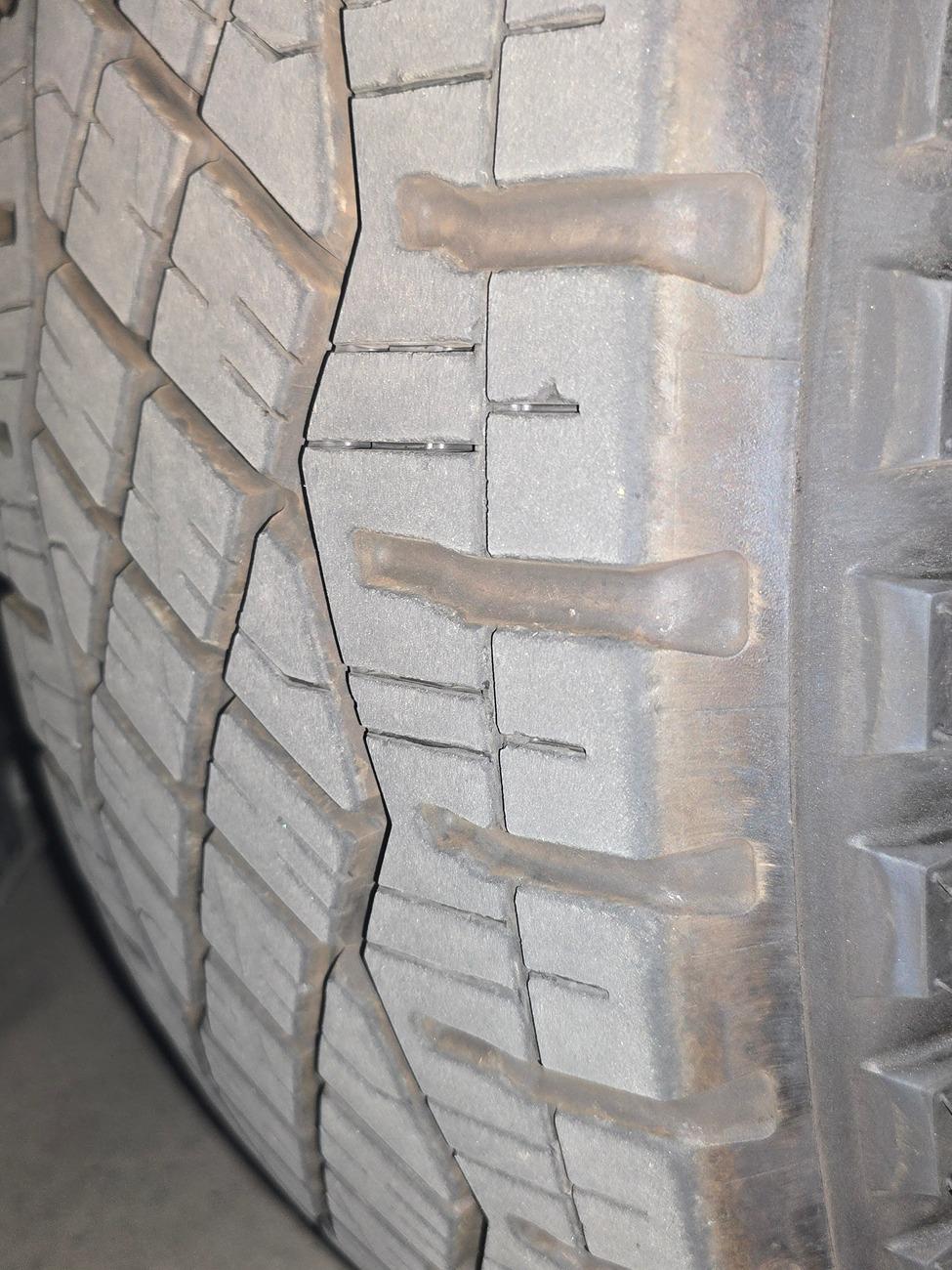

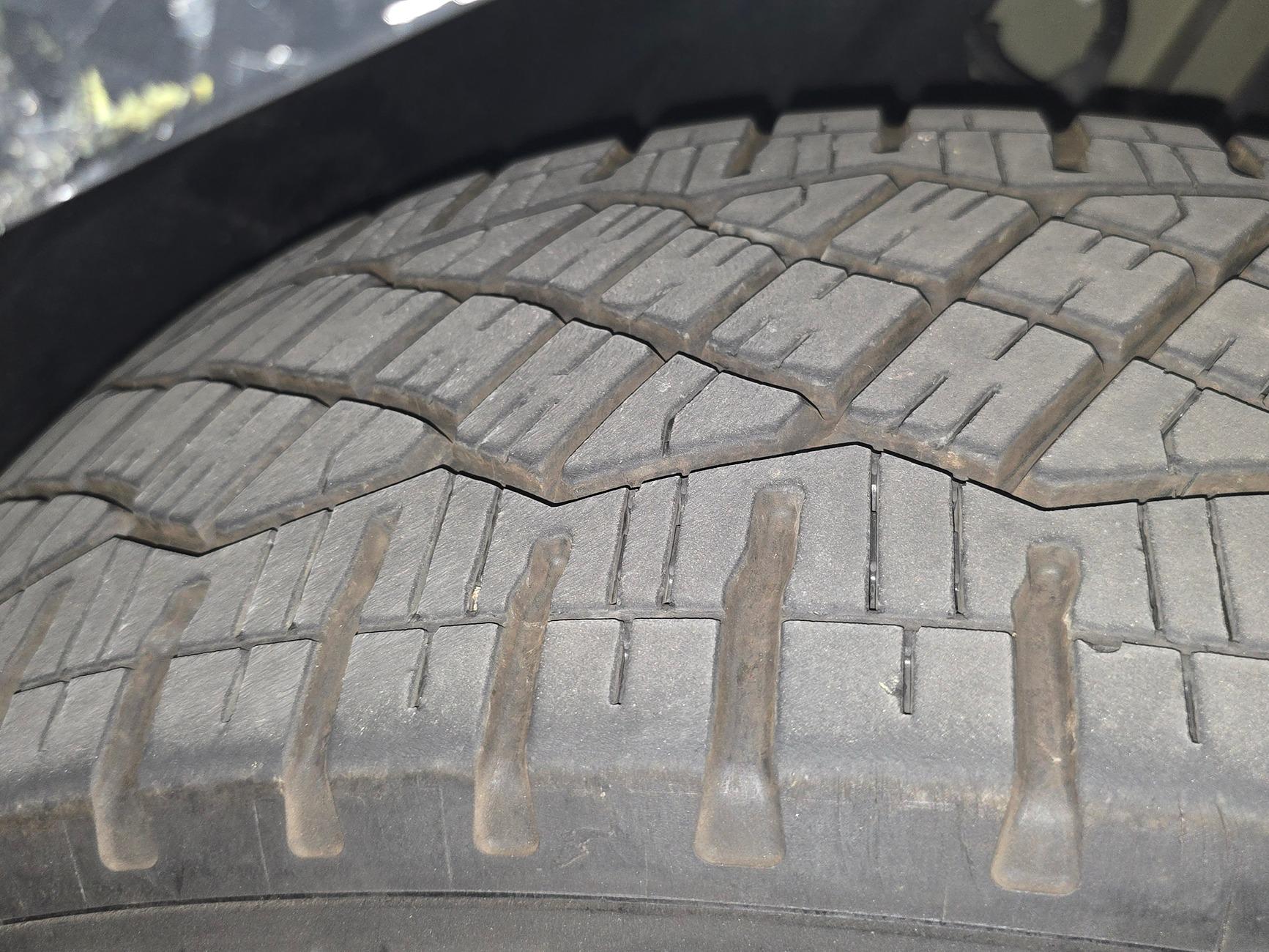

1st pic driver, 2nd passenger 3rd behind driver. 4th you must guess?

If the edges are wearing faster than the centers a bit more air pressure will help. That will also help them run cooler on the highway which will extend their life.
Do you typically travel with a lot of weight (passengers or things)?
Keeping the suspension in the lowest mode also helps because it reduces aerodynamic drag and thus the amount of work the tires have to do.
