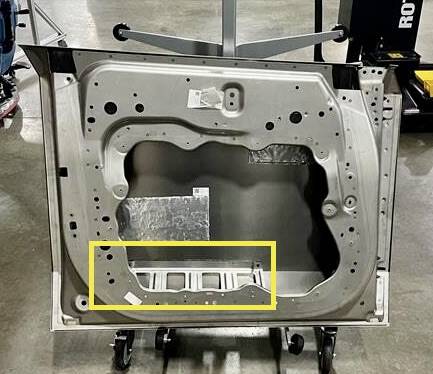

As it turns out, all four doors on my 29000 or so VIN Foundation Edition have to be replaced. Why?? Because each one of the doors rattled when they were shut (video attached). Turns out there is a structural adhesive that helps bond the inner to the outer door and for whatever reason, probably not good prep work, that adhesive failed. There is no repairing the doors. Tesla is going to replace each one of them under warranty and they’re also going to cover the cost of re-wrapping each one of the doors (which I thought was a nice thing to offer without me asking).

My driver side door rattles at high speed & is being replaced by Tesla. SC mentioned mine is only the 3rd truck with this specific issue & gave them an opportunity to make a video for training purposes for this specific issue.

Trust me, if you had the issue being demonstrated in the video, you would know it because the doors sound completely solid otherwise.
And to correct the OP's terminology, the rattle demonstrated is not the inner and outer door panels because those are perimeter laser welded to each other, structural adhesive is only used on other inner door assemblies.
I'm glad they are taking care of you, this should have been caught before the truck left the factory.
FYI- there is a service bulletin on this issue according to the Tesla Service Center
they actually showed me where the issue was and it’s about 35 mm out from the perimeter where the laser weld is. It’s structural and that’s why they cannot repair it.
Yes, it could be structural to the inner door insert, it's not structural to the inner and outer door panels because they are welded together all the way around the perimeter (except for weep drains).
