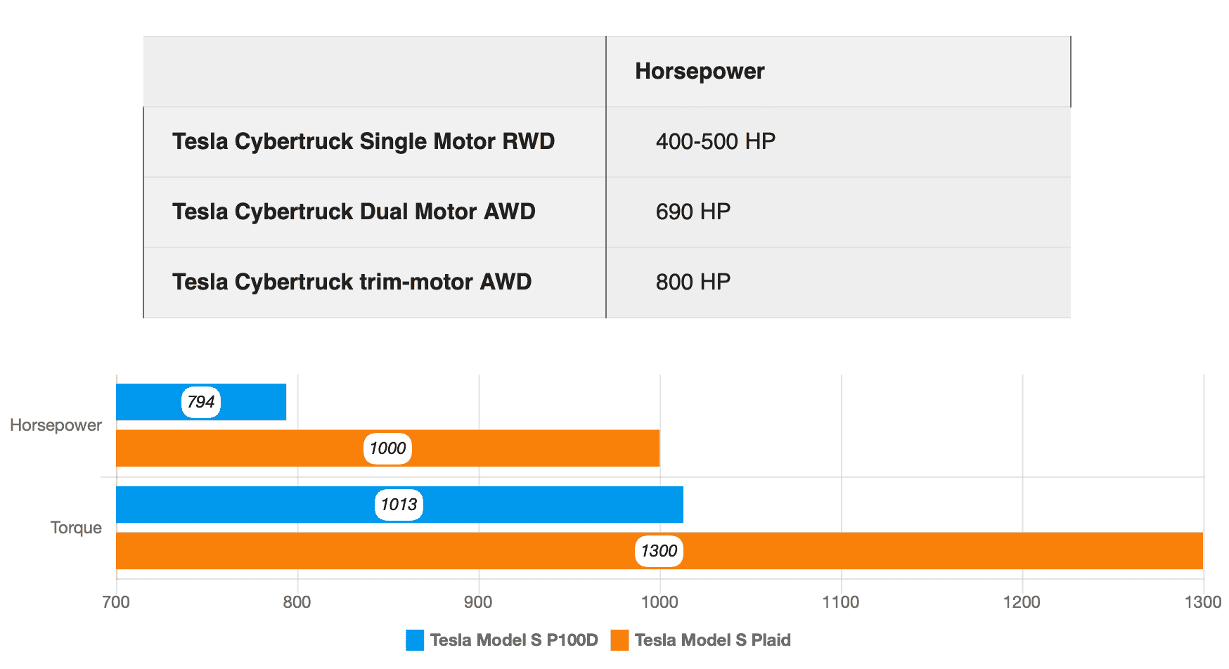

The HP and torque ratings of the popular Dual Motor version are EXTREMELY impressive according to a Top Speed article;
The mid-range model will be a dual-motor AWD truck. It will deliver at least 300 miles of range, it will hit 60 mph in 4.5 seconds and tow up to 10,000 pounds.
Motor Trend notes that the dual-motor version will be powered by Tesla's new Raven drivetrain, which will pair the rear motor from the Model S Performance and the rear unit from the Model 3 Performance.
Both, of course, re-tuned for the truck. The source estimates total output at around 690 horsepower and 824 pound-feet of torque.“
It's pretty simple to figure out torque and horsepower from just the 0 - 60 spec if we assume
1)Acceleration from 0 - 60 is uniform
2)The drive train output is torque limited from 0 - 60
3)The drive train is power limited above 60.
4)The truck weighs 2700 kg (5940 lbs)
5)The wheel radius is 0.6 m (23.6")
60 mph is 26.82 m/s
Acceleration to 26.82 m/s in 4.5 sec is 5.96 m/s^2 (0.61g).
F = m*a = 2700*5.96 = 16092 N of thrust is required
This is equivalent to a torque of 16092*0.6 = 9655.2 N-m equivalent to 7121 ft-lb. (Note that this is at wheel speed of 426.5 rpm. If the gearing is 10:1 that would be 7121 ft-lb at motor speed of 4265 rpm)
P = m*a*v = 2700*5.96*26.82/1000 = 431.6 kW = 578.8 HP
To haul 10,000 pounds up a 10% grade at 60 mph (no acceleration) requires
P = m*g*v/10 = (10000/2.2 + 2700)*9.8*26.8*0.1/1000 = 190.3 kW, only third of what is available.
The numbers for the TriMotor are even more impressive.
ajdelange
A. J.
Dec 8, 2019
3,213
3,405
Virginia/Quebec
EE (Retired)
All you have to do is stick 2.9 sec instead of 4.5 and 14000/2.2 instead of 10000/2.2 into the formulas an imagining will turn in to knowing (at the estimate level).
