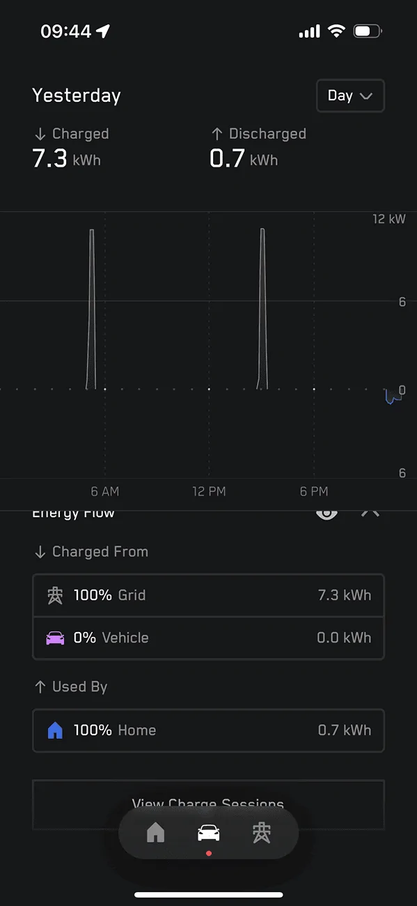

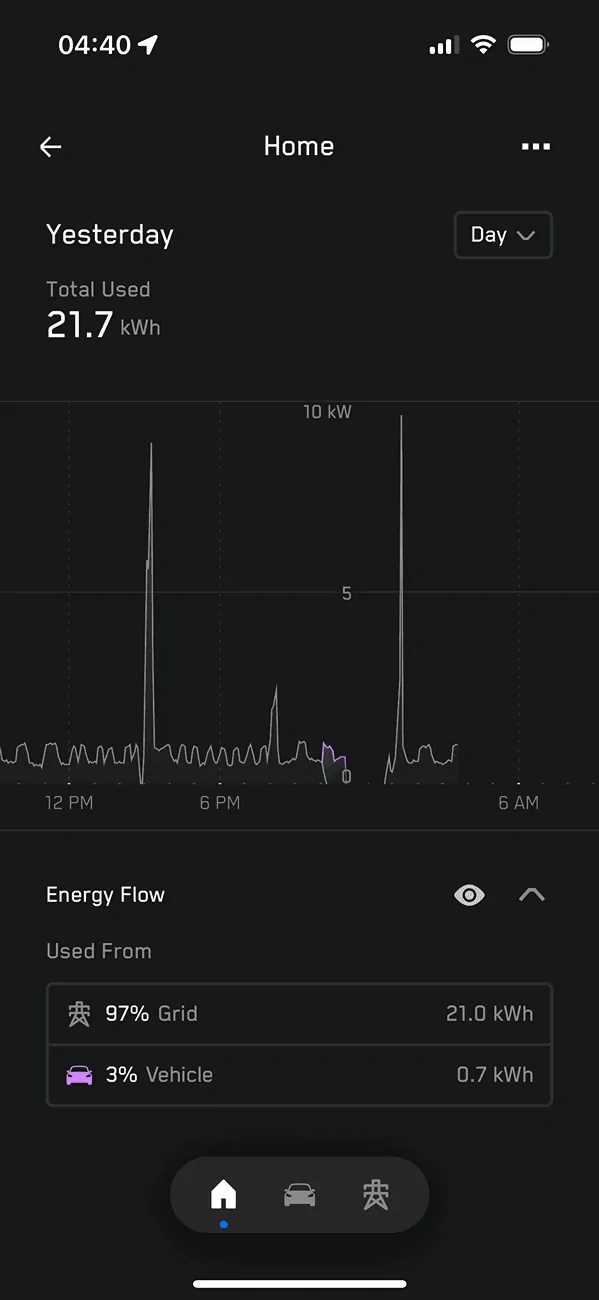

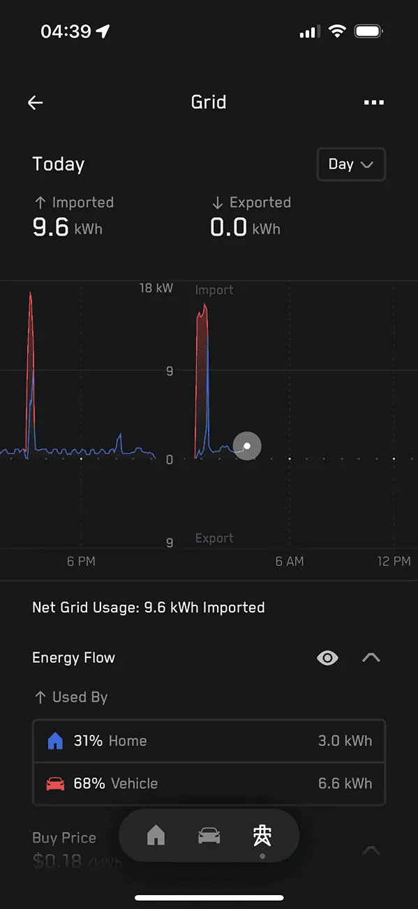

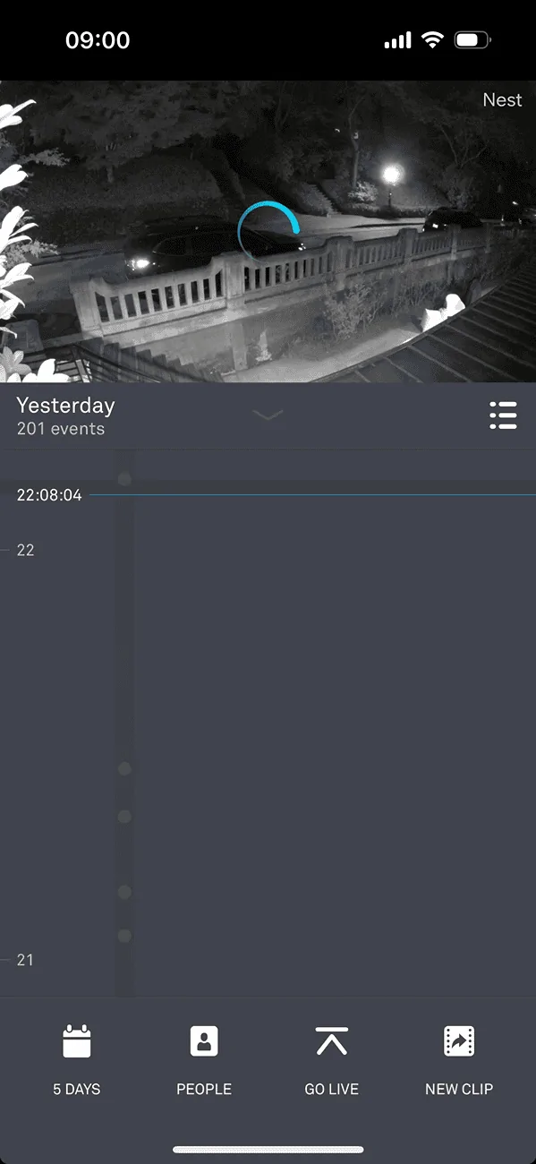

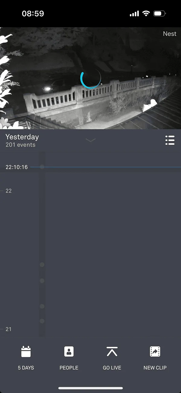

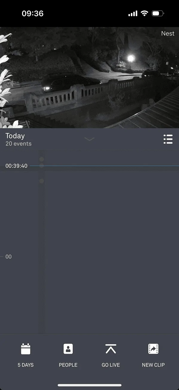

Well It finally happened. Grid power went out about 22:08:04 on 8/15 , the PowerShare activated backup power to the house at 22:10:16 (within 2min and 12 seconds). CT was plugged to the charger and at about 80% charged.
While on backup power, the house used about 0.7kW during the outage. It was middle of the night , so very low power was needed.

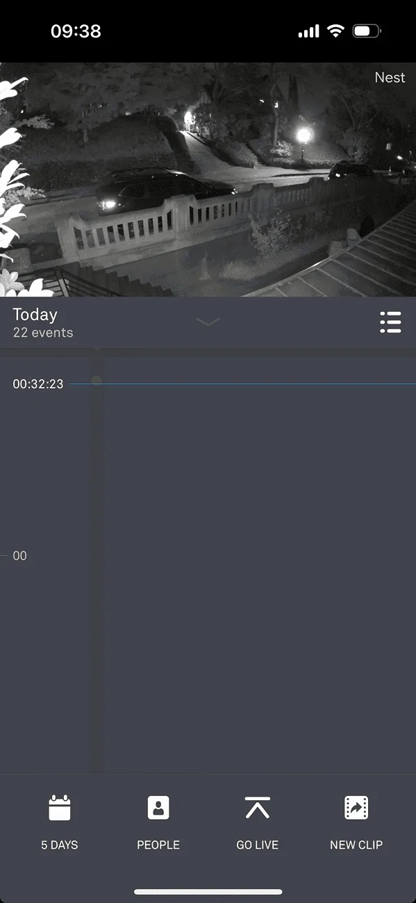

Power came back on at 0:32:23 on 8/15. It took 3V gateway about 5 minutes of wait time to recognize stable power from the grid , at which point it shut off the backup at 0:37:22 and again took about 2 min to reconnect back to the grid power at 0:39:40 (specifically - 2 minutes and 18 seconds).
Great work Tesla team.

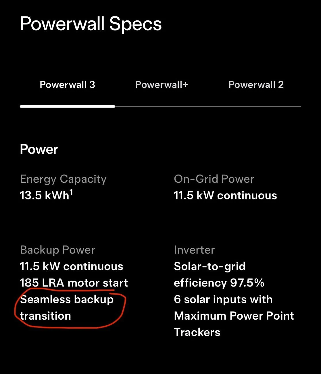

You'll find different behaviors from the Powerwall when the grid is disconnected:
When the Powerwall is full or nearly fully charged (~96%+):
  • If the solar production is greater than the house consumption (ie your system was feeding the grid) the house will disconnect until the PV system turns off which will take 1 to 2 seconds. This is to protect the batteries - with nowhere for the excess solar production to go the system must "hard disconnect".
  • If the solar production is less than or equal to the house consumption (ie you were pulling from the grid) the transfer will be very fast, less than 500ms.
When the Powerwall is not fully charged (<96%):
  • If the solar production minus your home's consumption is greater than the Powerwall's maximum (surge) inverter rating (7kw for each PW2) the house will disconnect until the PV system turns off which will take 1 to 2 seconds. This is to protect the inverters - they cannot accept more than 7kw each for 10s (as per the spec sheet) and will shut down momentarily to protect themselves.
  • If the your home's consumption minus solar production is greater than the Powerwall's maximum (surge) inverter rating (7kw for each PW2) the house will disconnect until the PV system turns off which will take 1 to 2 seconds. This is to protect the inverters - they cannot provide more than 7kw each for 10s (as per the spec sheet) and will shut down momentarily to protect themselves.
  • If the solar production minus your home's consumption is less than the Powerwall's maximum inverter rating the transfer will be very fast, less than 500ms

Wow, thank you for that great explanation.
Powerwall is usually near instantaneous but last week we had a brief outage (rare in summer for us) and I wondered why the lights went off and I lost the router for two seconds. Now I know - it was the middle of the day so the solar panels were going full tilt and needed to shut down first.
Much appreciated!
