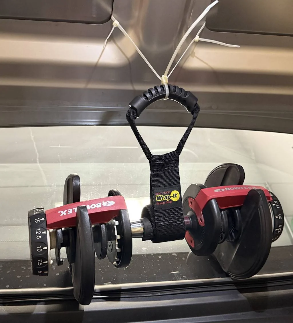

So, I did some testing tonight because I'm impatient. Here are my results of my redneck testing with some quick accessories i had on hand:
✅ - 15lbs opens and closes just fine.
❌ - 20lbs opens fine but pulls the frunk back closed. (keep in mind it was suspended weight which may act differently from secured and distributed weight) however it's probably the upper limit regardless.
I hope this helps anyone deciding if they want to purchase these.

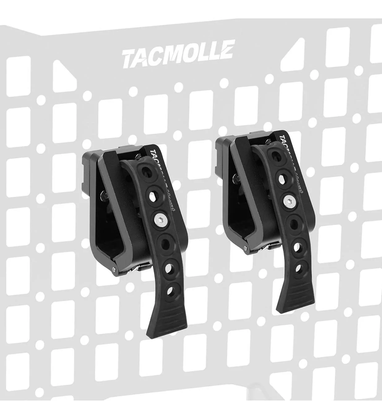

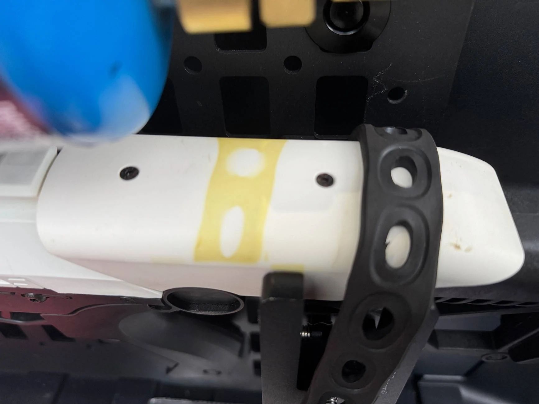

@ill1cit used these for a custom frunk Molle not-a-flamethrower mount. The rubber strap caused some yellowing on mine though.
TacMolle Gun Rack

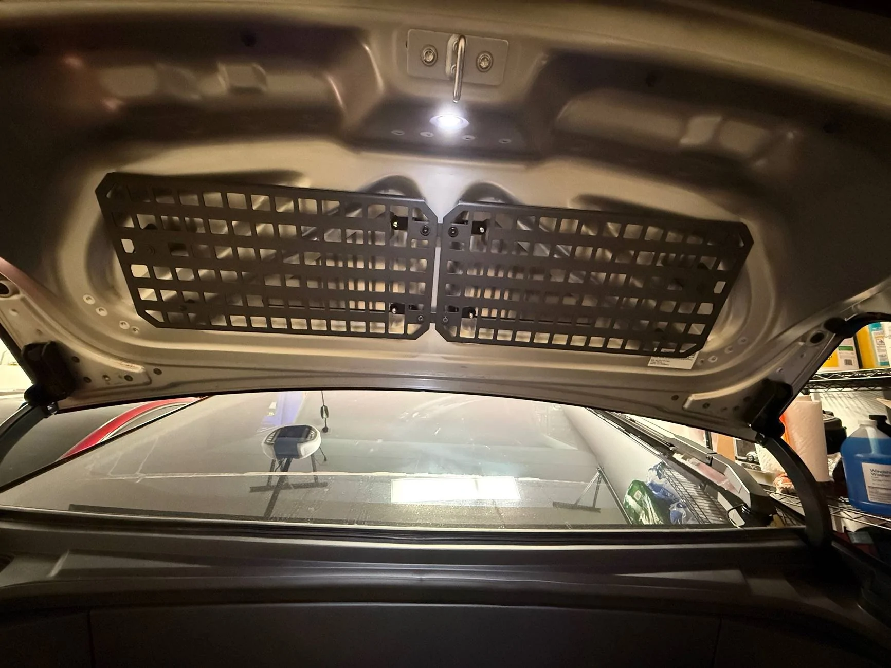

Installed the molle panels tonight. Was quick and easy but needed the video from the product page to show how to mount the single bracket. Didn’t realize that one went over the hole. Could have mentioned that on the install sheet.
My thoughts: Overall good quality, i like that it came packed with an extra bolt, washer and nut in case you lose one. Sturdy quality metal and brackets. I wish it had lock washers as well to make sure the nut doesn’t rattle loose from driving. I wish you also sold the rubber mounts on the site also to make it a one stop buy.

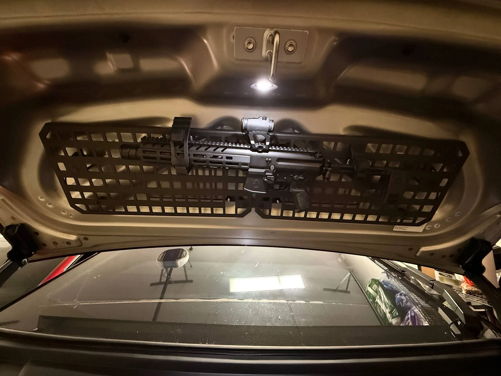

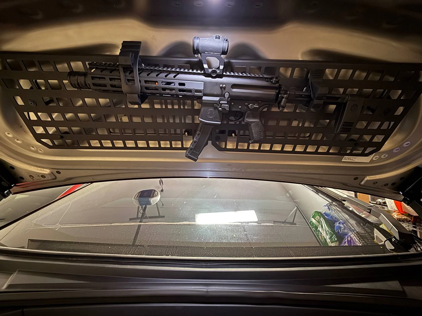

i hope it’s ok to post these and no hippie liberals get thier tampons stuck in their ass.
In case you were wondering… 🧐, it’ll hold it unloaded, open and close the frunk fine. It stays open no problem.
However when fully loaded, it’ll open and close but after it opens it’s just heavy enough to trigger an auto close, so this build as i have it, is literally a few ounces too heavy. If i unloaded a half mag it’ll probably be fine.
