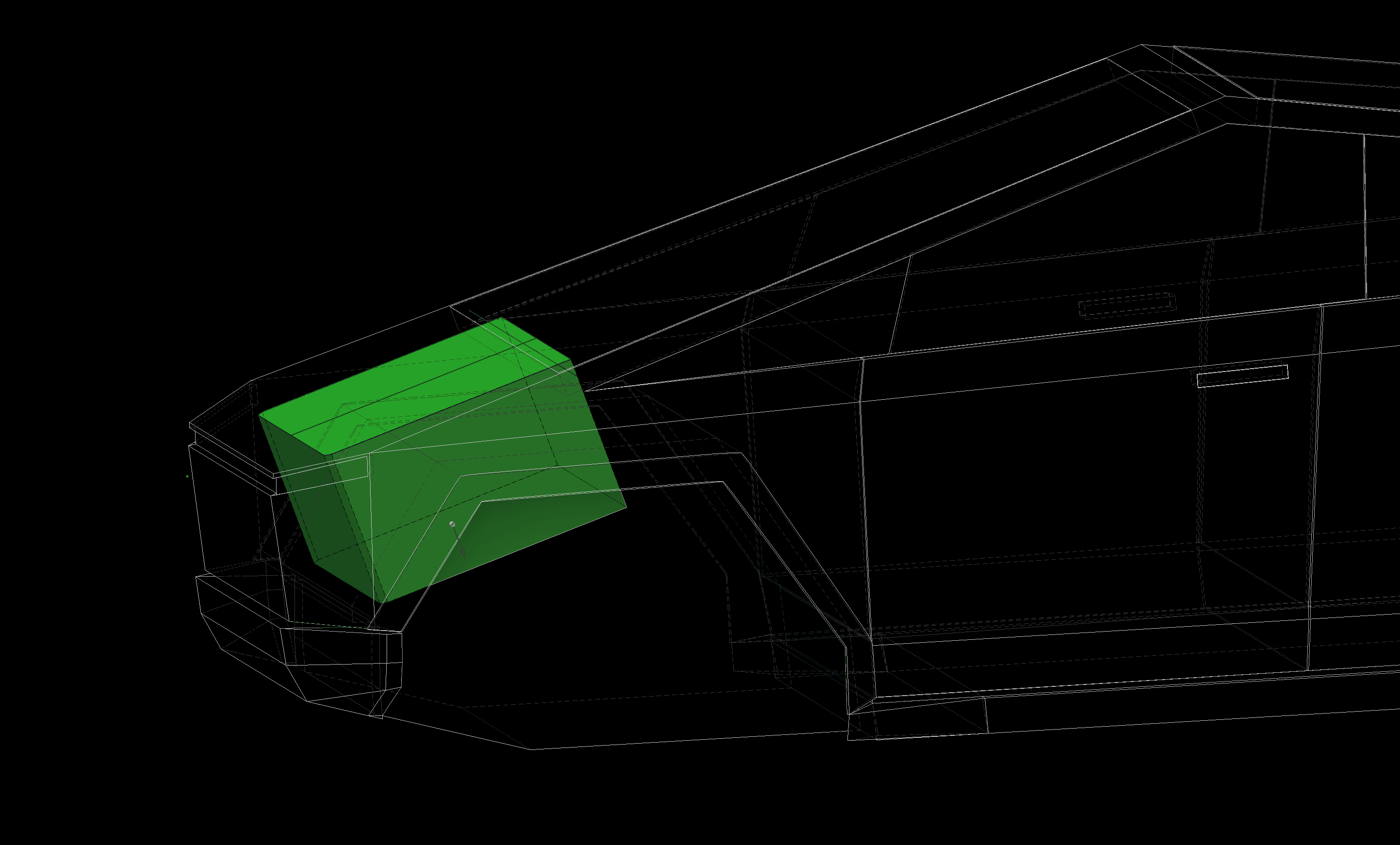

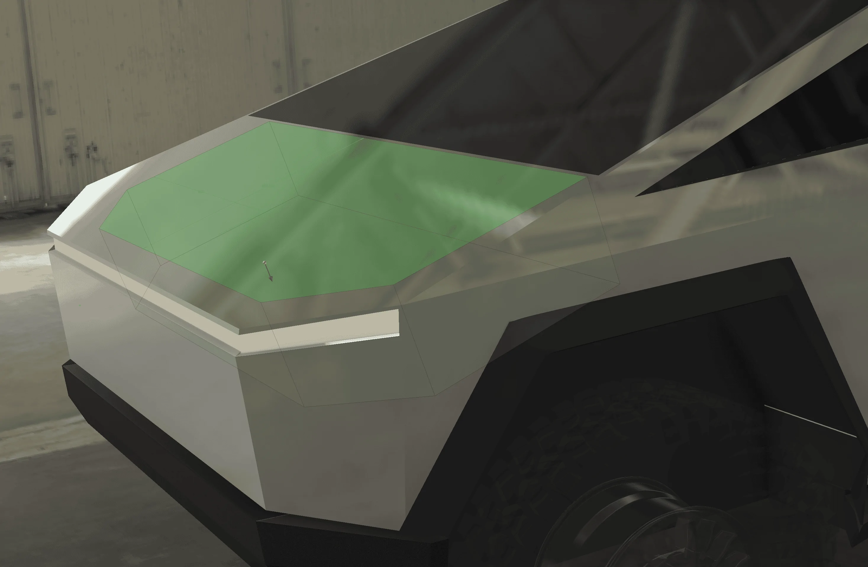

There has been a few conversations about the CT frunk. I have made a few renders using my CAD drawing to get an idea of how it might be dimensioned. One thing I'd like to see is that the front grill will lift with the hood, like the F150 Lightning, which will make for a lower loading height.
Tesla Cybertruck FRUNK on the Cybertruck? CT Frunk Wide 280l
Thats about 300l but very shallow.
Tesla Cybertruck FRUNK on the Cybertruck? CT Frunk 400l
This is about 400l in volume, or the same size as the Lightning, just to give you an idea.

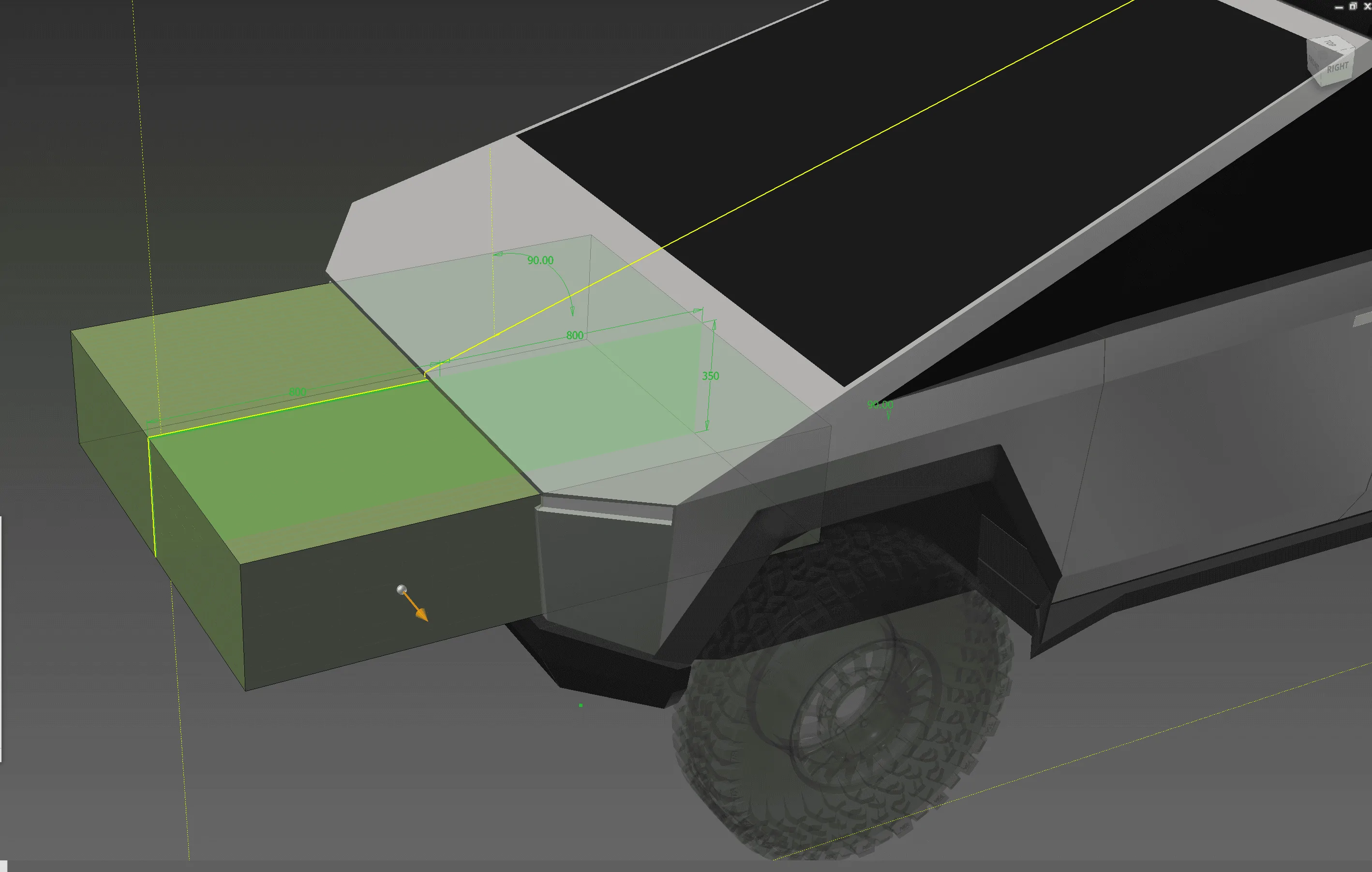

Note that the CT has a massive interior dashboard, because the slope of the windscreen, which means it might have a short frunk hood, but still has a lot of internal volume. We also thought a drawer version would be possible:
Tesla Cybertruck FRUNK on the Cybertruck? Frunk Drawer 1

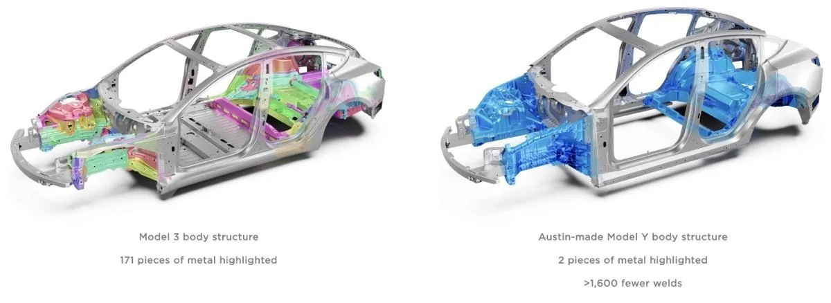

The lifting front grill will work just as well as the side impact protection the the opening side doors that get you inside the vehicle. On impact the grill is compressed into the frame, just like the the doors are compressed into the cabin frame. In fact the MY does the exact same thing with the front cast, they leave the middle "soft" intentionally, with minimal sections across it to protect ingress.
Tesla Cybertruck FRUNK on the Cybertruck? t%2Fuploads%2F2022%2F04%2Fmodel-y-front-cast-texas
As for the bumper height, which is the floor loading height on the Lightning, they are about the same between the Lightning and the CT:
Tesla Cybertruck FRUNK on the Cybertruck? ?u=https%3A%2F%2Ftse2.mm.bing.net%2Fth%3Fid%3DOIP
Yes the top of the grill is lower on the CT, but the CT is still some 8-10" higher than the Lightning loading height without a opening grill. Note the interior of the CT is generally lower as it only has a structural pack and not a ladder frame etc.

The drawer design would still have a top opening frunk hood, so you could load the frunk without pulling out the drawer in tight spaces. If the hood did not open, you would loose about 70l of storage space directly under the hood. Technically, if there is a opening grill, you can still have a drawer as an aftermarket accessory as well, but the main intention of a factory drawer is to allow for easy access to the empty volume underneath the huge CT dashboard and utilize that for outside accessible storage.
It would be ideal place for an outside camp kitchen, or setting up a workbench with all the power/service tools in one place for trades. With that the bed would be free to be used for materials, or toys. I'm also hoping the front interior seats are on rails that are mounted on the floor itself, rather than on a hob, this together with the rear foldup seats (as seen in the release pics) would allow for enough space to sleep on the rear cab floor.
