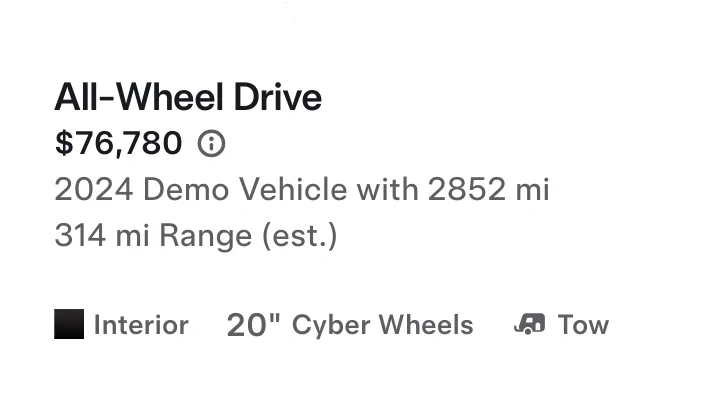

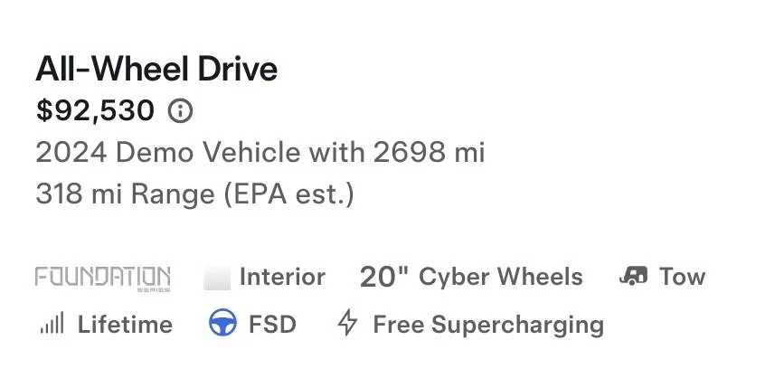

Foundation isn't 6% more efficient
Please post screenshots of the two vehicles you are comparing.
FS AWD AT: 318
Tesla Cybertruck FS AWD Dual Motor - Really Getting 20 Mi More Range? SmartSelect_20250331_114706_Firefox
AWD AT: 314
Tesla Cybertruck FS AWD Dual Motor - Really Getting 20 Mi More Range? SmartSelect_20250331_114723_Firefox
AWD AS: 325
Tesla Cybertruck FS AWD Dual Motor - Really Getting 20 Mi More Range? SmartSelect_20250331_114741_Firefox

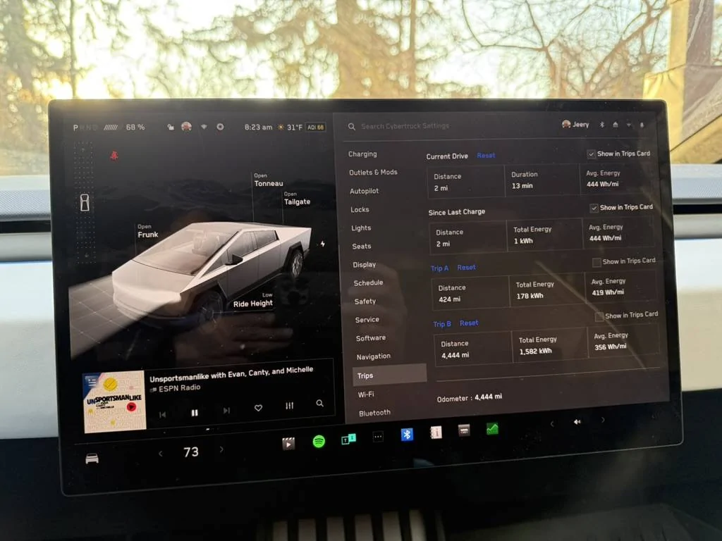

EPA numbers get changed periodically, don't rely on them for anything definitive.
My real-world efficiency with my AWD is 3 mi/kwh in mild/hot conditions and about 10-20% less in winter. That's on all-terrains, mostly without the wheel covers (since I didn't have them) over nearly 10 months and 6,000 miles in the Northeast.
This was a few months ago, Trip B was winter, Trip A is basically lifetime.
Tesla Cybertruck FS AWD Dual Motor - Really Getting 20 Mi More Range? 1743437871993-4e

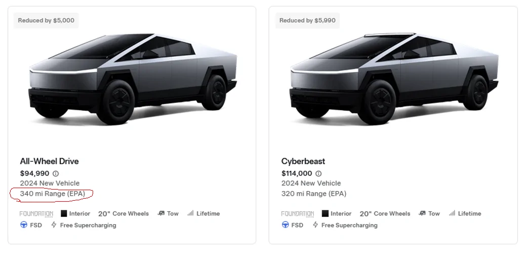

Tesla Cybertruck FS AWD Dual Motor - Really Getting 20 Mi More Range? zimage9817
AWD Foundation with CORE wheels is advertised as 340mi Range (EPA)
Thanks for posting this, it's what I'm referring to.
@mongo see above.
@carsly - Definitely agree with not trusting EPA, but that's why I run my calculations. I usually deduct 15% for cold weather if the EV has a heat pump or 25% if it doesn't. Then I tend to drive mostly highway between 70-80mph so that knocks off another 15%ish. Then I have to knock out the top and bottom bands for charge buffers, so I consider about 70% of the battery pack as useable.

I think I'm over thinking this. At the end of the day it's 10-15mi difference no matter how you cut it.
With what they are STILL charging for the Foundation series, that thing had better get 340 miles of range. Seems odd that the NF and FS have such a range gap with the same wheels, you would think the EPA range would be updated and they would be the same if they were not truly different.
Some will say 15mi is not much and doesn't matter, but 15mi when you are 12mi from the closest supercharger is a LOT more than -3
Yes, that's sort of what I'm getting at. However, what got my attention was that initially couldn't believe that used CT's were asking $79/80k until I realized the are FS models and being sold with FSD. Then I remembered the range bump. It starts to make a used CT a little more appealing.

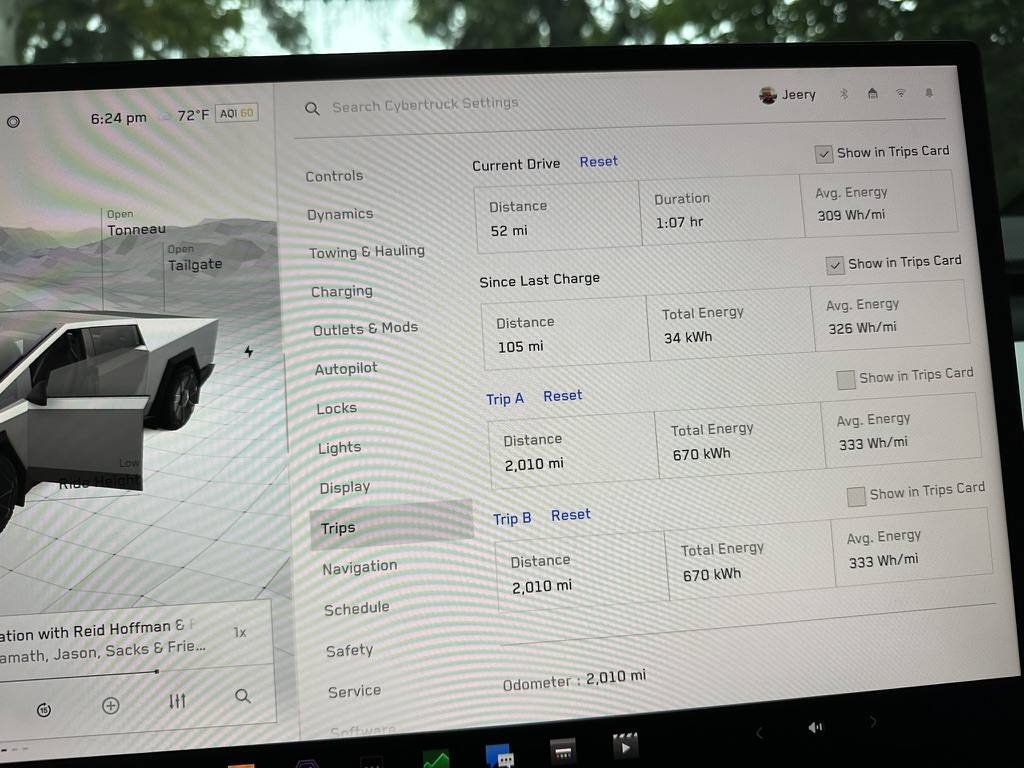

In warm/hot conditions in NJ I regularly average a tick over 3 mi/kwh for over 360 miles of real-world range on all terrains with no wheel covers. Now that I have wheet covers I'm hoping that goes up a bit.
If you're running core wheels with all-seasons I'd hope/expect to see better.
Because data, here were my first 2,000 miles and note the current drive at the top of 52 miles at 309 Wh/mi which is 3.24 mi/kwh. Multiply by 120kwh in the pack (subtracting 3 kwh for buffer and not running dead) and you're at 388 miles real-world. Again, on all-terrains with no wheel covers.

Great info, but I would never come close to those numbers in Texas. Lots of open roads and high speed limits. I also do a lot of cross city/country work related trips.

Your current drive is averaging 46.57 mph based on duration and distance. My beast gets that kind of mileage at lower speeds. I get that kind of range on my ~44-mile commute (6 miles at 45mph speed limit/the rest at 55 mph speed limit) with traffic.
But, on my 13-hour trip last week just got about 400Wh/mi down and back which is ~308 miles of range. I was also going... Well, I wasn't being passed.
Really shows that speed kills range.
