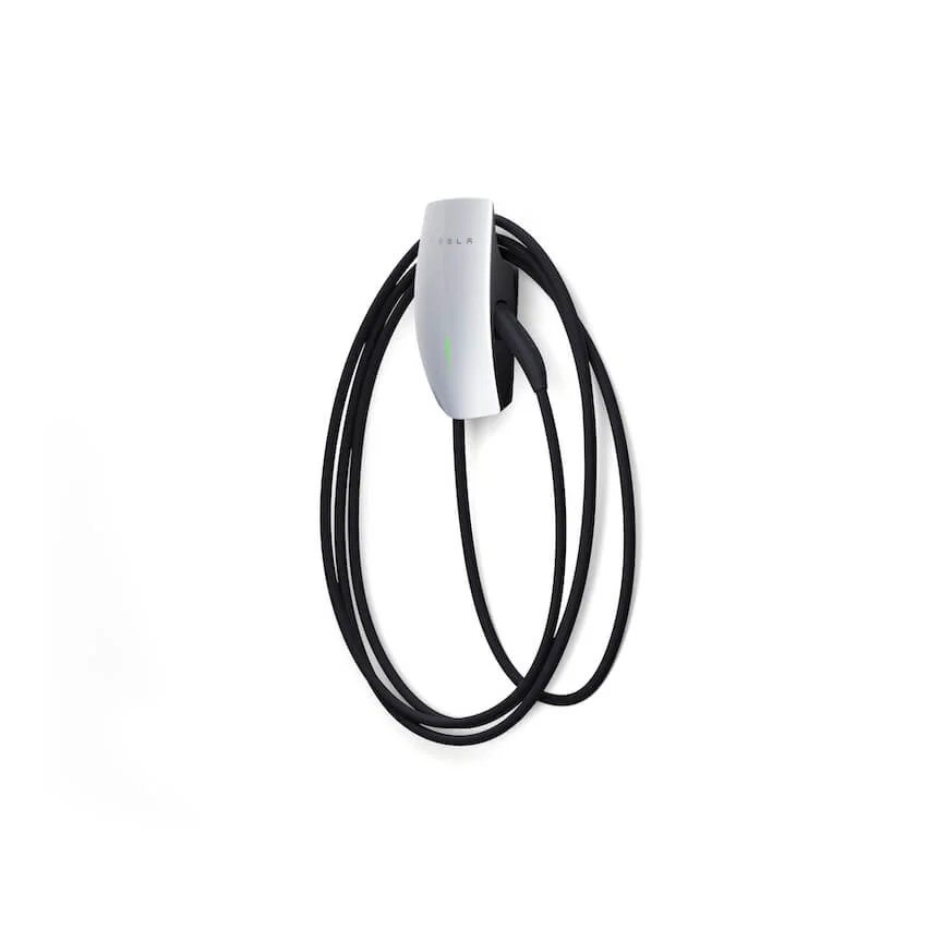

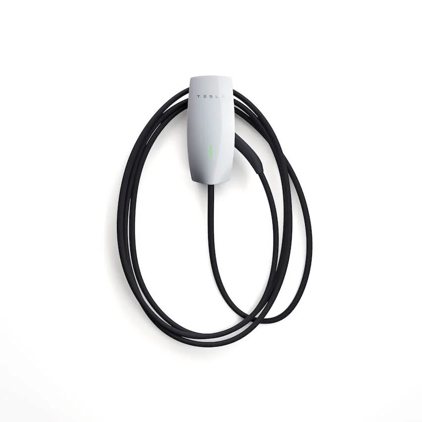

Tesla has just launched a third generation Wall Connector (home charger) yesterday. It features an updated design as well as WiFi function.
The Wall Connector continues to charge at 48 amps but it now features a WiFi connection which will allow for over-the-air (OTA) firmware updates, as well as remote servicing/diagnosing.
The third gen Wall Charger now features a tempered white glass faceplate instead of the previous versions' black and silver faceplates).
Here are the full specs and some photos:
Gen 3 Wall Connector Features
  • Up to 44 miles (77 km) of range per hour of charge
  • Compatible with Model S, Model X and Model 3
  • Up to 11.5 kW / 48 amp output
  • Customizable power levels on a range of circuit breakers
  • Compatible with any home electrical system
  • Wi-Fi connectivity (2.4 GHz 802.11 b/g/n)
  • Approved for indoor and outdoor installation
  • Lightweight 18' (2.6m) cable length
  • Tempered white glass faceplate
