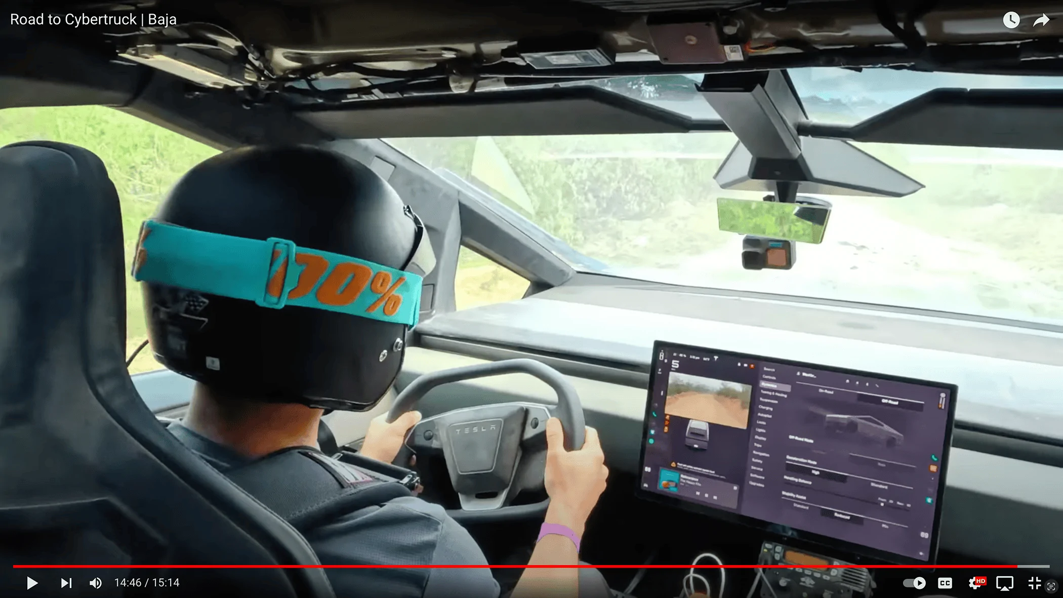

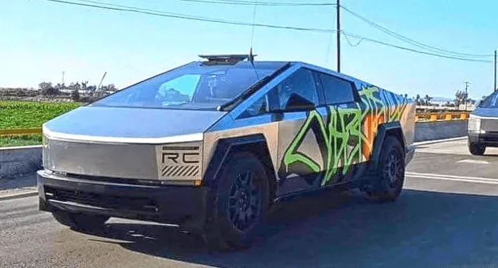

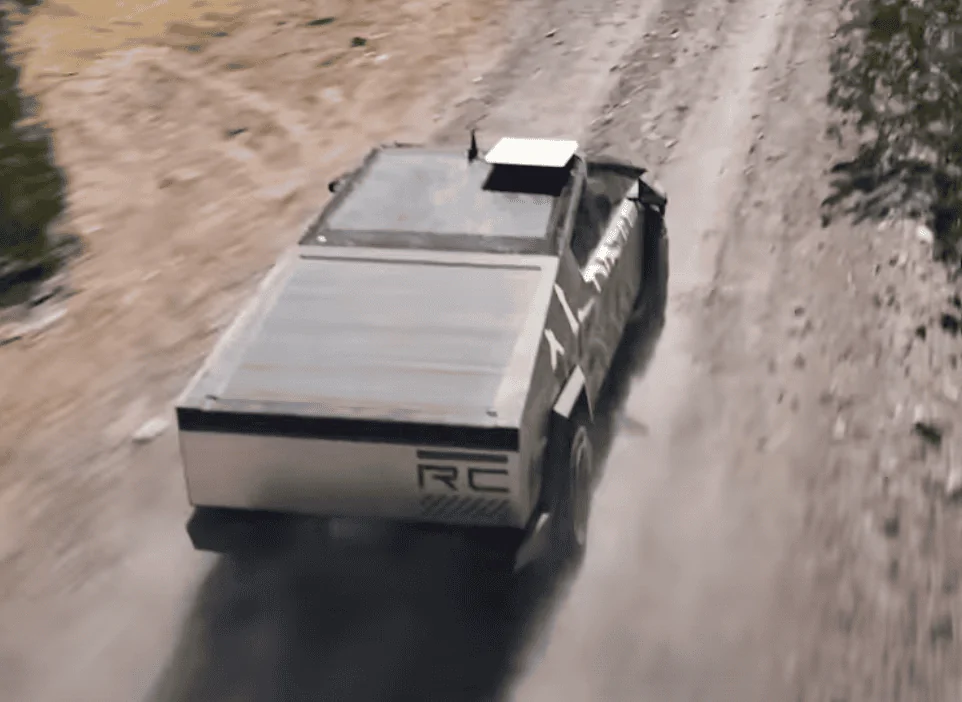

From Testing down in Baja, looks like they mounted the antenna up at the top next to mounting a starling receiving antenna. Maybe the Antenna is suctioned onto the glass roof? On the inside, either a CB or Ham is mounted on the underside of the dash right under the Center Display Screen. Link to Tesla Youtube video below as well as screen shots.
