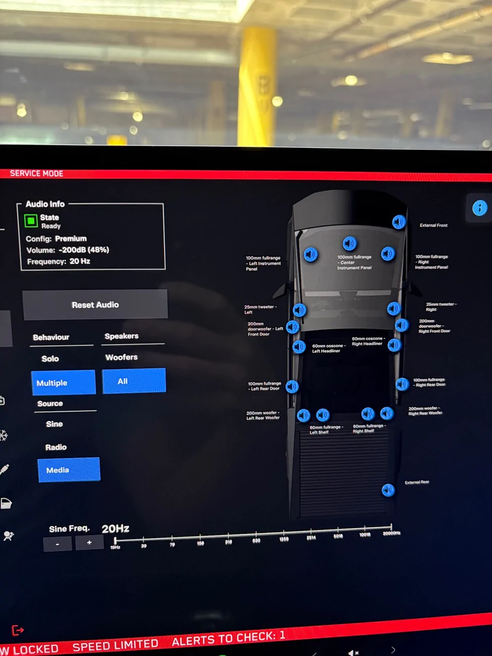

Tesla Cybertruck Hansshow V2 to replace V1 (rear view mirror) IMG_0480
TeslaKen
Ken
Apr 26, 2024
108
1,245
1,698
Overland Park
www.halocybertruck.com
Currently Occupied
The one listed as 25mm tweeter right in the photo above is the one that won't play sound after installing the Hansshow harness, you can use the service menu to try and send sound to it and nothing will happen. Then try the one on the left and it will work just fine for you. (or should)
Thank you for this instructions! Yes indeed my right tweener speaker is not working. Though honestly I can’t really tell the different listening to music with my non musical ears :)
