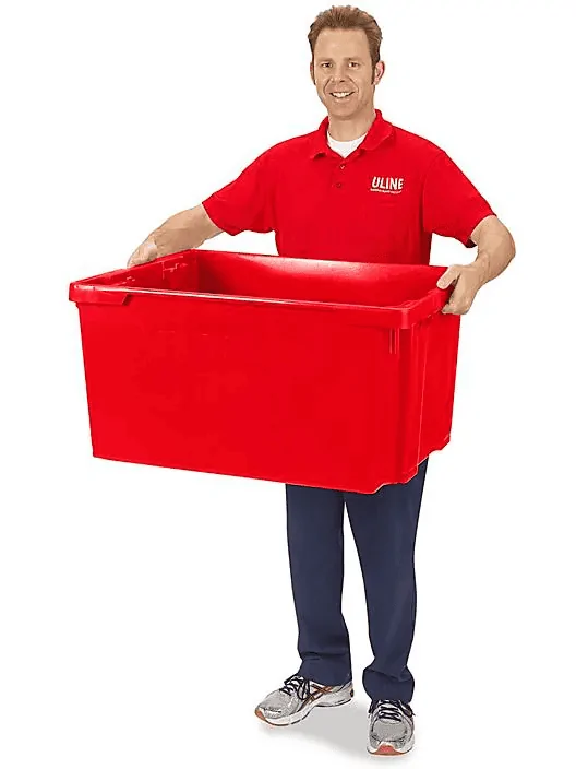

If it's something you do regularly, I would probably place the haz mat jugs in a heavy duty plastic bin with a cover during transport. Like the $10 black and yellow ones at Costco or Home Depot. At least keeps things mostly contained. I would expect that you would normally not be sharing the passenger compartment air with the vault air.
Tesla Cybertruck Hazmat transport 1627434934504
And they are stack-able and nest well with others.
