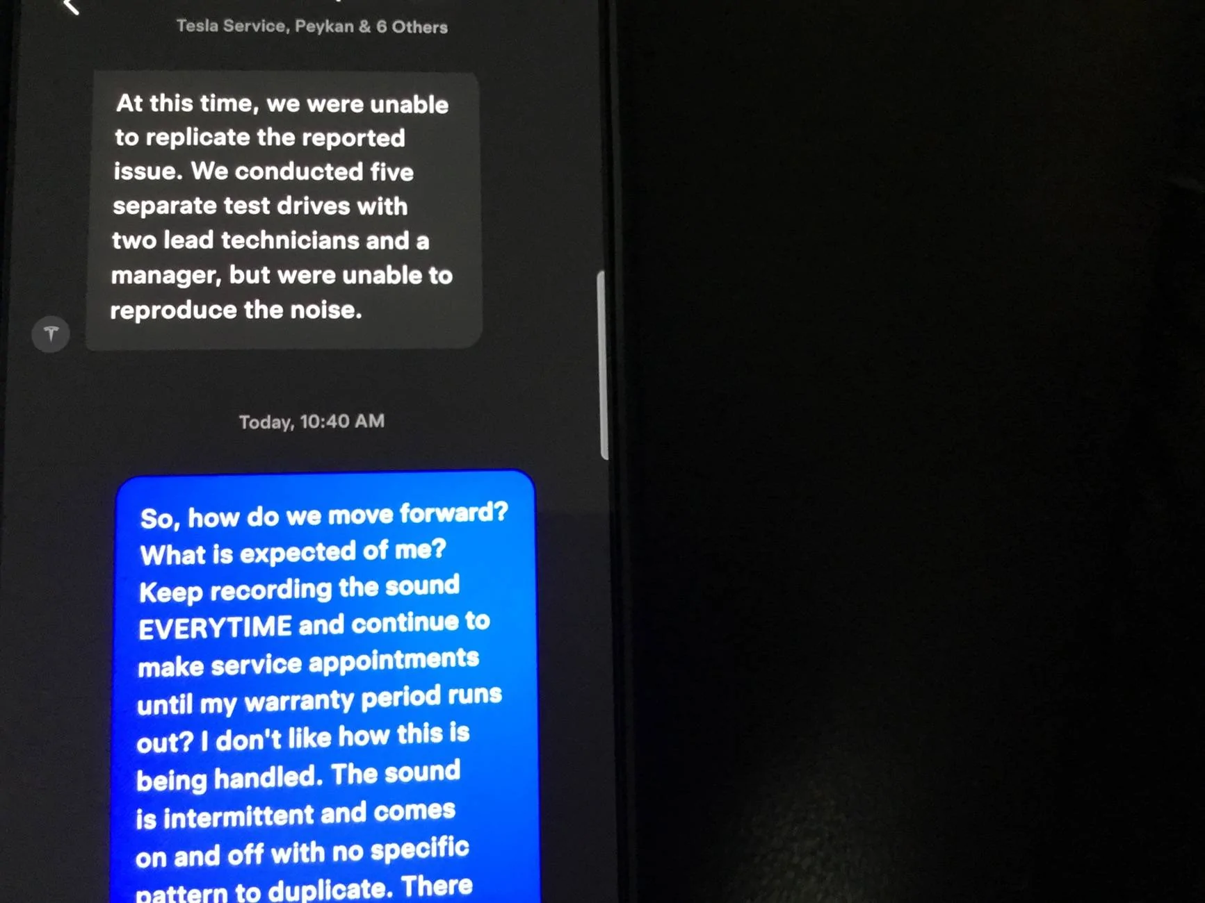

I agree about it being dangerous, Tesla service asked me to record it. My wife refuses to drive in the truck with because when and if the sound starts, she cant tolerate the beeping. It hurts her ear. I have not tapped or messed with any electrical wires. The mount is for a radar detector that is plugged into the power port. I removed the radar detector from the vehicle and placed in the garage. The sound still comes on sporadically.
The truck is at the service center and they want me to come and get it and they stated they can not produce the sound. So, I am stuck. Do they expect me to keep making service appointments every time to have this looked at? Keep in mind the service appointments in my area are almost 3 to 4 weeks wait time. This is ridiculous and unacceptable and I paid a premium for this CyberBeast Foundation Series.
Tesla Cybertruck High Pitched Morse Code Sound imag
