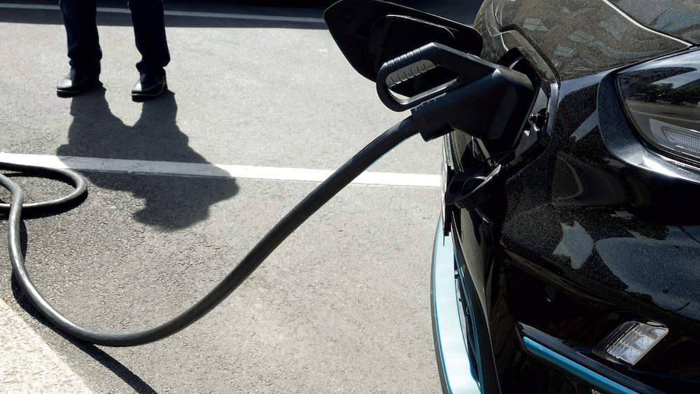

As hinted at above, another benefit of a higher pack voltage is a reduction in the size of the wires needed for the charging cable for a given power output (i.e. charging rate).
This is not as inconsequential as it might seem at first glance, because the charging cable can be surprisingly heavy once you need to deliver more than about 125 A or so (i.e. the v1 CHAdeMO spec).
Using a 350 kW DC fast charger as an example, charging a 350 V (nominal) pack would require 1,000 A, while an 800 V pack would drop that down to around 440 A. To carry 1 kA with an acceptable temperature rise would require wires of at least the 750 MCM size (750,000 circular mils, or 380 mm2 in area), each weighing about 3.7 kg / m (or 2.7 # / ft).
A typical charging cable of 5 m length would end up weighing at least 37 kg (~81 #). Hence, going to the trouble of liquid-cooling the wire to get away with a smaller gauge starts to seem eminently reasonable.
However, the 440 A needed to achieve the same power level with the 800 V pack could be delivered with 4/0 wires (about 107 mm2 in area) that weigh about 1.2 kg / m (or 0.82 # / ft) each, so a 5 m cable would then weigh about 12 kg (~27 #).
Even a 12 kg / 27 # cable will be on the unwieldy side—a 37 kg / 81 # would be about as manageable as a live anaconda! Now it is true that the wires for the higher pack voltage cable will need to have thicker insulation—there is actually a step change in most safety agency requirements at 600 V, in fact—but the relative impact here is minuscule, as the insulation is typically just a few mm in thickness, and the materials used—PVC, EPDM, etc.—are about 1/8th the density of copper.
