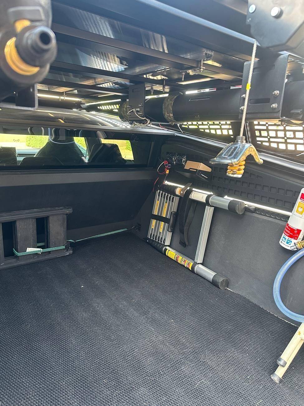

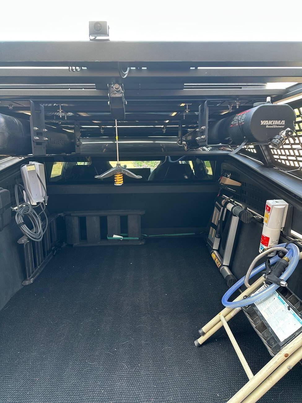

Has anyone set up a camping electric water heater for shower/general use .please share your ideas
CT_AZ_4x4's RoadShower Components for Cybertruck Hot Water Delivery System
Wash dishes, clothes, shoes, boots, dirty dogs, dirty children, take a shower, even possibly use the Yakima RoadShower as a heat source like some do with hot water bottles. Put it in your Roof Top Tent and have heat! Do all the amazing stuff that you have been doing with your awesome Cybertruck, just better! And you’ll only use about 200 watts an hour or so, depending on the heating element that you choose!
All of the parts needed are listed below including simple step-by-step instructions.
The RoadShower has a few quick-connects. One is a shower head and the other is a spray nozzle. I suggest buying both. The shower attachment is separate from the RoadShower unit itself but worth it IMHO. The RoadShower has a Shraeder valve that lets you pressurize the tank with a bike or tire pump. It also has a pressure relief valve that pops around 55 PSI. It has 2 connection points for 1/2 NPT. One of these will be where you add a heating element using an adaptor. The other is for your water delivery point / water hose / shower head. Enjoy, fellow Cybertruck nuts!
Yakima RoadShower Aluminum Canister / Delivery System
https://www.rei.com/product/191518/yakima-roadshower-portable-shower-4-gal
$479 at REI (or more for larger than 4 gallon-sized)
Threaded 36-48 volt DC 200 or 400 Watt Heating Element M14 Threaded Stainless Steel
https://www.amazon.com/dp/B0BJZ3PNFW?ref_=pe_386300_442618370_TE_sc_as_ri_0&th=1
$39 at Amazon
1/2 Inch NPT Male to Metric M14 M14.1.5 Female Brass Adaptor
https://www.ebay.com/itm/162362536500
$13 at Fittings Space at Ebay
(1) Tie into your roof accessory 48 volt and run that where you will be installing your water heater. (I like using XT connectors for their ubiquity and ease of connection/disconnect.)
(2) Thread the heating element into the M14 female adaptor. Hand tighten FIRMLY. There is a gasket and it should be firmly seated against the adaptor.
(3) Thread the 1/2 inch NPT to Metric adaptor with the heating element already installed into the RoadSHow water canister. Tighten 1/4 turn to 1/2 turn past initial bottom out using a 7/8ths inch wrench.
(4) Tie the pigtail ends of your hot water heating element into your roof accessory 48 volt feed. Use a detachable connector close to the RoadShower to allow for quick disconnect as there is no thermostat in this system.
(5) When you want hot water, turn on your roof accessory 48 volt feed from your awesome truck’s touchscreen! Make sure to monitor the water temperature as there is no thermostat as described. Use the sticker thermometer that comes with the Yakima RoadShower and make sure to test the water before using it so that it doesn’t burn anyone. If it is too hot, add some cold water to the RoadShower until the desired temperature is achieved.
(6) I added a temperature sensor to the exterior of the RoadShower (the canister is aluminum and magnets don’t work) that I purchased through Home Depot and then added a longer strapping wire to fit the circumference of the RoadShower.
https://www.homedepot.com/pep/31950...65877eb60f2ef3ff5c4d9e07d7c380bfede62fd0c21e9
$13 at Home Depot
Tesla Cybertruck Hot Water Delivery System With Yakima RoadShower Components - DIY Writeup Yakama RoadShower with Heating Element Installed
Tesla Cybertruck Hot Water Delivery System With Yakima RoadShower Components - DIY Writeup Water Temp Prior to Roof Accessory 48volt Applied to Heating Element
Tesla Cybertruck Hot Water Delivery System With Yakima RoadShower Components - DIY Writeup Water Temperature 30-40 minutes AFTER Applying 48 volt Roof Accessory Voltage
Tesla Cybertruck Hot Water Delivery System With Yakima RoadShower Components - DIY Writeup Water Temperature after about 75 minutes of roof accessory power applied
I added a thermostat so that my Cybertruck’s water heater shuts off when the water reaches 118 degrees F (47 degrees C).
Tesla Cybertruck Hot Water Delivery System With Yakima RoadShower Components - DIY Writeup IMG_2854
Tesla Cybertruck Hot Water Delivery System With Yakima RoadShower Components - DIY Writeup IMG_2856
