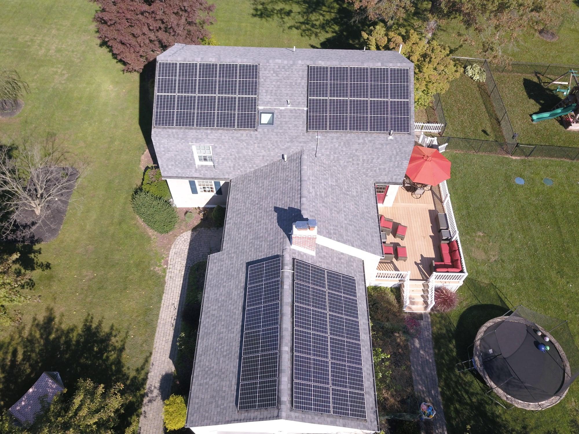

As mentioned we have a 12.35 kW non-Tesla solar system that went live Sept. 2019. We generate 14,000+ kWh annually and earn 14 SREC's which I've been selling at an average of $220 EACH. You can see how the ROI comes quick in this scenario... 100% offset and banking kWh's with my utility 7-8 months a year where we get only a $3.25 customer connection charge monthly, burn up our kWh bank another 2-3 months and get a small bill of $40 or less usually in Dec. to Jan. during our worst solar months. :cool:
Our current setup offsets our home (2,400sq. ft.) and my Model 3 charging for about 10k miles a year. So if and when I swap to the CT I don't expect much of a change in usage, although we still have one ICE, a 21' Telluride that might get swapped for a Kia EV9 if I can convince the wife. šŸ¤ž
