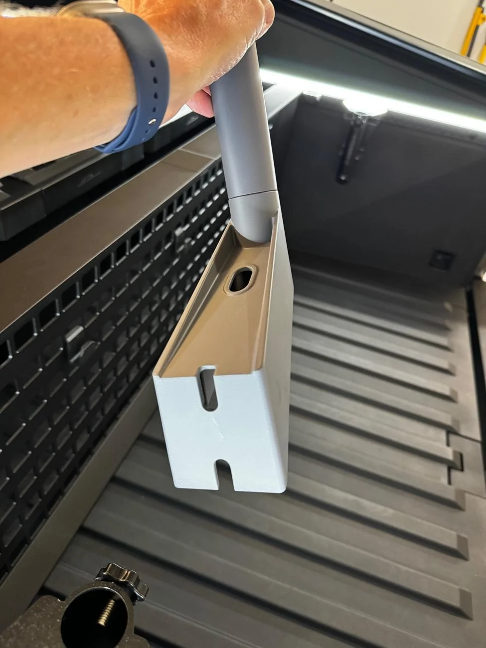

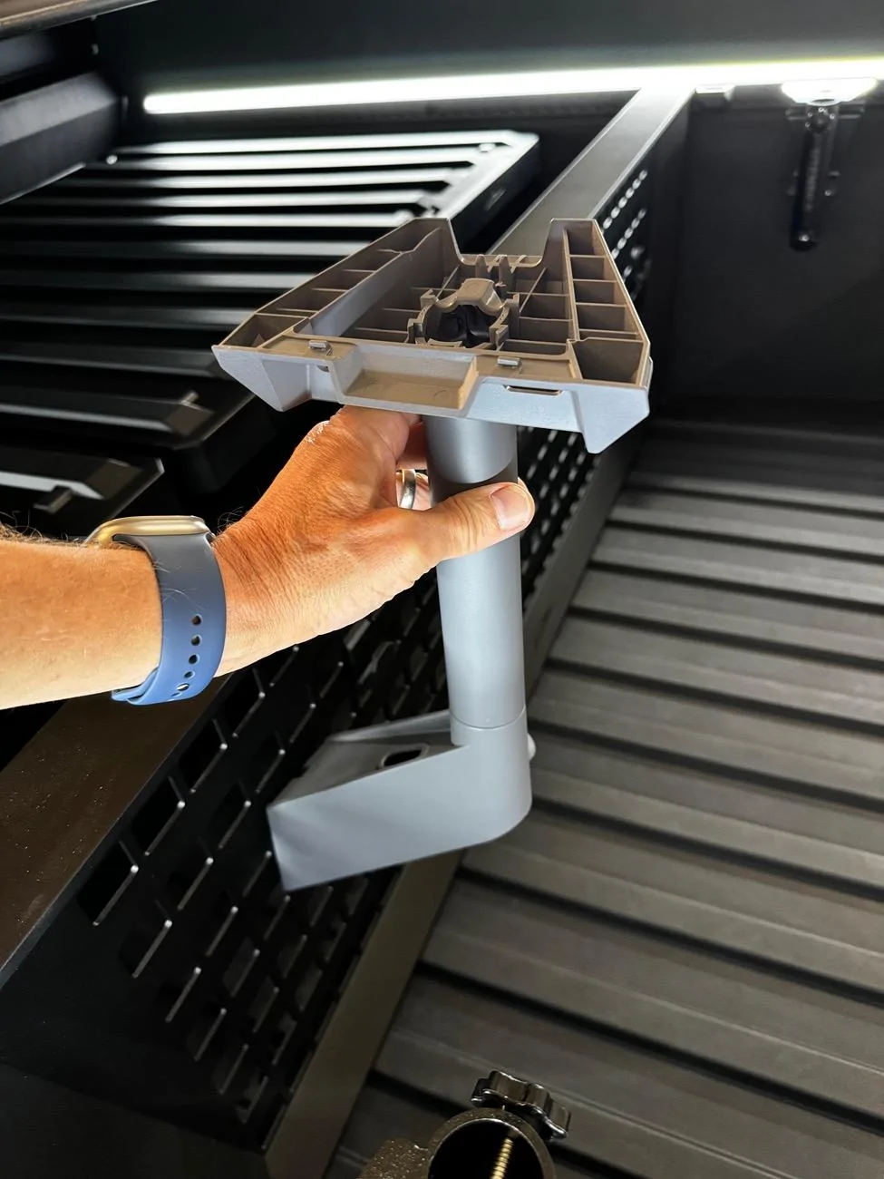

Hi all, I am not at all a handyman. I know there are many on here so thought i could pose a question. I would like to mount my Starlink Mini on the Vault Cargo Divider. It appears would be easy to attach it with the proper screw/bolts and any other items suggested to secure it.
Does anyone have suggestions on what i need to attach it (other then tools, which i have). And do you think would be sturdy enough to highway drive with it attached?

What about using a flagpole mount that goes onto the L-track, the appropriate sized pole and the Starlink mini pole mount?

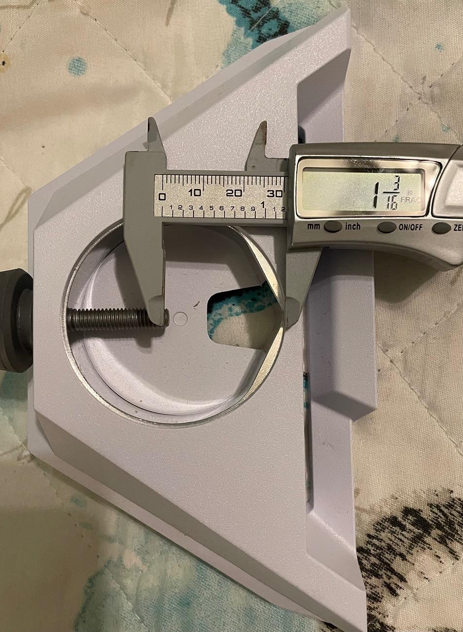

The diameter of the opening of the flagpole mount is too narrow relative to everything associated with the mini. This was what I had planned to do but itā€™s a mismatch.

What sizes are we talking about, itā€™s easy to sleeve up and down to make different diameters work. Other solutions like C-clamps.

Actually a quick Amazon search found one that can accept 1 1/8ā€ diameter flagpoles. I donā€™t know the diameter of that roof mount tube you have but the Starlink pipe mount can accept from 1 3/16ā€ to 2 1/8ā€. You can find aluminum, EMT, or even PVC solutions that would work at a Home Depot.
