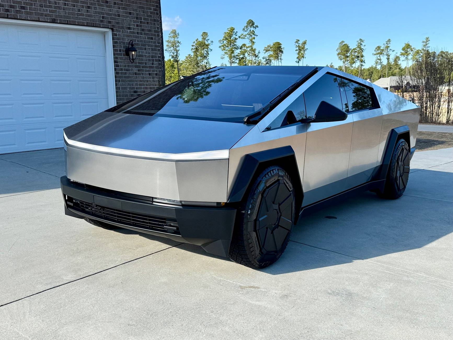

Kudos! The first one I've seen that wasn't wrap that didn't suck in my estimation. That looks great. How much time did it take?
Thanks! I spent an hour or two doing the Bar Keepers and then two hours or so ceramic coating the stainless.
