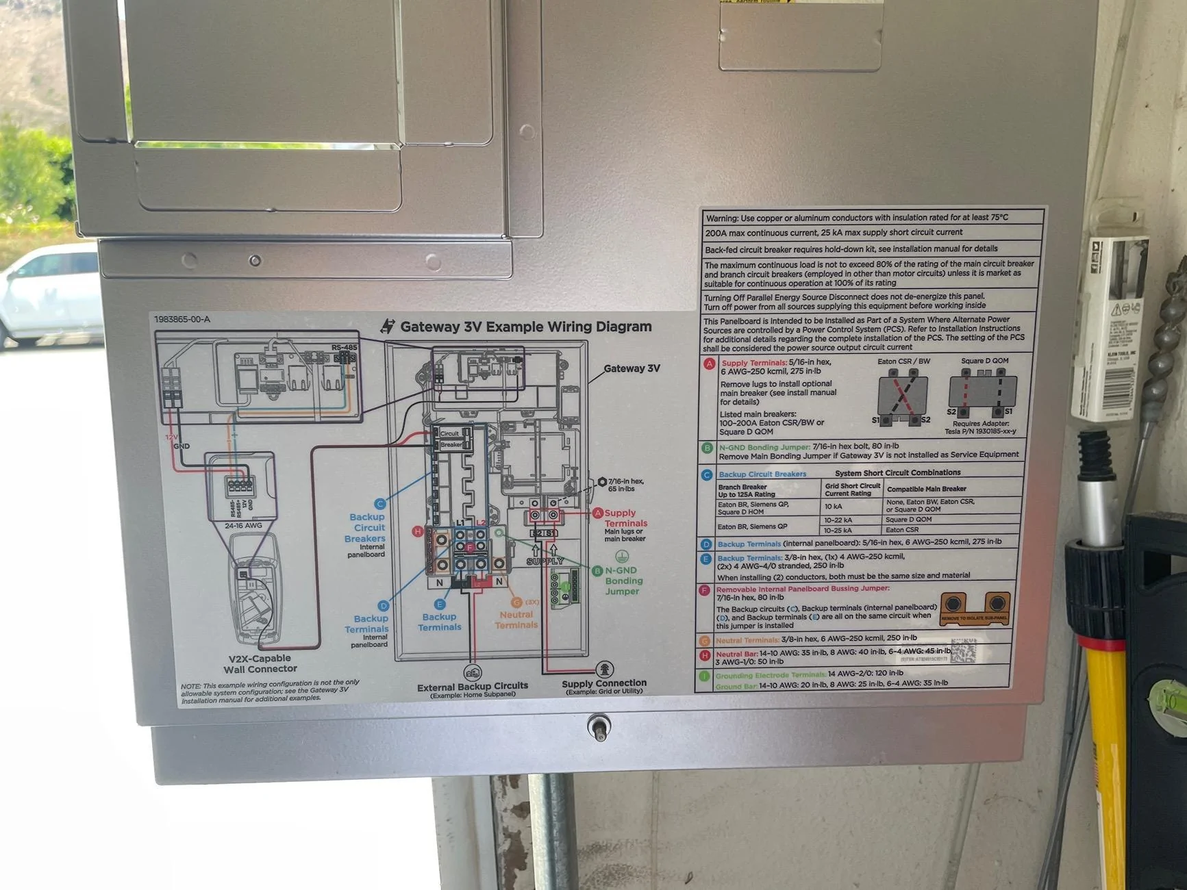

There are 3 distinct installation methods I've seen based on people's posts, in order of lowest to highest costs.
Main Breaker Separation - Main panel becomes sub-panel of gateway.
Light Loads Backup - Gateway is sub-panel of main panel, up to 10 light circuits moved to gateway.
Heavy Loads Backup - Gateway is sub-panel of main panel, mix of light and heavy circuits moved to gateway.
There are (I believe) 10 slots available in the gateway for the 2 load backup options.
There are obviously some technical criteria that would dictate one of the load backup options, but I'm guessing there might also be state or local requirements that influence the configuration as well.
In my case, I have 2 200A panels and most of my high current loads are on the 2nd panel (HVAC, EVSE, Oven, Dryer, etc). My 1st panel contains mostly lights, outlets and such. There's still over 200A worth of breakers in the panel, but my typical whole panel load is 3-5kW.
My install will use the main breaker separation option, inserting the gateway between the main and my 1st panel, so the CT will backup the entirety of the 1st panel. Obviously, the CT could not support the full panel load if I was to intentionally plug in a high current load in every room in the house. That doesn't actually present a problem however, because the CT will automatically shut down powershare if it exceeds 11.5kW (48A). There's nothing technically wrong about a 200A sub-panel being fed through a 60A breaker, if the load could somehow exceed 60A, the breaker to the wall connector would trip, protecting the wiring. It can't actually do that though, since the CT will trip at 48A.

Gateway has an internal breaker panel.
To your question: your electrical service from the power company is likely limited to 200A. So moving 60A to another subpanel doesn't increase capacity on the main panel, same as if you feed that subpanel from a 60A breaker on the main panel.
Tesla Cybertruck How to prevent PowerShare charging other EVs during outage? IMG_1894
