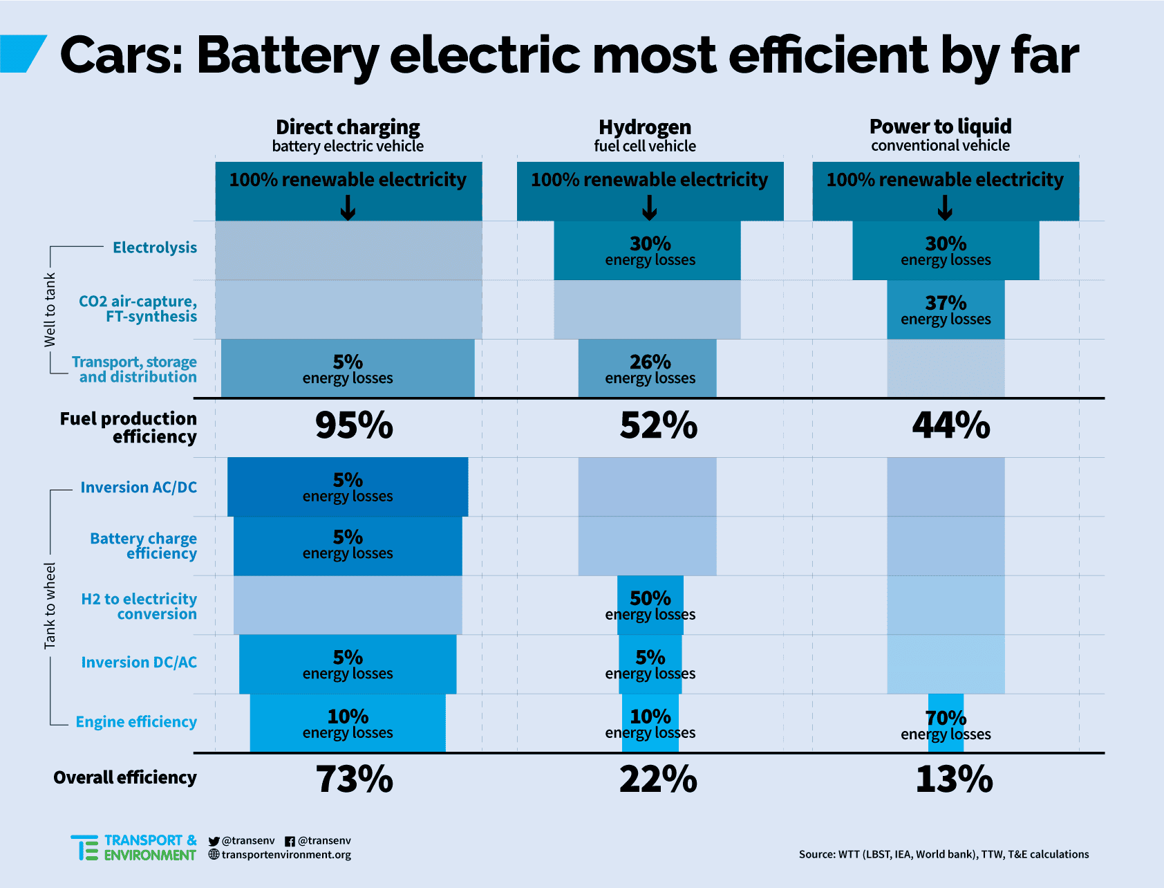

The Inverse article also quoted from a Cleantechnica post that showed the efficiency of different power sources...
Tesla Cybertruck Hydrogen “fool sells” (Nikola Badger) 1592465687916
https://cleantechnica.com/2020/06/10/this-stunning-chart-shows-why-battery-electric-vehicles-win/

This assumes that hydrogen technology will not advance. Look at the chart in No. 1. At the top it shows electrolysis efficiency at 70%. That's not so good. But will it stay at 70%? A company in Israel (it think it is) has laboratory electrolysis cells running 94% (again based on recall) efficient. Next item is transport, Suppose the hydrogen is made at the dispense site (that is, I believe, Nikola's plan). That drops the 26% transportation burden down to the 5% needed to transport the requisite electric power to the site. That is doable today. Fuel cells are relatively inefficient today. Will they always be so? And note that renewable energy is marginally free. The only cost of it, if generated on site are associated with capital and maintenance costs. Will they not continue to decrease? In case the point is missed if the energy is free then who cares if the fuel cell gets warm and heats the planet? That wasted energy would warm the planet just as much were there no solar panel in place to intercept it and use it to electrolyze water into hydrogen. Note that in co-generation plants a fuel cell is used to generate the facility's electricity and the waste heat to warm the building. Suppose that steam were used to spin a turbine connected to a generator?
H2 is, and will be, probably forever, at a disadvantage relative to batteries with respect to efficiency. But hydrogen will always have the advantage in energy density. The Semi is supposed to go 500 miles fully loaded on 1,000 kWh of energy. With current battery technology (250 Wh/kg) that's 4,000 kg of battery (8,800 pounds) which is 11% of the GVW. If we want to double that we would have to double that taking 8,800 lbs away from our payload. The Nilola truck has a 220 lb hydrogen tank and range of 1200 mi. Thus they get 500 miles of additional range at an added weight (and reduction in payload) of 91 lbs. Grinding all the numbers up Nikola expects to be competitive with diesel in cost using today's technology (though their network of hydrogen stations won't be out there for a while).
Thus at the large (industrial) scale it appears that hydrogen does have its place, even with the current state of the art. For automobiles, though, no.

Hydrogen will never be as efficient as electricity for most applications because you are adding steps in there that go from the source to moving the vehicle. And if the electrolysis process were 100% efficient then the total efficiency for hydrogen would be 52% versus 73% efficiency for BEV, still a large gap.

The maximum efficiency out of a fuel cell is the Gibbs energy divided by the enthalpy of formation of water and is about 83%. Similar considerations exist for batteries i.e. you an charge them about 90% efficiently and discharge them at about 90% efficiency for round trip efficiency of around 81%. Now if the H2Pro (that was the group I had in mind) can make hydrogen at 97.4% efficiency and the cell is 83% efficient the round trip efficiency is 0.974*0.83 = 0.80842 i.e. just about the same as a battery. But of course the H2 Pros are still in the lab and the batteries are running up and down the worlds highways. But the real point is that as hydrogen technology advances the relative advantage of BEV wanes. That is, unless BEV efficiency advances faster but I suspect batteries are nearer the thermodynamic limit than fuel cells.
You certainly can't beat the 90 lbs vs 8000 lbs factor in a Class 8 vehicle. Yes, building the plant for an industrial scale operation cost's bucks so they don't do that today and run with hydrogen that is relatively cheap but dirty. Note that hydrogen is currently used industrially at cost savings in transportation. Walmart's warehouses use hydrogen powered fork lifts to move stuff around. What surprises me is that fueling stations exist in these warehouses. I don't know how these are serviced but I think it is by visiting tanker. Thus there is evidently more hydrogen infrastructure than we in the BEV world think there is. The big cost savings with the fork lifts apparently come in charging time (you can't run ICE in an enclosed space such as a warehouse).
In any case hydrogen has gotten to be kind of a joke, deservedly in the automotive sector, but I don't think it is a joke in the industrial sector. The recent going's on with Nikola including investment in them by investment houses like Fisher make me think that we may see hydrogen fueled Class 8 transport on our highways in my lifetime (and I'm an old guy).
