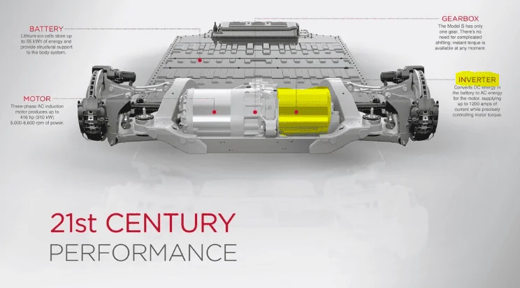

Yeah the inverter in the back looks a lot like another motor.
Tesla Cybertruck Is Elon being very conservative with TRI-motor 0-60 times? Is 2.5 possible? 1592330147525
The model 3 and Y are more integrated into the drive unit now.
So, if the MX does 0-60 in 2.6 seconds, and if the CT weighs the same, why wouldn't it be faster 0-60 if it had an additional motor?
And thanks for the picture. I couldn't find anything other than "Model X has dual motors" on the Tesla site.
