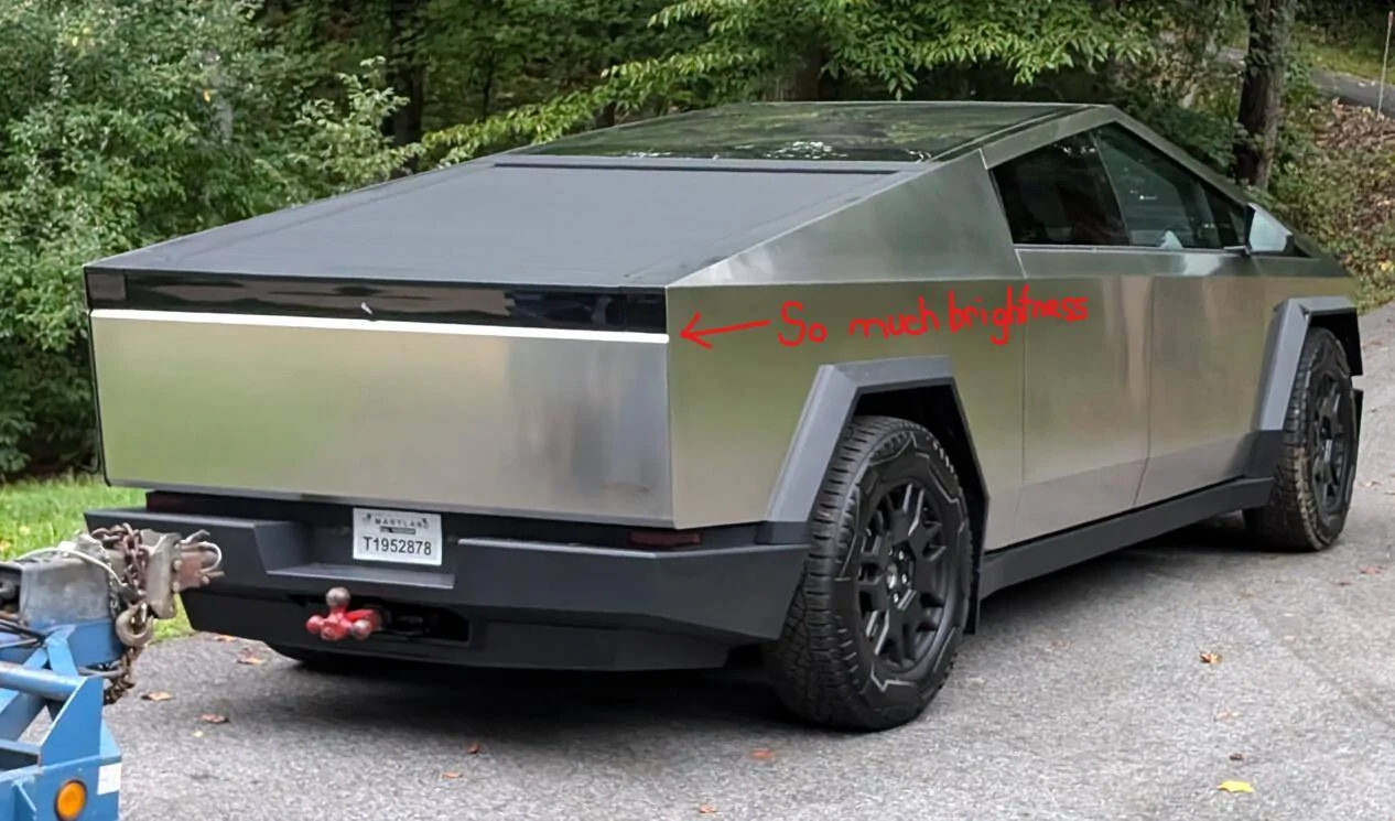

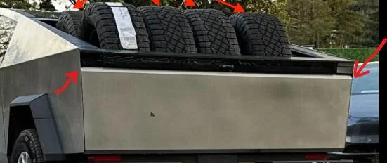

Exactly. Well, it's only the little flat strip just below the camera. If that whole strip was just gloss black (to match the tail light bar), it probably wouldn't be noticeable at all.
Not that it helps, but here's a picture. People like pictures. This is mine. The arrow points at the little flat area that needs to be taped... maybe using the lightbar tape. LOL
Not that it helps, but here's a picture. People like pictures. This isn't mine. The awesome arrows are, though. Well, not the ones pointing at the tires, just the janky ones. My arrows point at the little flat area that needs to be taped... maybe using the lightbar tape. LOL

good point but you really want flat black if you want it to be no reflective for the camera lens.
That's true. Maybe gloss for the entire back and then flat just below the camera. Or at least satin or stealth.
