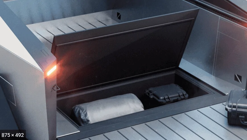

Tesla's after market Plug and Play 4680 option to fit in there ?
Tesla Cybertruck Lightship Energy - Tesla alums launch startup to develop RV travel trailer with electric powertrain 1658283484166
