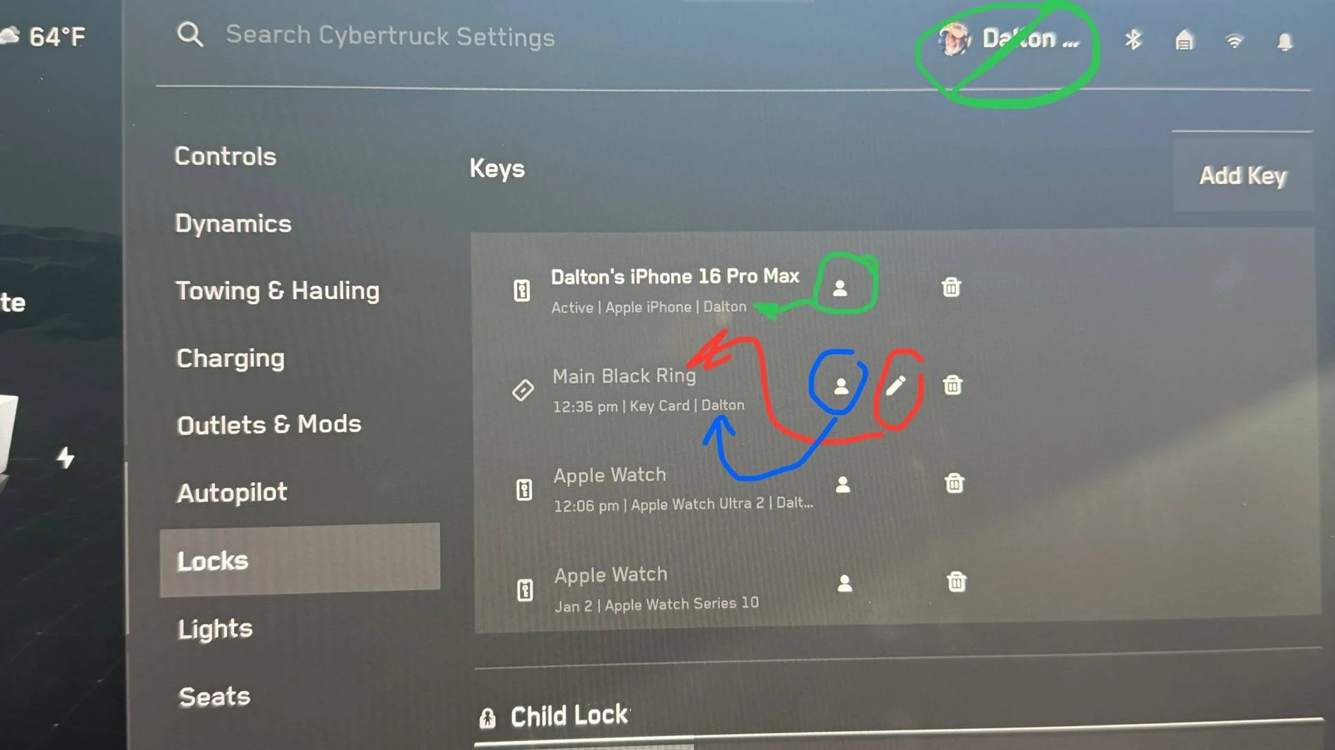

You don’t do this from the app, you do it from the car on the main screen in the “Locks” menu. I did a long drawn-out/detailed description (with pictures) of all of this last week:

Dalton, thanks a bunch. I'm 79 YOA and technically challenged, so most of this CT stuff is way over my head. Anyway, both our phones have the Tesla App and we get the same messages. Individually, each phone automatically opens and locks the CT. However, the driver profile doesn't automatically change based on the phone being used. Both keys and profiles are listed on the vehicle screen. The profile (seat, mirror, music, climate, etc.) does not automatically changed based on key used. You have to hit the person icon on the screen to select the correct profile. Not a biggy, but still an extra step. Thanks for your help.
Did you look at the images in my post that I linked? Look at this image. Where you assign the profile to the device is in the lock menu shown below. Not by tapping on the profile at the top of the screen where I’ve circled it and exit it out in green. Up top there you’re only choosing which profile is active in the moment that does nothing to bind it to your phone or key cards. Look at this image below look where you see my phone and the icon that is circled in green. You need to tap on that icon while the phone that you want is in the vehicle and active And the profile that you want is selected at the top where I put the green circle and slashed it out. Both things have to be true the profile you want selected, you tap on the icon next to the phone top line of my image and then it will bind the active profile to THAT device.
You’ll know that you’ve done it right because just like on mine you will see Dalton’s iPhone and below that you will see that the profile bound to it is “Dalton,” not my wife.

Thanks for responding. The Tesla dealership set up both our phones when we picked up the CT. Both phones individually allow access, start (and lock) the CT, but do not automatically change the profile (seat position, mirrors, temperature, music, etc) of the phone being used. One has to push the person icon on the truck screen to select the correct profile. Not a big deal, but just an extra step. Thanks

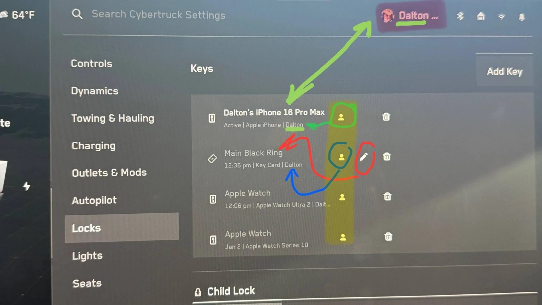

Let me see if I can try to make this a little bit simpler. What I have highlighted in pink at the top of the screen does two things: (1) it tells you which profile is active in the vehicle and (2) allows you to select between profiles (you’ll get a drop-down menu if you tap on it). [I think you already know this much.]
Then, for every key, phone or fob you have connected to your vehicle they will be listed under the “Locks” menu and each one has a small silhouette of a human next to it. I have highlighted all of those in yellow. [This is the step I believe you’re missing.]
While the profile that you want to bind is active at the top of the screen you need to push the silhouette icon next to the key or phone or fob that you want bound to that profile. That can only be done from the locks menu not the profile select button at the top of the screen.
Is this making sense?

She does but it’s not relevant. You can create as many profiles as you want and bind them to phones keys or whatever.
So, for example, you could create a profile for “entry” and bind that to a particular key. You could create one called “guest” and bind that to a particular key, or fob. You could create one called “hag”, set up your mother-in-law as a driver with her phone and bind her phone to that profile. 😏 These are independent functions from whether somebody has a Tesla account or not.
So, what I’m telling him will work just fine if he carefully follows my instructions.
The fact that they are sharing a Tesla account is not the determining factor. What you’re thinking is happening would only be happening if they were sharing the same phone. Since each of the phones will register as different devices and should (presuming that they have named the phones) show up on the screen as “husband‘s phone” and “wife’s phone”, it’s just a matter of binding the right profile to the right phone as outlined above.
The connection that matters is device to profile highlighted in this lighter color green.
Tesla Cybertruck LINKING DRIVER PROFILE TO A KEY (PHONE) IMG_2846
Just because it says “Dalton’s iPhone” doesn’t mean that it’s bound with Dalton’s driver profile. I could just as easily have my iPhone 16 bound to any other driver profile that’s in my vehicle by, tapping on my face up there, selecting a different profile, and then tapping the icon highlighted in yellow next to my device and it would change to that profile. That’s the process that OP will go through when he’s ready to set up his wife’s phone and he’ll have to remember it’s going to bind to the profile that’s active at the time you hit that icon so you must have her phone linked to her driver profile and vice versa.
Again you’ll know that you got it right because it will tell you beneath and to the right of the device, what profile is bound to it (where I have underlined Dalton in light green). If it remains unbound nothing will be there.
