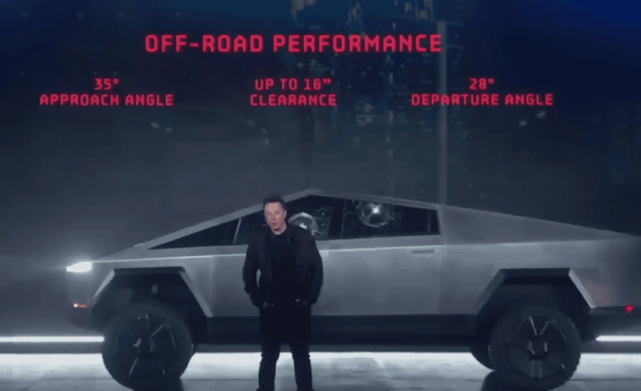

I recall 16" ground clearance
And vaguely recall 8" at its lowest

When the unveiling happened the lowest ground clearance was 8” and the highest was 16” (12” plus or minus 4”), but no one has heard anything since.

At 2019 CT unveil it purported a max clearance of up to 16” on stock 36” tires (we assume). So the CT’s extra 4” of max height would come roughly 2” from suspension, and 2” from the tire size.
