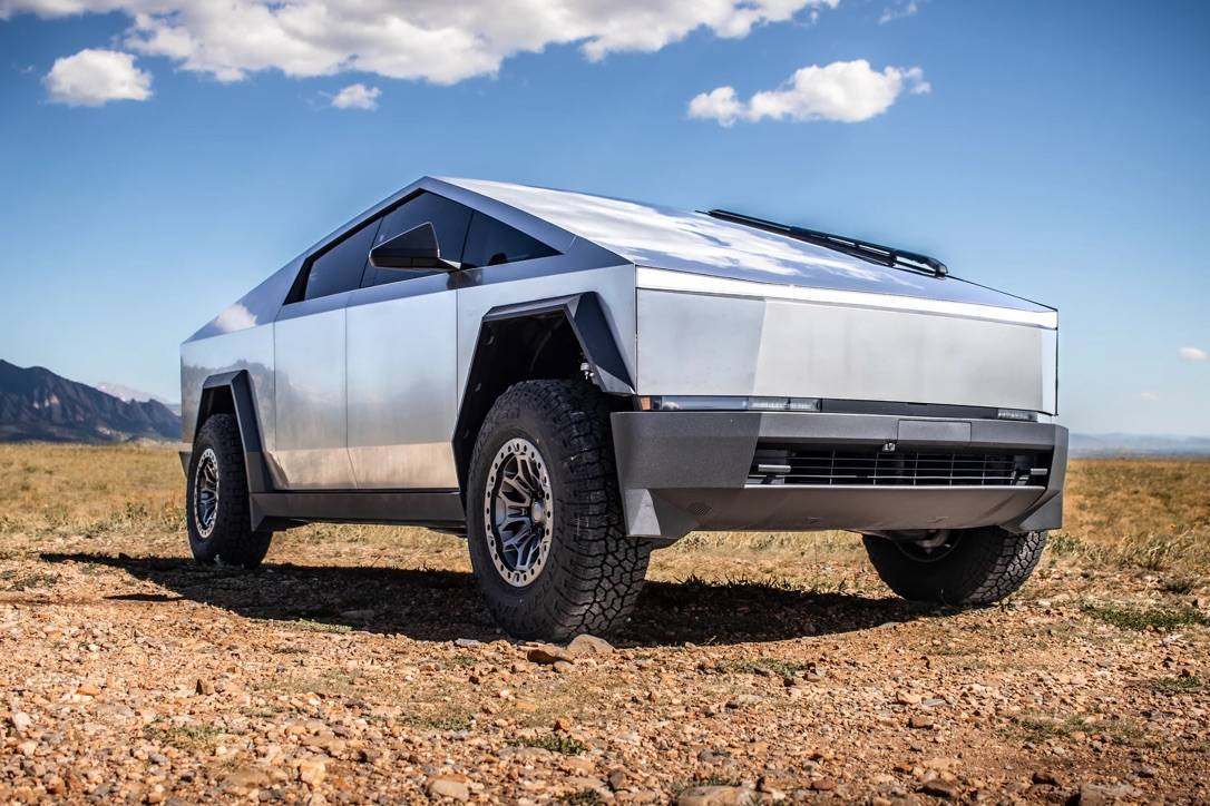

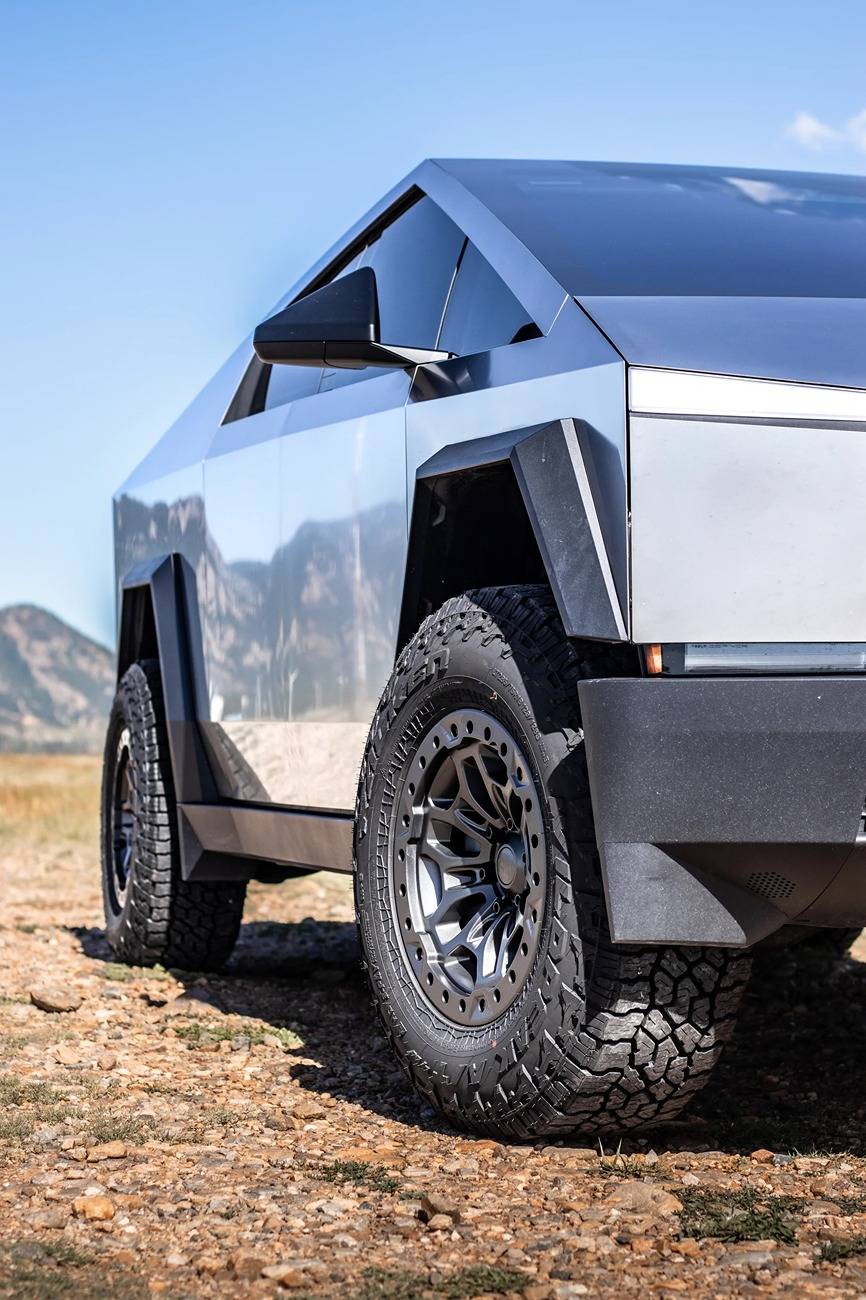

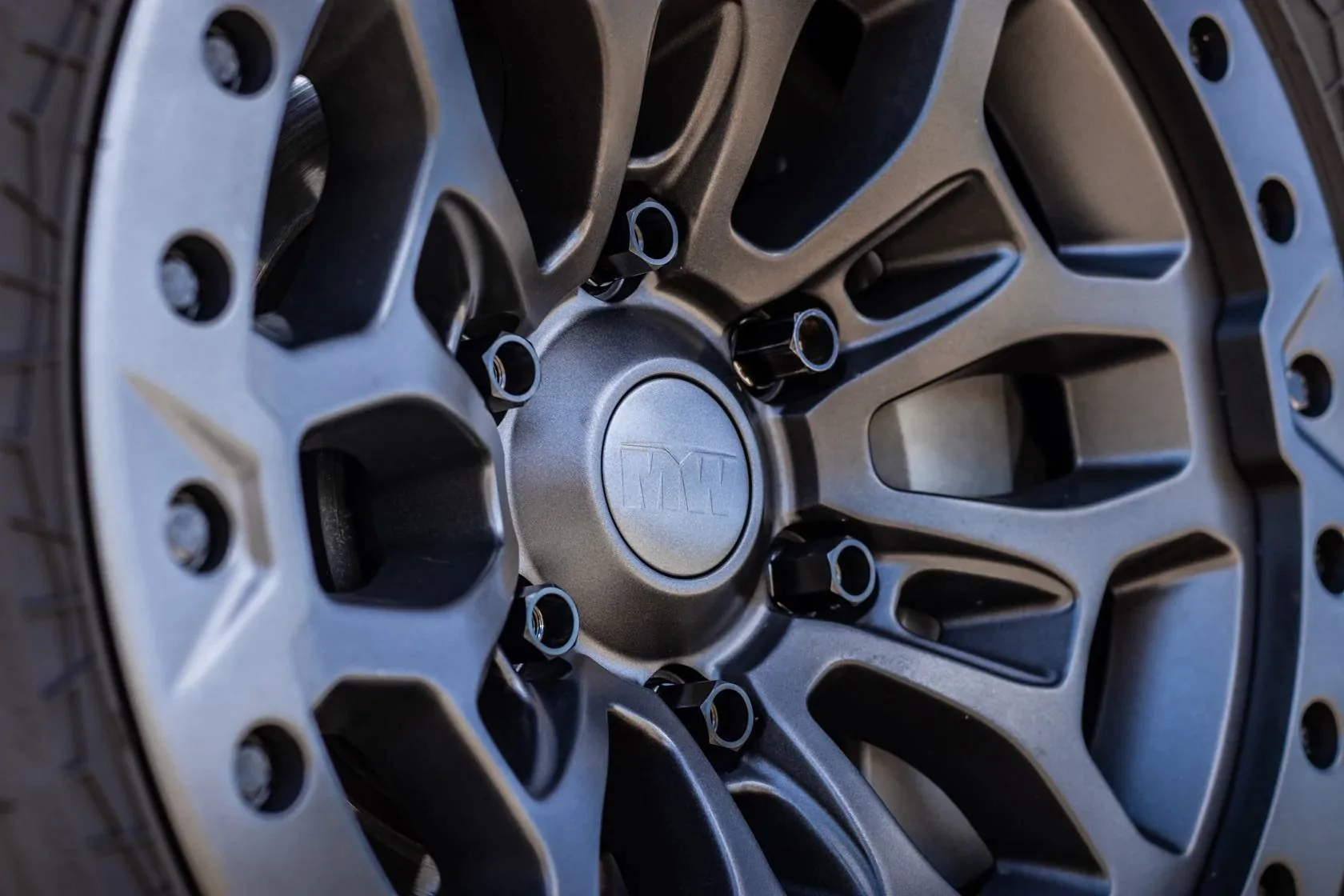

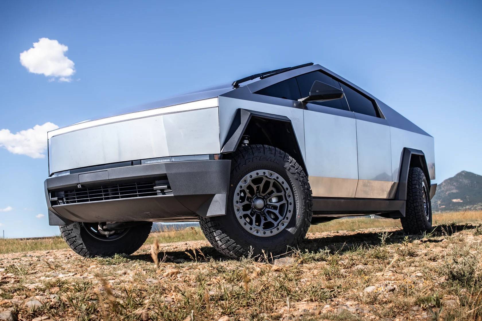

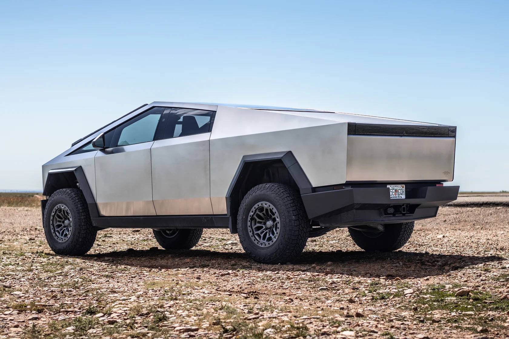

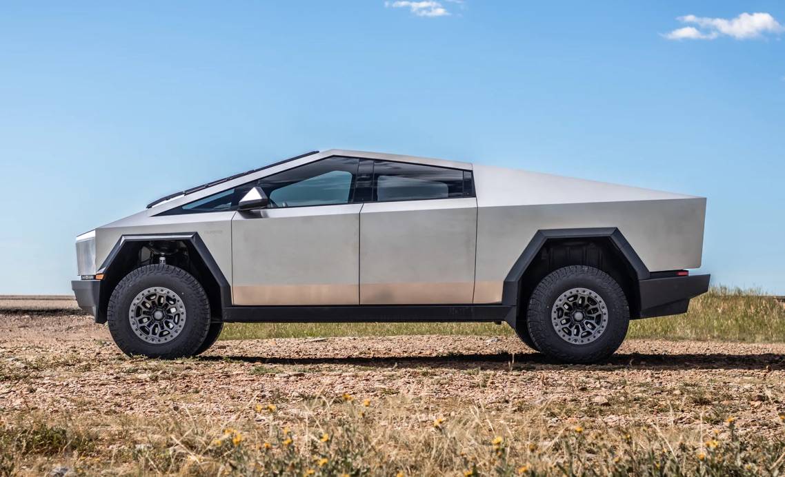

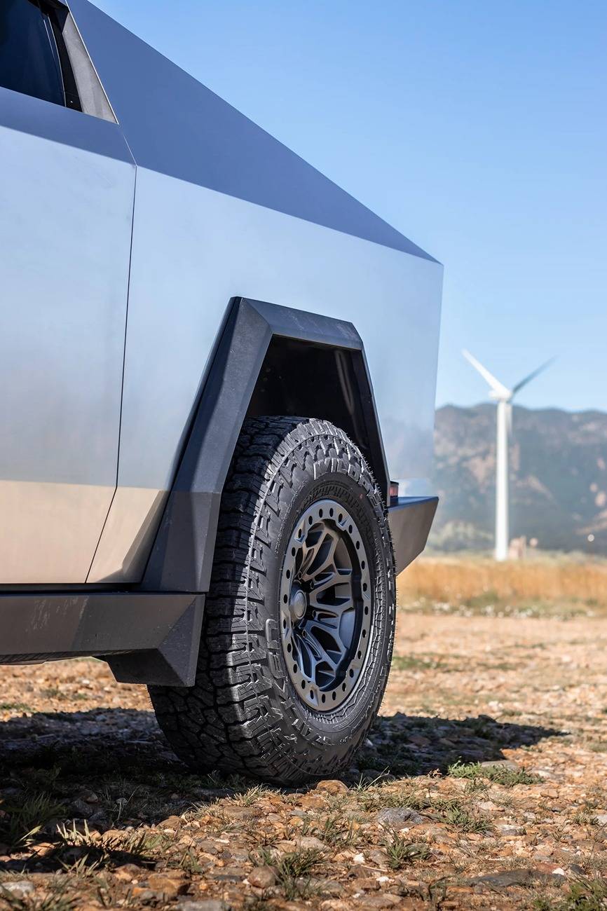

Hey guys. new to the board. Just picked up my Cyberbeast. Right out of the gate, i knew when i configured the truck i wasnt happy with the tire/wheel options from Tesla. Ive always loved the Black Rhino beadlock wheel look. I think ive found the best option for me. I just ordered a set of these new wheels from Martian Wheels made specifically for the Cybertruck. They have a +40mm offset to give them a more aggressive stance.
I am going to go with the Nitto Recon Grappler (305/70 r18). im hopeful that i dont have any fit issues with the offset, but i do have a set of .75" spacers that i may potentially add to push them out more but im undecided on that. The new tires are just a hair over 12" wide so i can't imagine it's going to be an issue.
You can get the 20" version and use your stock tire, I was just never a fan of the the way the stock A/T looked withe the weird design to fit the aerocovers. And i like the look of more tire, less wheel you get with the 18". I went with this gunmetal color. Ill report back once i get them all slapped on there in a few weeks.

I wouldn't recommend too much over 295 on tire width unless you go with a much smaller offset, like 18mm on most methods.
i just went back and watched the video by out of spec Reviews on youtube, where he speaks with the guy that made these wheels and he specifically said that he made the wheel to stick out more. the photos look the same. so i really think that the offset is actually -40 vs. +40 moving it closer in. i have left a message with them to confirm. with a -40 i think the 305 size should be a perfect fit.

Assuming all things are equal that I don't know about, +58.5ET to +40 with a 20mm width increase and a 2mm sidewall height increase (4mm total height) leaves you at
20mm/2 - (58.5mm - 40mm) + 2mm = -6.5mm on the inside arc. Yeah you should be ok 👍🏼 you'll have more poke, but it'll be necessary.
