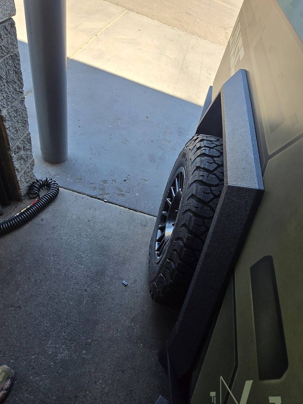

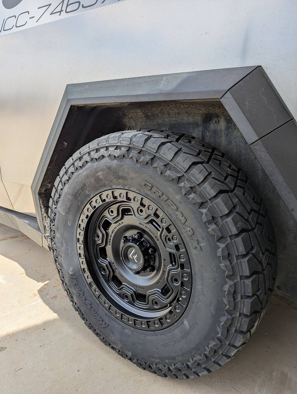

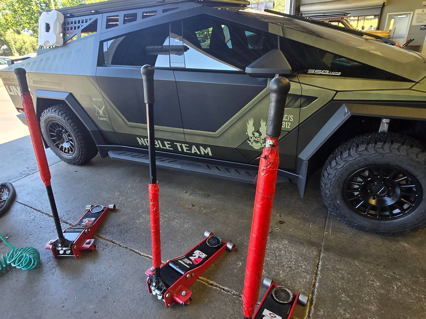

I've got to say, I'm glad I stayed OG and went with the MR707's.
MR707 wheels - 18x9 139.7 18"
KO3 tires - LT275/70 R18
Tesla Cybertruck Method MR707 18" wheels with KO3 tires installed 20250501_123423
Tesla Cybertruck Method MR707 18" wheels with KO3 tires installed 20250501_123410
Tesla Cybertruck Method MR707 18" wheels with KO3 tires installed 20250501_123349

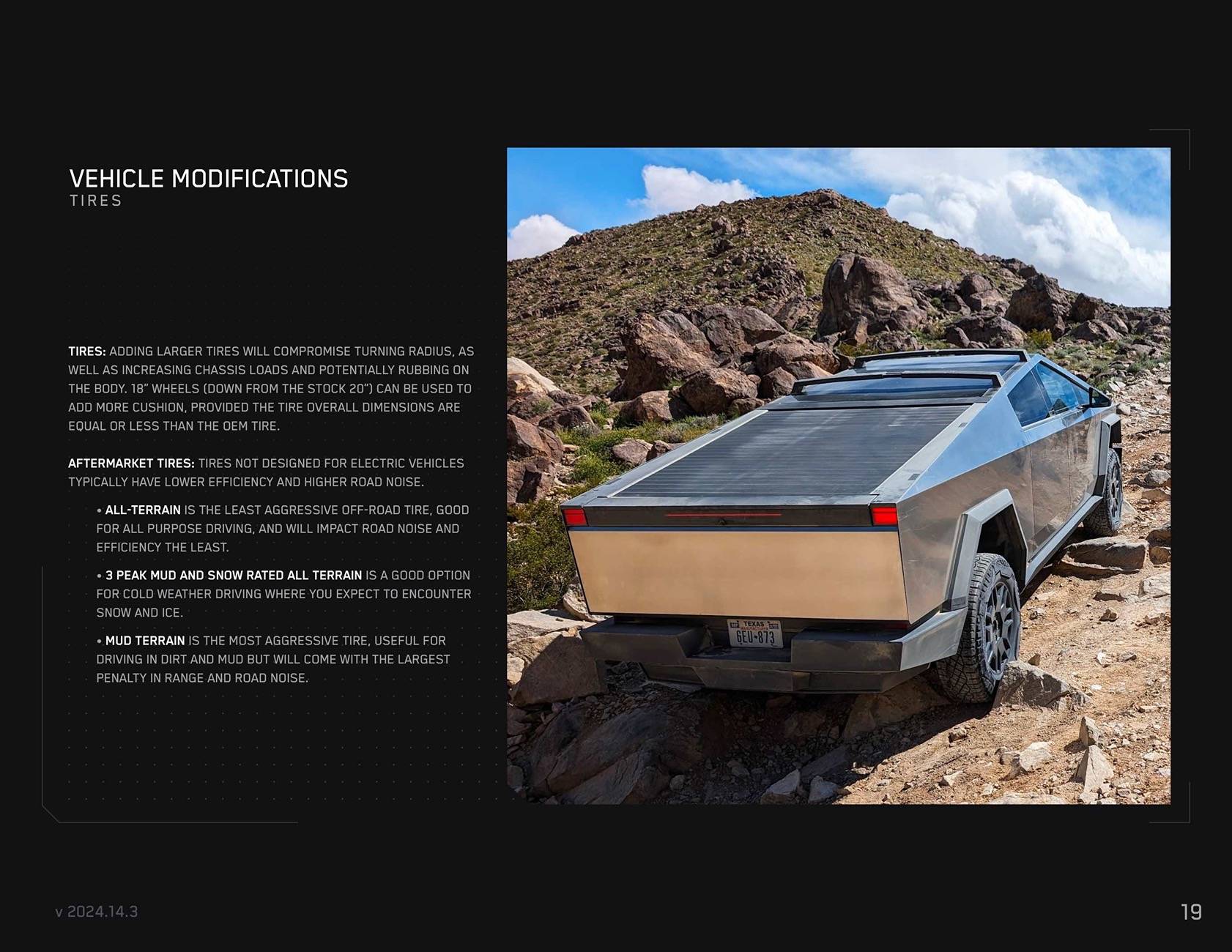

The CT is designed for 18s, it's in their off-road handbook. So any 18 inch wheel will fit, just gotta watch weight rating.

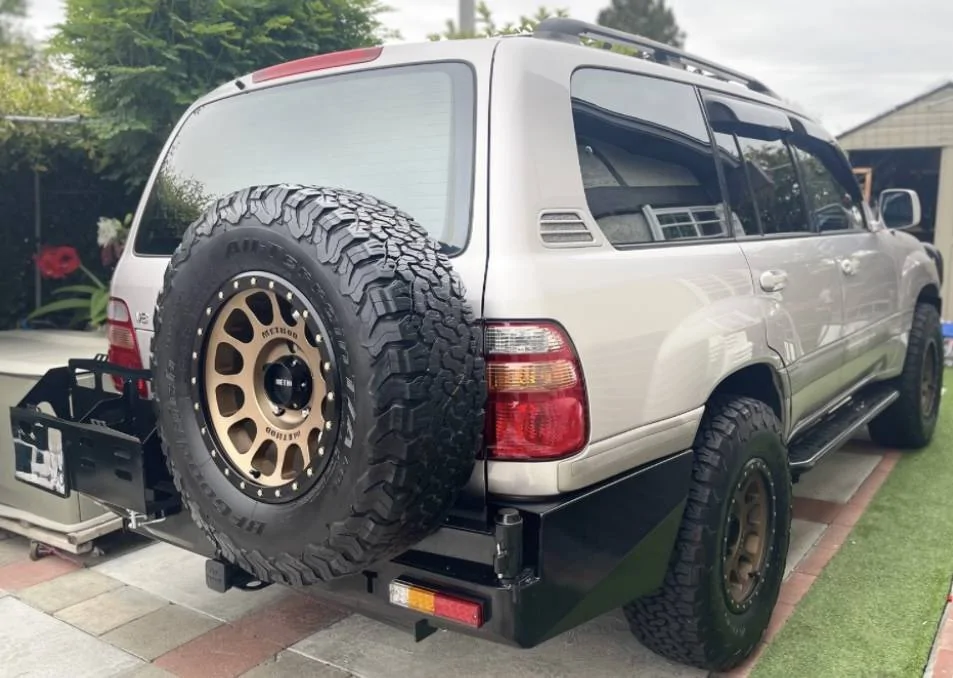

I am well aware of Method wheels. Have Method 305s wrapped in KO2s on an LC100.
Tesla Cybertruck Method MR707 18" wheels with KO3 tires installed IMG_6702
I was just wondering if it was just personal preference or was there a reasoning to the tire size since it is very close to what some aftermarket wheel companies recommend.

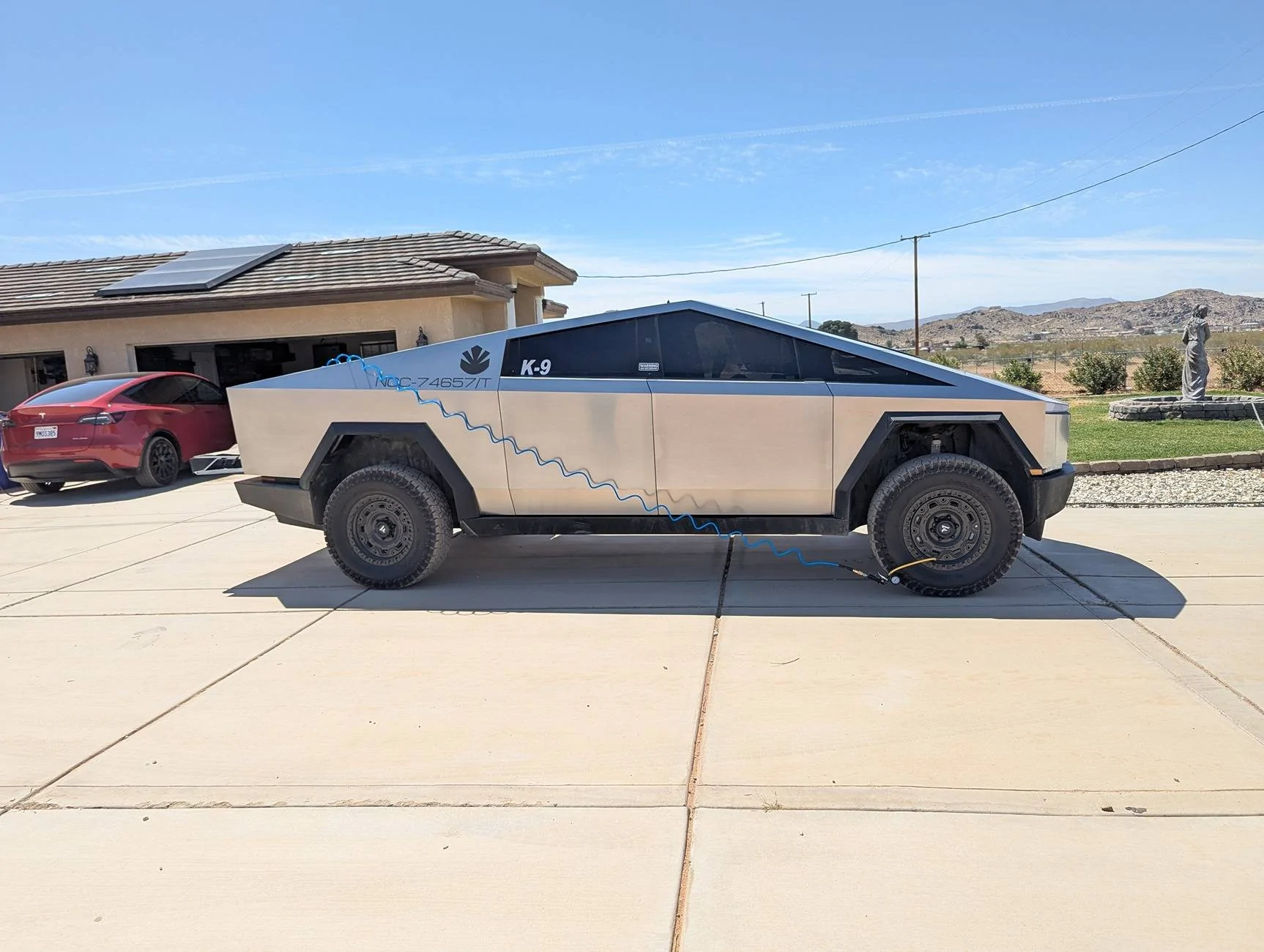

Oh, you meant poke? I'm using 12.5" width and +18mm, so some poke, but I've never clipped a curb and I run FSD everywhere. Probably about 2k miles on this setup

That's actually one of the things I tested, and honestly, that inch and a half didn’t make much of a difference—it was pretty much the same.
