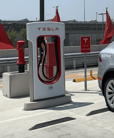

They suggested the adaptors would be available at the Supercharger stations. Iā€™d love to see how they do dual chargers in Europe.
As I said in an earlier post I don't believe adapters will be able to carry the current the V3 and later chargers will be able to handle. Therefore I think adapters will be an interim solution until chargers like these get installed or existing ones get retrofitted.

In Europe they use the same connector, so no adapter needed.
There are a fair number of Teslas in Europe with the older SC connector so the Superchargers there have 2 ends (which is the picture ajde posted).
127
16,660
27,746
Yes, older Tesla cars and chargers. But the chargers already have switched connectors, so...
...No adapter needed.
