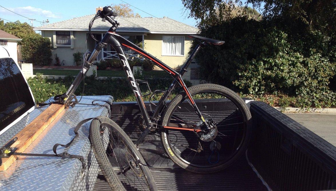

I've been looking into this also for our 2 E-Bikes. I'm thinking we'll make a removable mount on a 2x4 like this photo, and cut the 2x4 to the length of the width of the bed. Mounting the bikes with the back tires against the cab with the bikes strapped tight to the cab. I might have to remove the seats, and lock them and the front tires elsewhere. Maybe have the bikes locked to the tie down points near the cab. It seems like the vault cover can be stopped anywhere in its range. So if I can't close it all the way. I'd have it as close to closed as possible. Here's a photo that shows a removable rack like I'm describing.

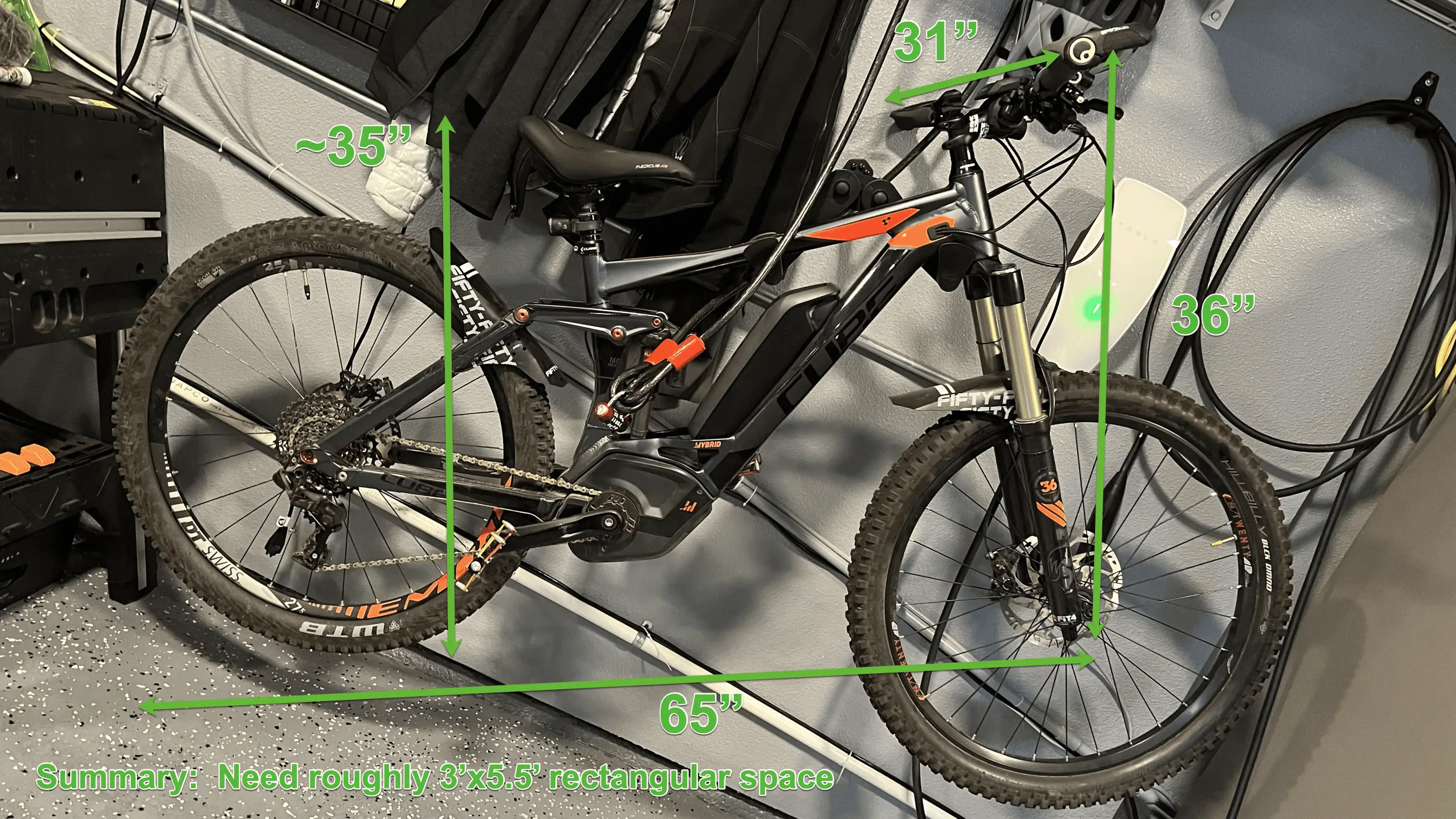

There was very little on the web about dimensions of an eMTB with the front wheel off, (and even ChatGPT gave me the wrong answer :rolleyes:), so I went and measured it myself.
  • To my surprise, the front and back (after taking the front wheel off) are pretty close to the same height.
  • We need a space roughly 36"x65". (medium size frame)
  • The cybertruck bed starts out taller at end of the and decreases as it goes back, which might be a problem.

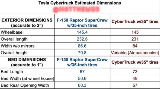

  • If the measurements from the above post are correct, the bed is long enough to store the bike in terms of length (72"). bike = 65.
  • You could not turn the bike sideways and push it to the back near the cab (57" wide max point). bike = 65
  • Also the width is a little problematic. Truck is 57", but two bikes side by side are 62". So they would have to overlap a bit. This might not be a problem, but it could result in scraping around the shifters and motor control areas.
  • The bikes could either be stored right-side up (fork-down), or upside-down (fork-up). Harder to attach to the bed securely if the latter. And this would affect overall height, so probably better to do fork-down and mount to a 2x4 or metal rail.
  • Looking at the other photo I posted above, the ATV sitting in the bed probably has ~25" wheels on it. So a quick guess is that when the cover closes, there is maybe 27" of height inside at the back (and that was probably before the 5% reduction), so maybe 25" now. We need 36" for the bike, and it will extend pretty far back towards the tailgate.
Summary: The bed is not huge, and the one measurement that we really need is "bed height with cover closed", which doesn't appear to have been disclosed yet. I personally think it will be a very tight fit, and probably won't work in any configuration. It doesn't really appear to have been built with secure bike-storage in mind.

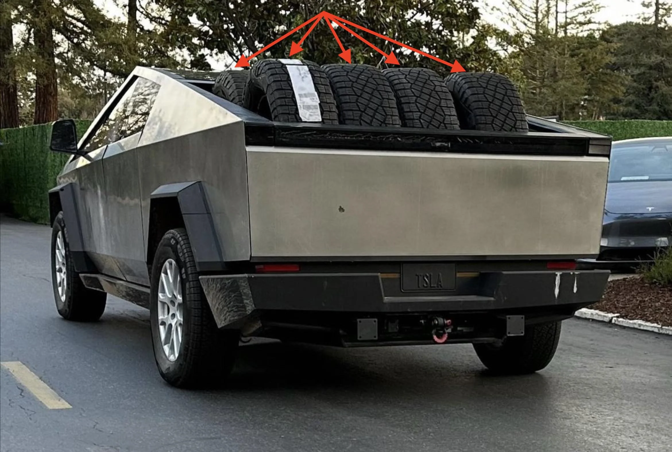

This is the photo that told me it will be difficult to put 2 E-bikes in the vault with the cover closed.
Edit: I went and grabbed this photo while you were posting your comment Axup.

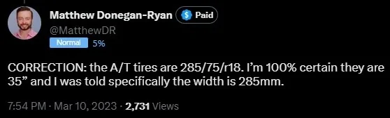

Another way of eyeballing this:
The cybertruck tires are 35". Try visualizing two of those next to each other (one in front and one behind it) pushed up against the back of the cab.
That is very roughly the size of the bike with the wheel off.
Probably not going to fit.
And worse, 285/65R18 is considered a 33" tire even though it's only 32.6"
https://tiresizescalculator.com/285...t=How big is a 285,when inflated with no load.
UPDATE: 35" (34.8")
https://tiresizescalculator.com/285-75r18-in-inches/
