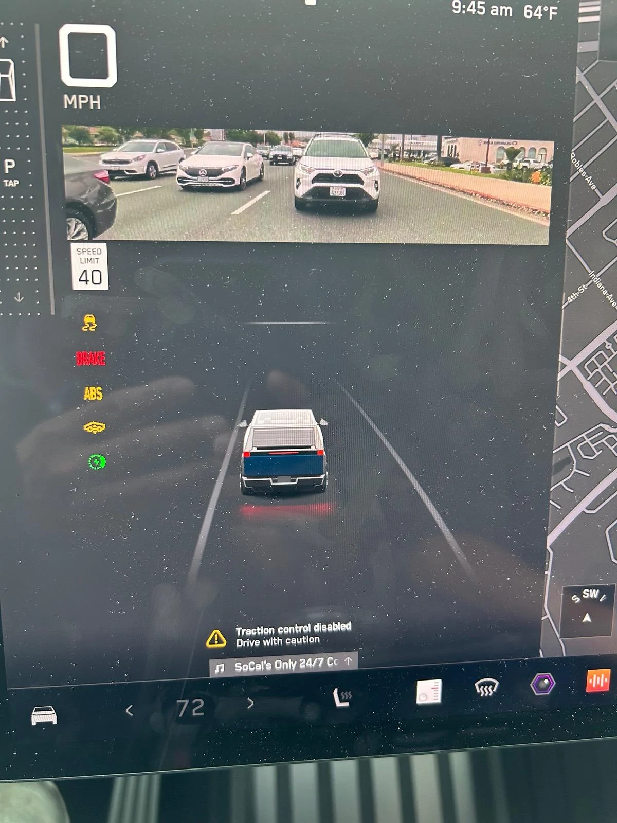

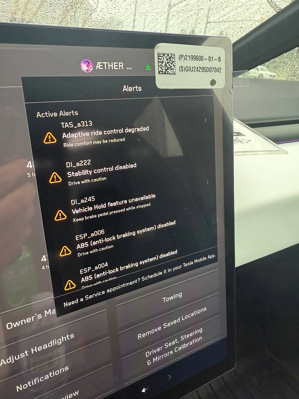

My CT has had this issue 4 separate times. I get in and put it in drive and notice that brake hold doesn’t work, and all my warning lights are on (traction control, abs, brake, cruise control, and adaptive ride control) The first time this happened, i called Tesla and they had me try a few things inside the car but nothing worked. Set up a schedule to come in but since the car was drivable, I went to work. When I came out, everything worked fine. I figured it was just one of those things. The problem is, it’s happening more often. It’s happened four separate times and every time, I just go to my destination and park and it fixes itself in a couple of hours. Anyone experience this?

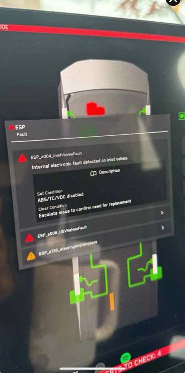

Yes, I have a similar problem with adaptive ride control. Got red alarm on it in first couple of miles after delivery. Indicates a pin or short problem to drivers front strut. Some times it clears but always came back. CT in shop at Grand Rapids last Thursday, still waiting to hear when It might be ready to pick up. This error limited speed to 91 miles per hour but other than didn’t find anything else not working as a result of this error.
